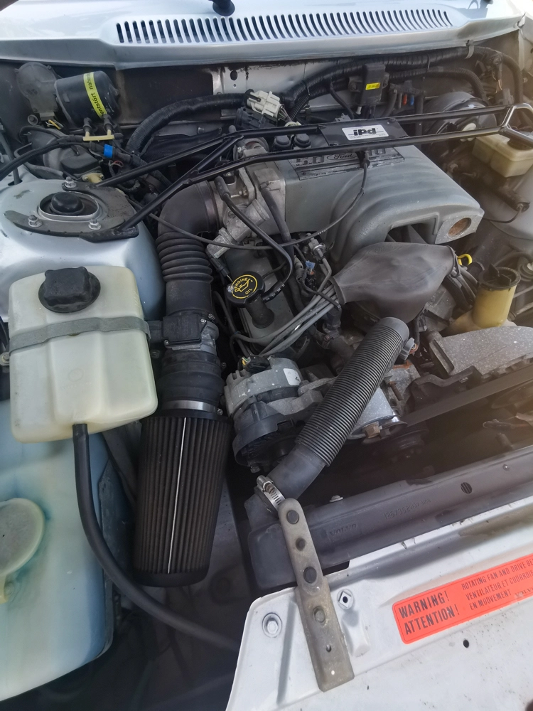

I have a 1989 5.0L H.O. and T-5 swapped into a 1981 Volvo 240 sedan. The engine is pretty much stock. The owner installed a "high rise" lower intake manifold will the O.E. upper plenum (haven't been able to find what brand it is as most aftermarket lower intake manifolds won't accept the O.E.)

Not sure what you mean by high rise intake (maybe it has an intake spacer?.
If it's fuel injected you will want a new intake to go with the heads regardless.
The heads are the only real engine mod that will take significant weight off the engine.

Yeah, it's a 1989 5.0 H.O. with EFI. I don't know what was done... he said "high rise intake". It could just be a spacer or a product that's no longer available. The swap was done in 2000. I'm still waiting for the car to be delivered so I have done an inspection. This week!!!

That's just a stock intake. Hard to to tell, but at most it has a small spacer.

perhaps there is some terminology lost in translation. The “lower intake” was changed AFAIK... it could be a spacer, or a product that’s no longer offered. This was done 20 years ago.
I’ll get the car and paperwork in hand when it finally get to my driveway. The “upper intake”, or “intake plenum” is the stock one with a larger throttlebody.
Well, I got my hand on it finally. Yeah, it's the OE lower intake. Old Rick was confused about the fuel injection system of the 5.0L. He said it was "throttle body injection with a high rise intake". No biggy, he's just old school.
