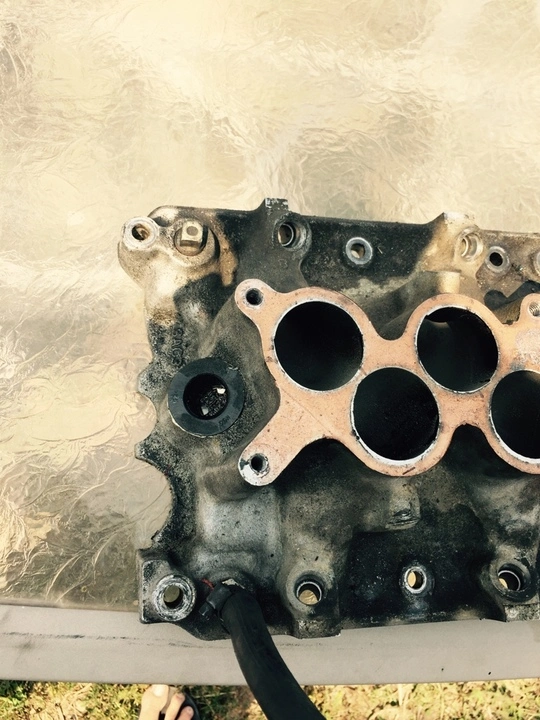

Doing away with the Pcv system on the wife's SC 93 fox. Going to weld in -12 fittings in the valve covers and run braided lines to breather tank. When I pulled off the intake today (had oil leak I wanted to doc) noticed another Pcv that I didn't know about in the middle back of the lower intake. Not sure the best way to plug this one. Any ideas? Can't edit title. Not putting a pvc plug in. Looking for to plug the pcv. Lol.

The valve covers shouldn't have PCV valves on a fuel injected car. Stock are blanked off. That location at the rear of the intake is the only PCV valve.
SHort of a custom plug, best way would be stick a PCV in and then plug the vacuum line. Other than that, they sell rubber plugs that you can try to match up and block that port off. Unfortunately, due to the size, it won't be "clean" so to speak.
