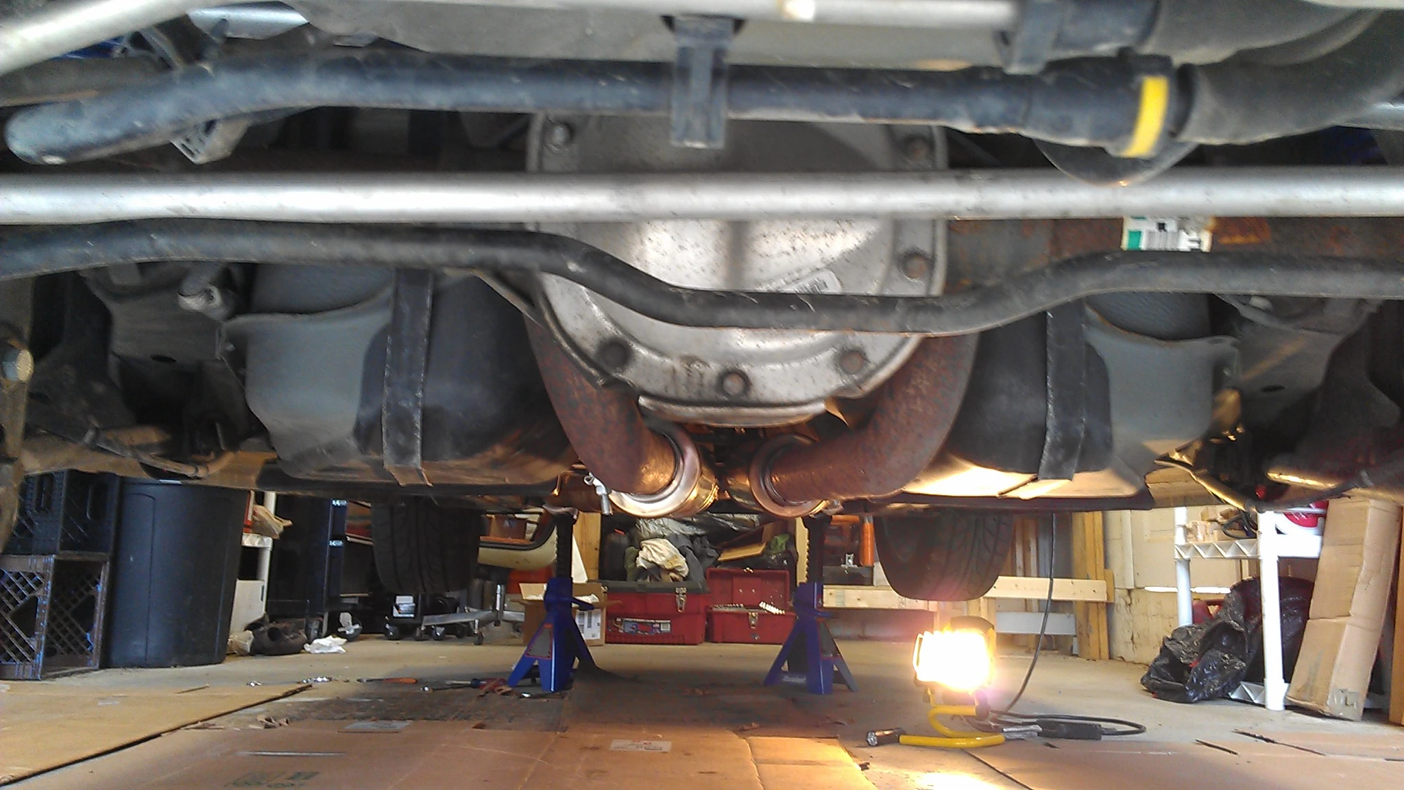

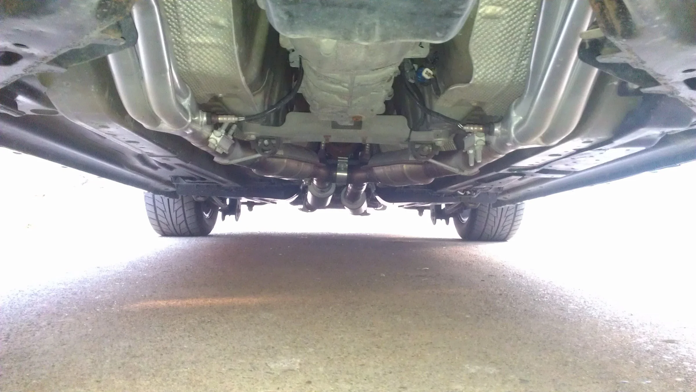

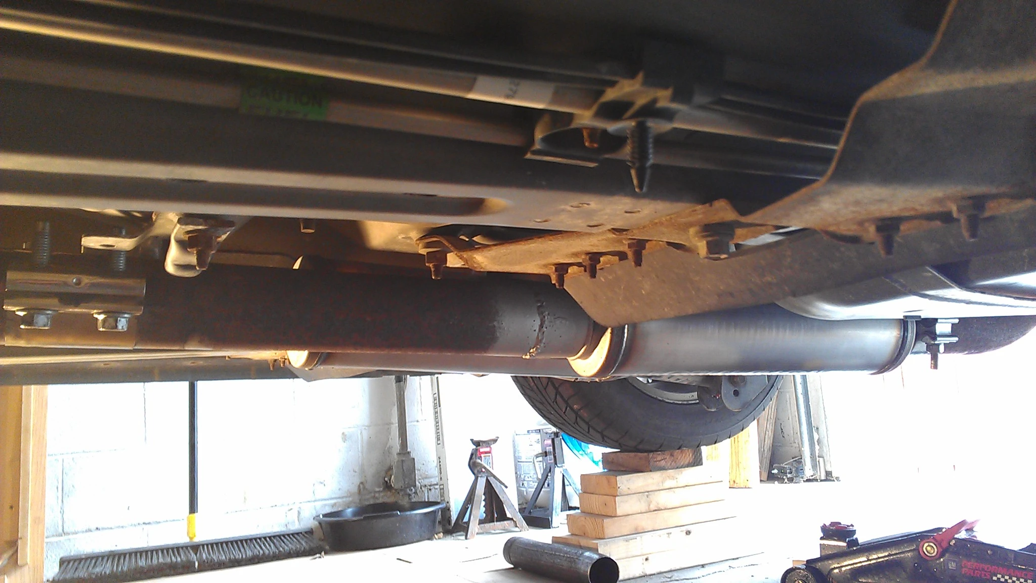

On my car I have longtubes, o/r H pipe, round case Magnaflow mufflers as resonators, and a Ford Racing Touring axle back (they're Borla Touring mufflers, I don't think they make it anymore, I found it used). At low RPM's it's really not too bad, at WOT it screams and even with the resonators it still trumpets a bit. It's hard to find a good middle of the road sound. One good thing about this setup is that it doesn't drone, I used to have chambered mufflers with cats and the same resonators and it droned terrible and was just as loud as this setup.
I put them back just before the axle. On the factory pipes there are two sections in different spots that are mostly straight, and it just so happened were just the right length for the mufflers, so I cut those sections out and put the mufflers in, so they are staggered. I was able to tuck them up a bit and haven't had any problems with them hitting the ground even with my car lowered.
So, they look like this (this was back when I still had cats on the car)
