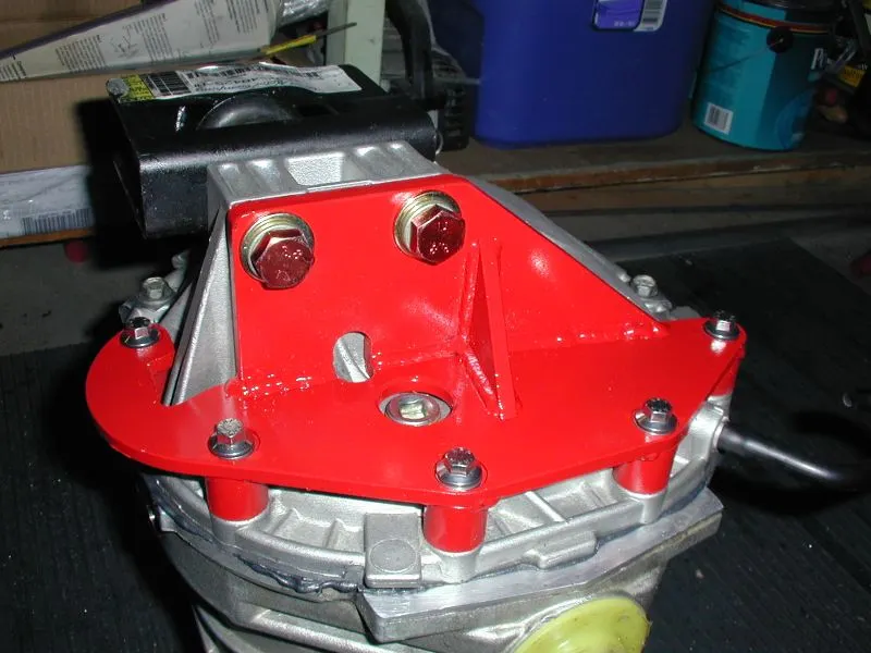

Yeah, it is supposed to be safe to jack on the pumpkin with IRS according to the information I have found. Best to have an IRS diff brace though... I will be installing one soon.
