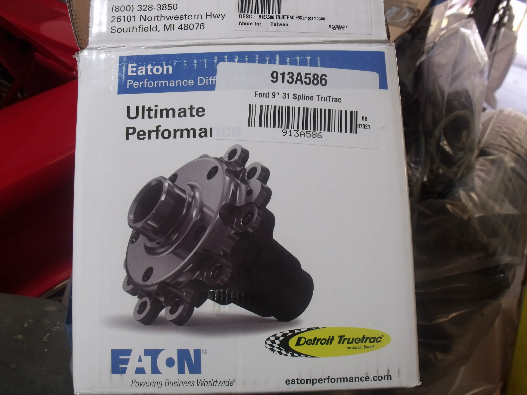

The diff in my 2000 is toast. No harm in leaving it but I plan on doing a stock rebuild with the M-4700-B kit. For my Fox i plan on doing the M-4700-C kit
Reactions: limp
I am going to try out one of these... Not on the road yet...
