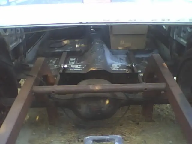

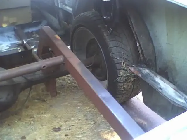

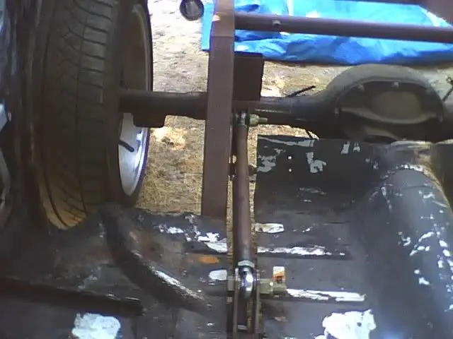

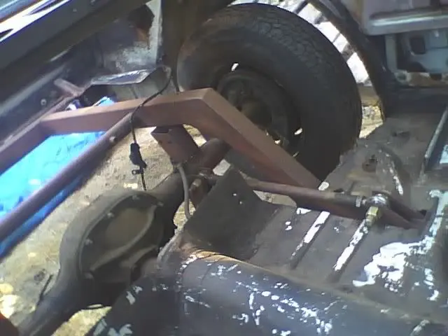

I have a 65 mustang with a stock 8 inch rearend, i believe it is 57 and 1/4 inches wide... Now i have a set of rims that are 17x10 with a +20mm offset. I have already removed the inner wheel well so i will have no interference there. my question is will i have to narrow the rear for these tires to sit inside the quarters. thanks Nick
Your problem will more then likely be the tire/wheel hitting the leaf spring. Below are a couple pics of me trying to stuff 275 drag radials under my '65 -these were on 15x8 rims with a 4.75" BS. Notice the tire itself is hitting the leaf spring and is sticking out past the fendor. A 17x10 is a big wheel, and I think the only way it will really work for you is if you flare your fendors or change your suspension.
I see by the photo, in link below, that your car's 8-inch rear has the old style weaker '62-'66 8-inch 3rd member, as evidenced by the lack of additional ribs you would find on the face of the '67-'80 model 8-inch 3rd members.
http://i51.photobucket.com/albums/f400/nicktomstew/untitled4.jpg
Having that much tire [surface area] in contact with the pavement with that 3rd member stands a good chance of tearing the driving pinion out of the case.
If you don't install an 9-inch, I would at least suggest installing the stronger C70W-style 8-inch 3rd member in the rear end you have.
