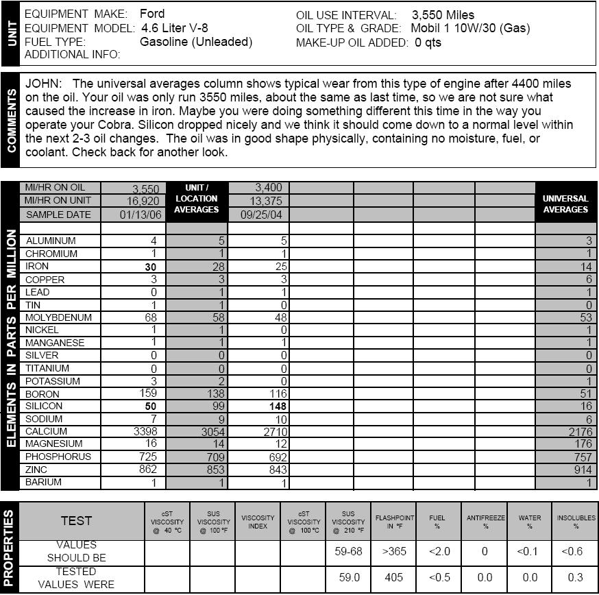

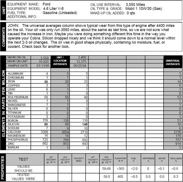

I end up changing my oil somewhere between 2500-3500 which truthfully is defeating the purpose for using a synthetic motor oil in the first place. The main reason for switching to a synthetic is its ability to go longer between changes. If you really want to do it right head on over to http://www.blackstone-labs.com/ and request an oil sampling kit from them. Next time you change your oil grab a sample and send it into them. Their kit contains everything you need to catch a clean mid-stream sample... kind of like a urinalysis now that I think about it. :scratch:
Pay a little extra for the TBN testing when you send the sample in. TBN's are the additives in motor oil that keep the engine clean and help keep the viscosity where it should be... amongst a host of other things. Blackstone Labs will send you a detailed report back on your oil telling you everything they find. They will also tell you the condition of the TBN's and whether you can push your car farther between oil changes. They will also suggest oil change intervals based on the test results. (Remember, even though you go 5, 6, or even 10K between changes you'll still want to replace the oil filter and top the oil off every 3K).
I've sent a sample in to them the last two times I changed the oil in my Cobra. I don't ask for the extra TBN test though, I just like to keep an eye on the different levels of iron or silicon in my oil. Here is the report from my last oil sample. As you can see they have alerted me to an increase in the iron content they found. Not a significant increase mind you, but one to keep an eye on.
