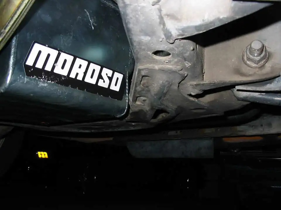

I may have to get one and check it then. It looks fine, the only reason I want to mess with it, is to get a little more clearance between my oil pan and the K member.
Thanks
Put spacers between the engine block and mounts if needed to gain a little clearance ;)
Not sure that will help me.

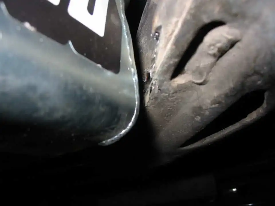

I took a stab at it with my cutoff wheel. Amazingly I didn't hit the pan (amazingly b/c my hands normally shake like a crackhead when I am doing sensitive stuff). It might be hard to make out, but I was able to section either end of the lip on the K, and then I pushed it back with my hammer and punch.
It doesn't look like much, but it has a LOT more room now then what it did.
