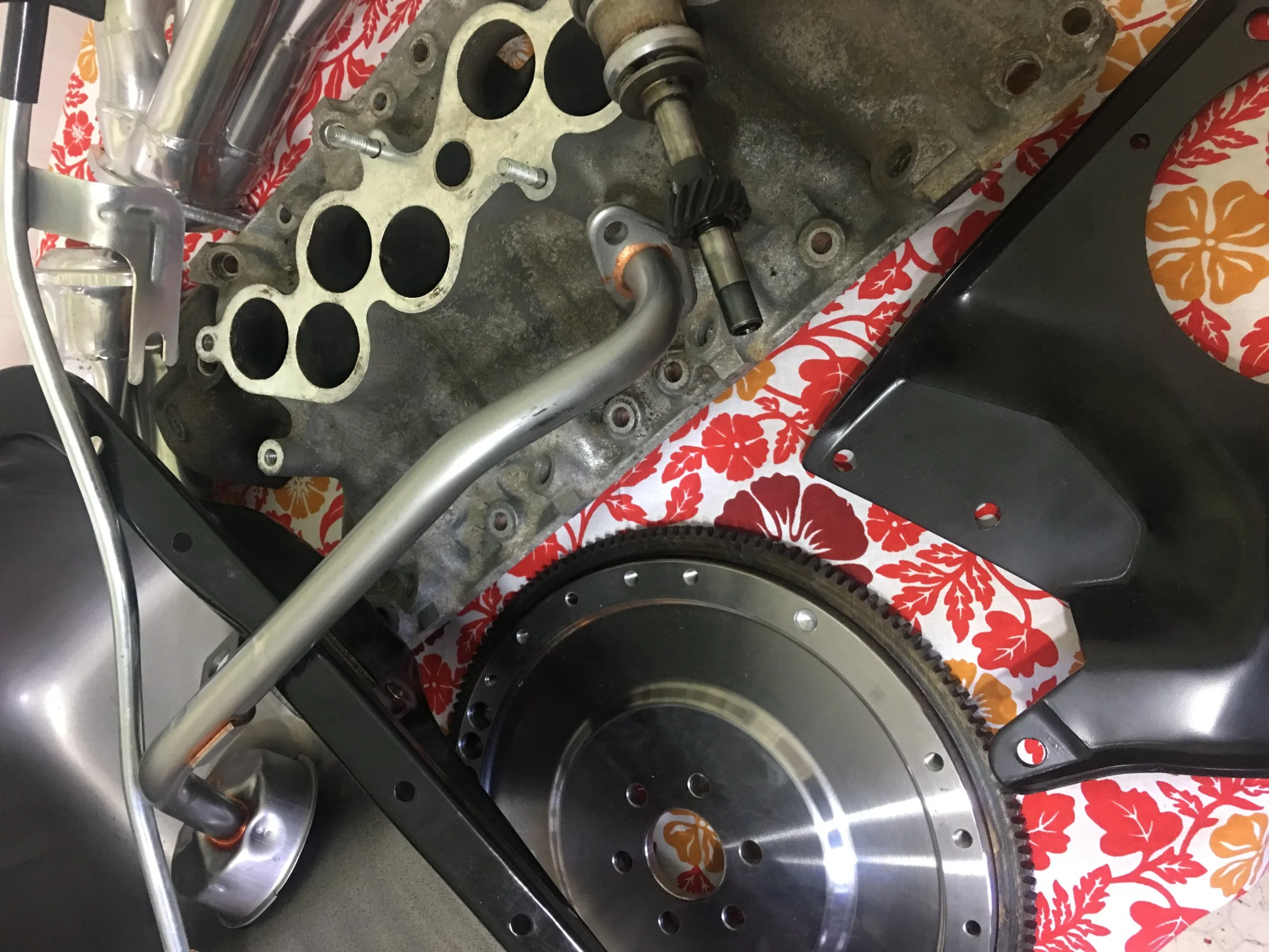

It’s gonna cost you about a g for all the swap parts to do the swap. Flywheel, accessory bracket, headers, intake, oil pan. Unless you’re resourceful. I bought them all new. Just gotta get the motor built up.
Yeah I figured it’s gonna cost me a little bit of $$ but I plan on slowly doing the build on the motor and try to be resourceful as much as I can! But... it’s going to be sweet when it’s finsihed!
