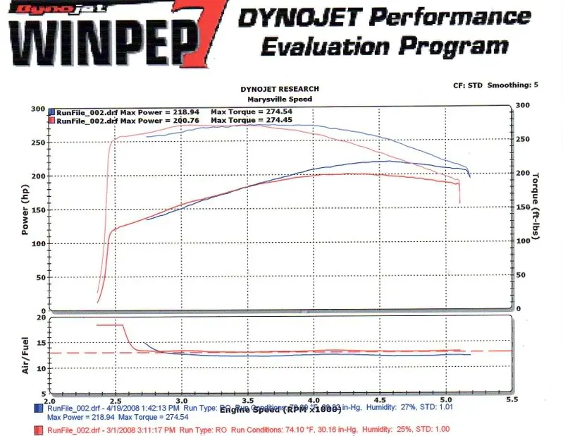

BTW, a friend of mine has a 88 Saleen with exactly the same few mods you do and had it on the dyno Saturday where it made 219 rwhp and 275 rwt. Compared to that, my bone stock 93 Saleen put down 200 rwhp and 275 rwt. Here's a dyno sheet with the two runs overlaid.
interesting, I had a customer take an SD car and convert it to MAF - no other changes - and the results were similar. The MAF was better down low but made less upper rpm power than the SD.
