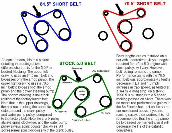

You dont need a plug, search on stangnet, ive found the size plug but i dont remember what it is but you can get them at autozone. And For the belt, youll need to find the right size, it may take a few trips, but tell them you need a belt for a 90 mustang 5.0 but its not the stock size, theyll ask you what size and buy as many as you can with the money you have and return the ones that dont fit.
Id buy the 84.5 and the next few up from that, and just go from there it may take an hour of going back and forth but youll find the right one eventually.

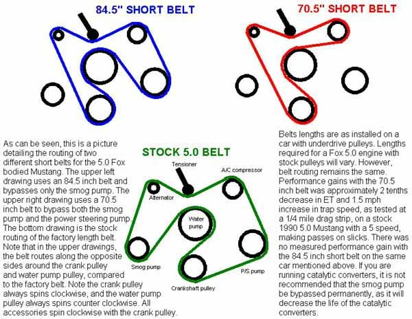

ok i have underdrive pulleys and no smog pump and i want to bypass my ac what size belt do i need?
