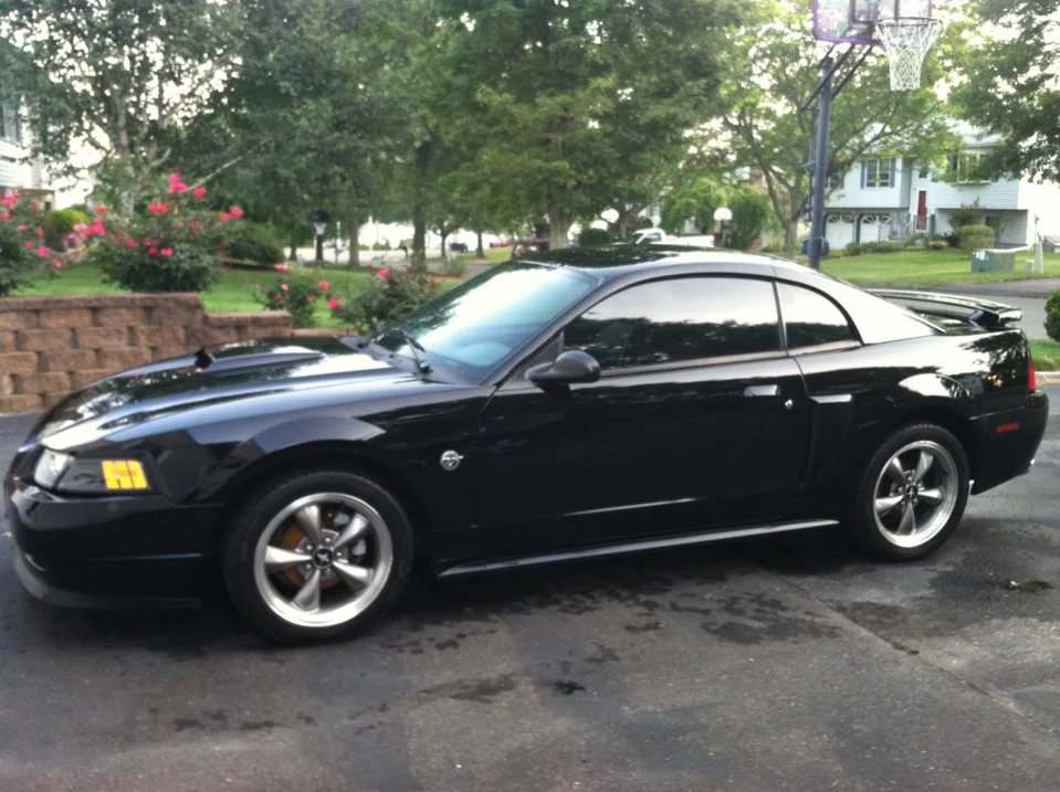

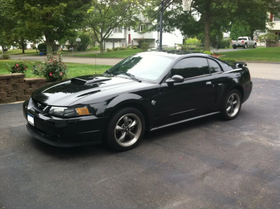

) I have succeeded in my original goal (as stated in the top post). I ended up with the Ford Racing B Springs and Monroe Sensa-Trac shocks. I am happy with the drop. Just about 1-1/4 in front and just shy of an inch in the rear. This is slightly more than the 1-1/8 and .75 they were listed as, but just fine with me. The slight rake looks good in my opinion but the top of the wheel well is exactly the same height off the ground.
