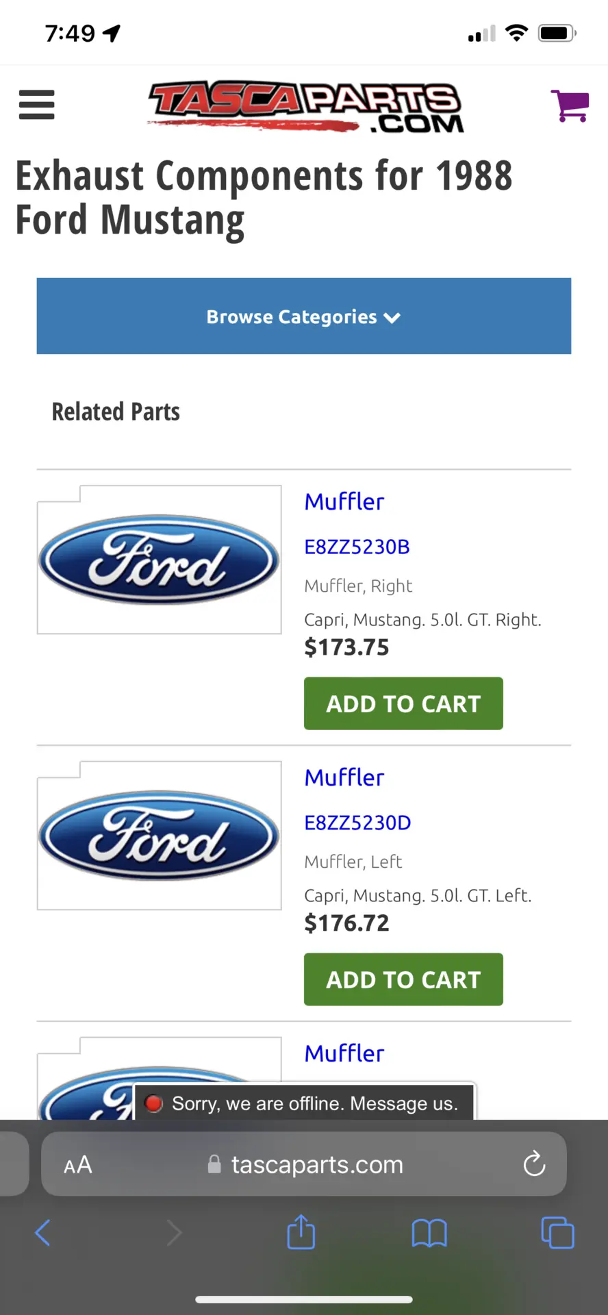

Anyone want to roll the dice and see if two OEM mufflers show up?

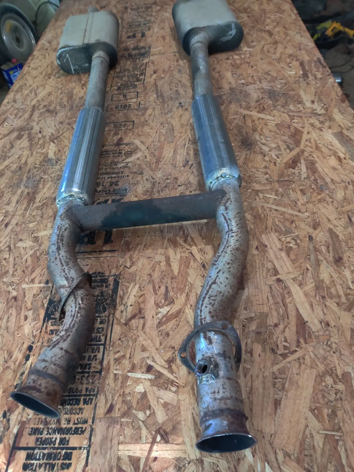

+1 on resonators to start if you like the sound but just want to quiet it down. I did this on my II a couple years ago and it made it much more tolerable. My suggestion would be to get the longest glass pack style muffler you can fit into the space of your existing pipe's straightest location. For example, here's what my exhaust looks like out of the car.
This would probably be about the cheapest route. I'd give this a shot before dropping a lot more on different mufflers that you're not 100% sure would give you what you want. Good luck!
