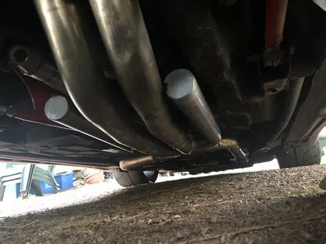

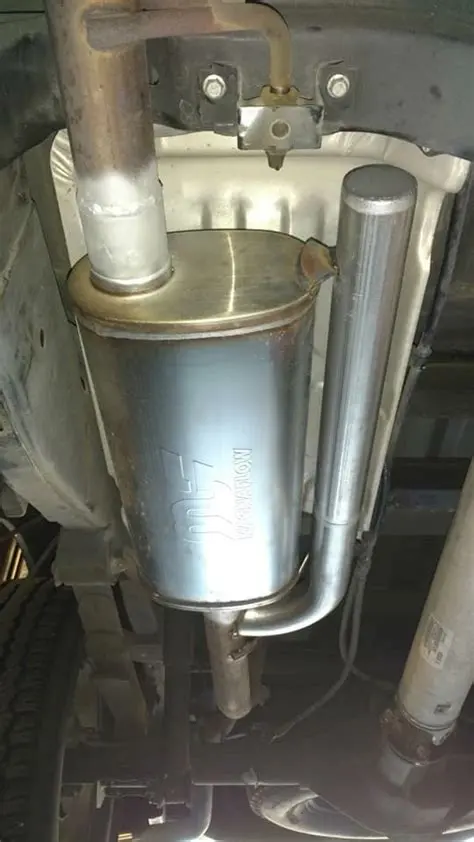

Resonators attenuate or change sound pressure,
usually are installed in combination with mufflers, before or after.
Types of resonators;
Glass pac / hotdog style
Insert
Tips
J-pipe attenuation
I know of one non Stang net car (import) with a fart can ( end-flow thru) muffler tail pipe that I didn’t like the sound of. He put inserts (budget motorcycle style) in the end of said fart can and that car sounded much better, still meaty but no popping/drone, night and day difference.
