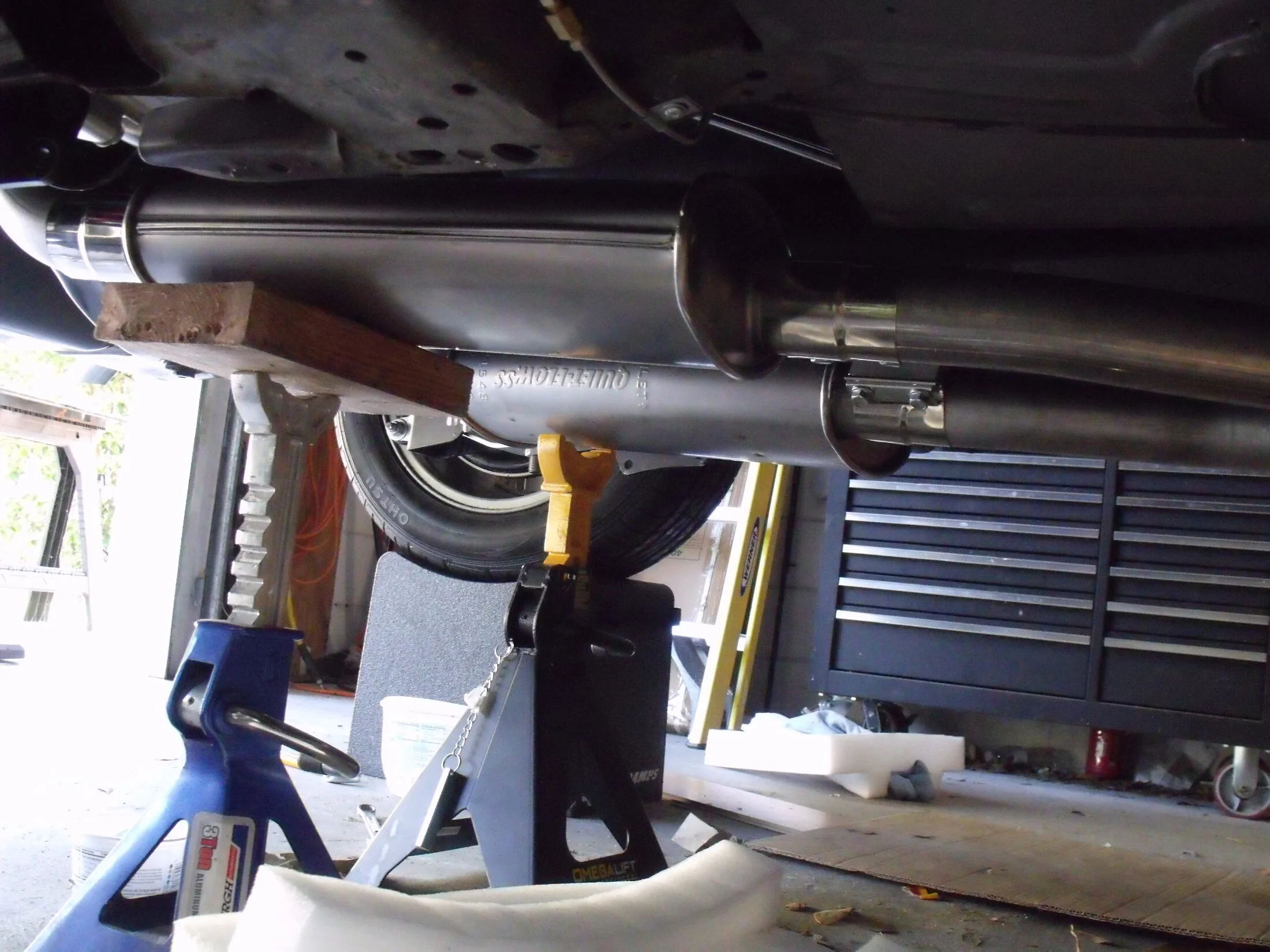

I used Walker 21548 Quiet flow Stainless Steel ( SS ) on my 83.. they were as large as I could fit under the car without causing any " creative" problems and are built to be " quiet " .....I believe they are a "turbo" muffler.. I looked at " chambered " mufflers ( Jones).. Articles claim the turbo mufflers are quieter.. Watched some Jones chambered muffler videos on Youtube and they were way too loud for me.....
Wish I could tell you how they sound, but I have not started the car since the install... soon maybe... TOO effin hot here in Florida to work outside.. I am looking for a very quiet exhaust..
