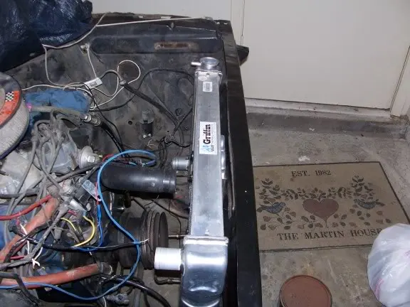

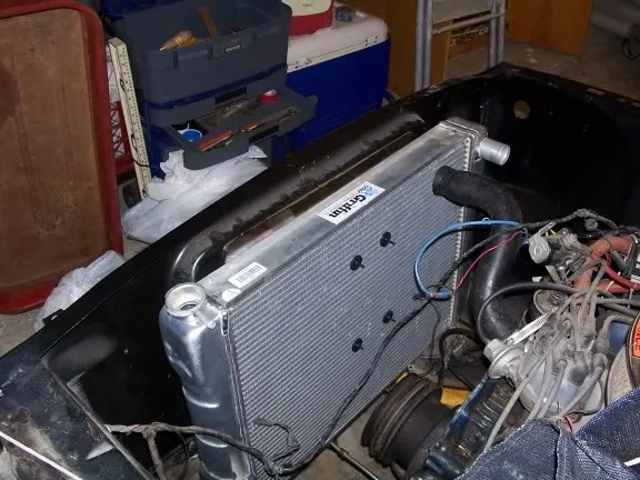

Well, heres my dilema. I ordered a Griffin Aluminum radiator a little while ago. I was stupid and didnt research it. It didnt come with mounting brackets of any type, no tranny cooler, and the bottom hole is driver side instead of passenger side. So here are my questions:
-Should I try and fab something up to mount it, and just have a rad. shop move the hole to the other side?
-Should I sell it and buy something else?
-Will a rad. from a Fox body bolt up to my core support?
There are lots of different options obviously. What would you do?

Now to the hard part. Trying to mount this thing. Its 27 1/2 by 19''. What would be the best way to mount it? It did not come with brackets. So all I have to work with is A big ass radiator and a core support. Any ideas?

Ouch that is one big a$$ radiator. It probally be cheaper to send it back.
With everything you are going to have to modified, and add. I'm sure you can find something in a wrecking yard that would work or even a radiator shop might be able to suggest something.

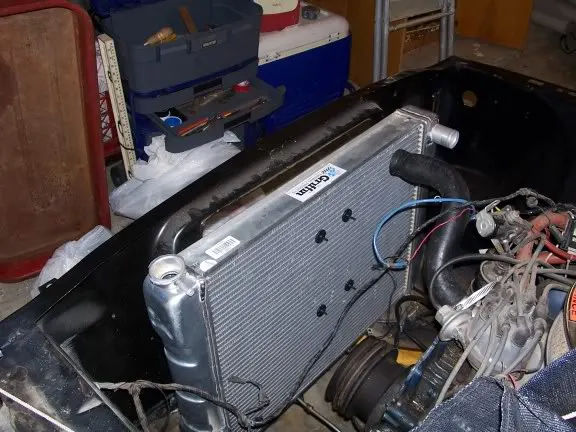

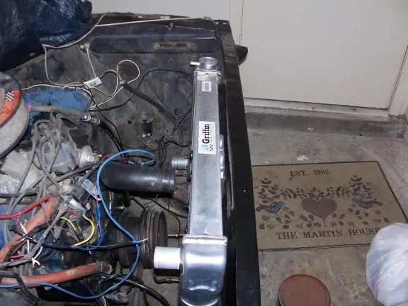

Do not send it back,its easy to make it work and worked to cool mine down.I bought the a little bigger radiator.I would suggest cutting the core support so it will mount flat and get a little more air to the core.I just finished my install last week.I had some tabs welded to the tanks and use a "chevy" type so all i had to do was use a Cool Flex hose on the upper and the stock lower hose(pass outlet).
Nice job, but I'd move the fan to the rear of the radiator. You have plenty of room and anything you put in front of the radiator blocks airflow, even a fan. I saw a fastback this summer with a monster aluminum radiator and two smaller fans in front and he was claiming it heats up in traffic. When I asked why he has the fan in front, he said that he thought it looked neat, which it does. I talked to him a few weeks later and he'd put the fans on the rear and his problems went away.

THANKS!!!!!actually the "Z" bracket is for the fans ,I made those...cost me 5 bucks for a strip and bent and polished it it.
The tabs are under those "Z" brackets.

3/4 x 3/4 aluminum angle used top and bottom of radiator to attach. Be sure to add rubber to help with vibration damper - aluminum not as strong as steel.

i originally was going to use a pinch weld moulding,but i found a Ranger door opening weatherstrip that i warrentied for my brother and never put on.its cushioned against the the core so it doesnt rub on the metal.

Its a Summit (made by Northern)universal "chevy" type,the core size is 28.5X19 and it cost $169.99.
The fans are 2 16" pusher/puller Scotts fans,rated at about 2-2100 cfm,but i think i might go for something with more CFM later.
