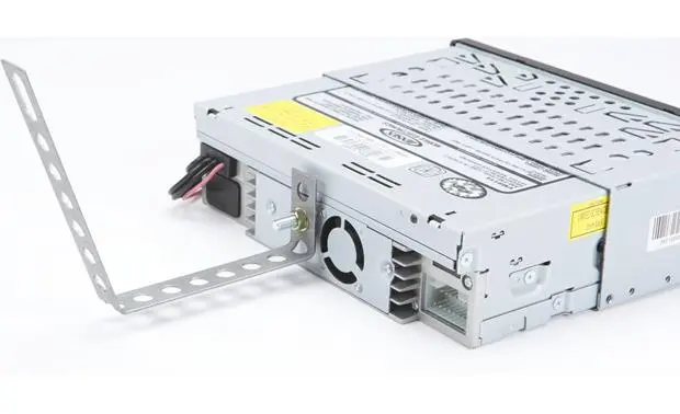

Once you get that front plate situated, I would look to adding more structure to the body of the radio. They come with that one strap to attach to the back, but maybe a second one wouldn’t hurt to help out the stress on that plate. Just a suggestion.
Elaborate on that my man.
There always a strap like this to help support the weight. It may be enough with one, I just like to overkill things, so I’m thinking ones on the sides would help take the pressure off the glued in faceplate.
I will most likely do that just got to figure out where to mount it inside.

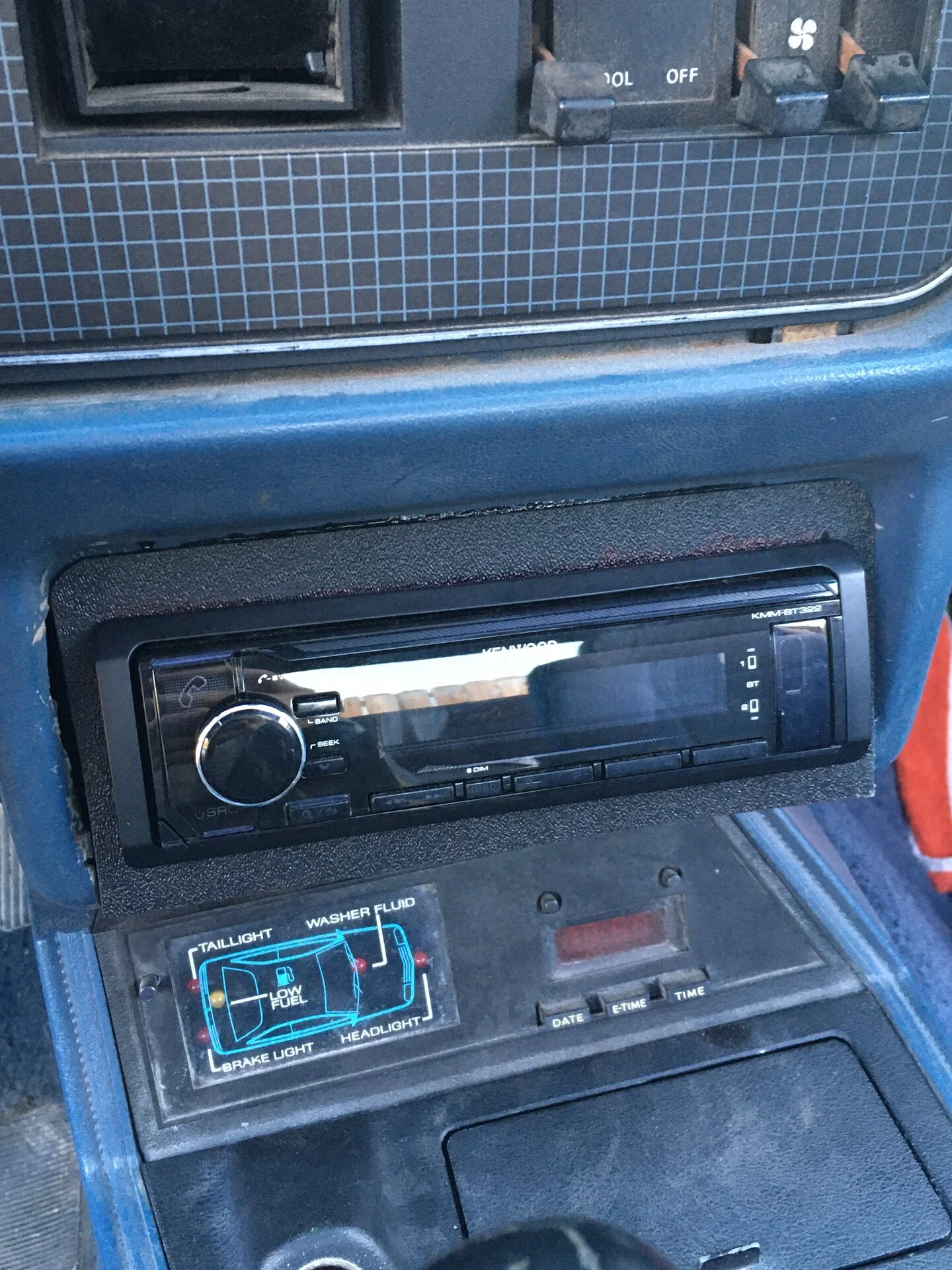

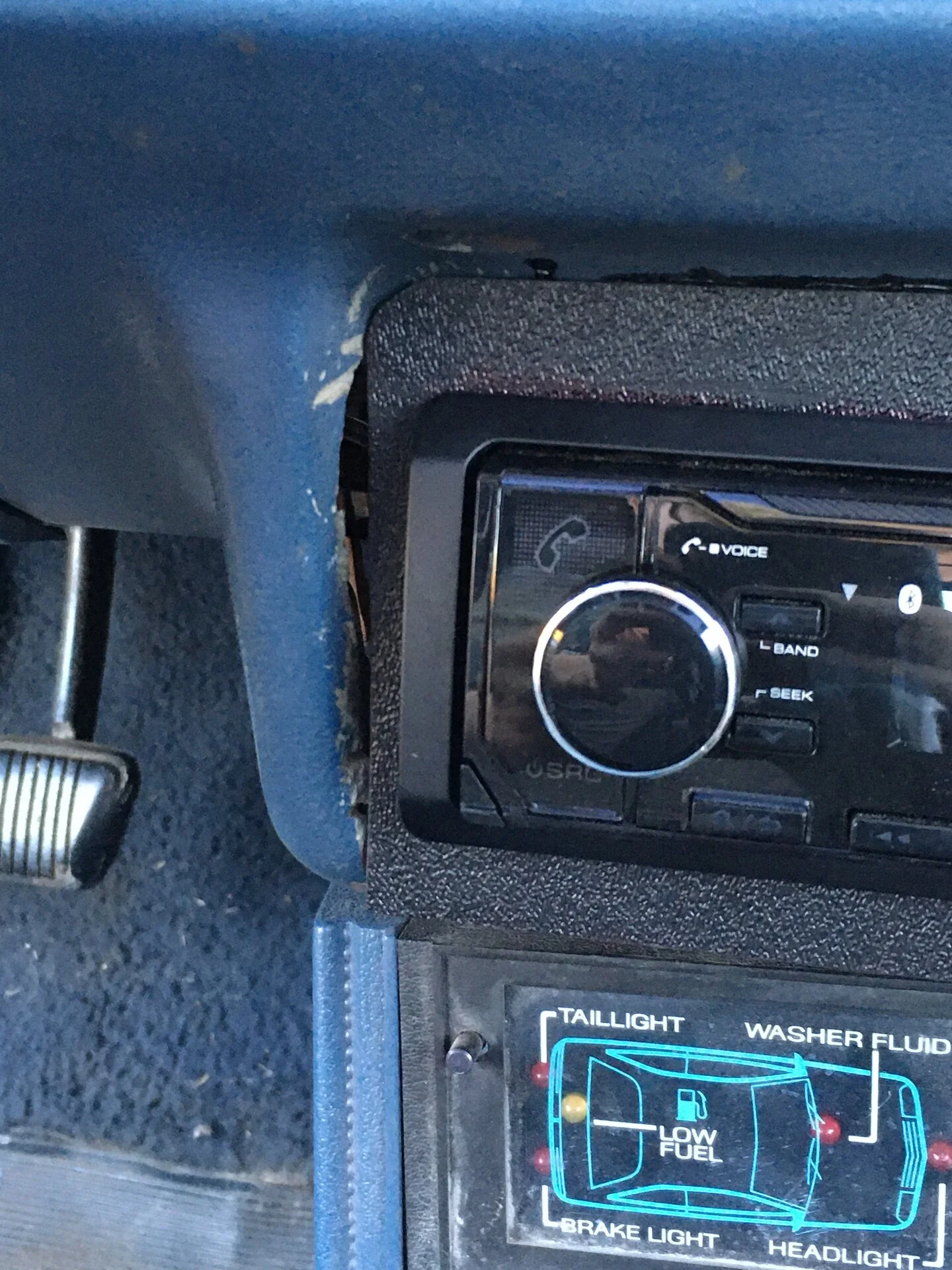

Aug 11, 2020
#75
  • Aug 11, 2020
  • #75
it doesn’t look the best but i’m happy it looks better and is very sturdy! i am open to ideas how to fill the gap in the second pic. thanks for all the help.
