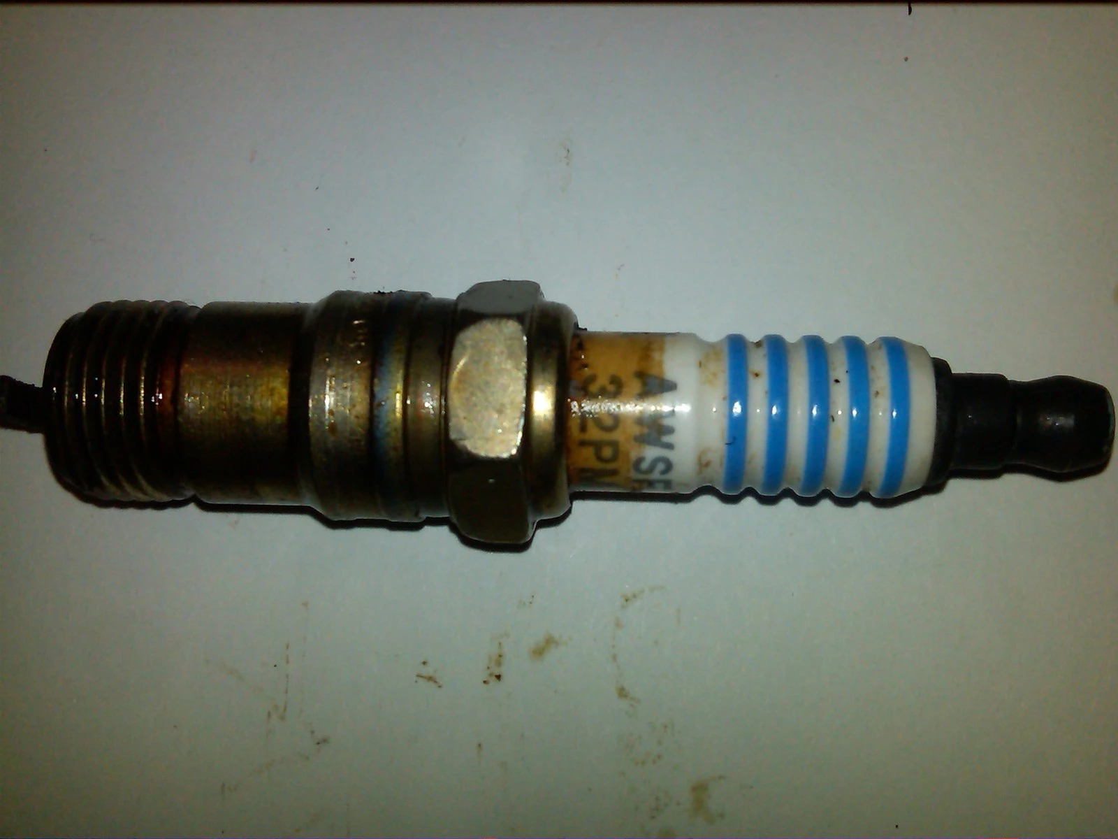

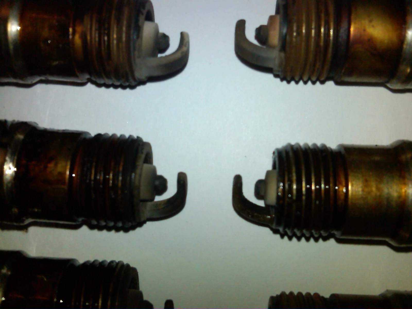

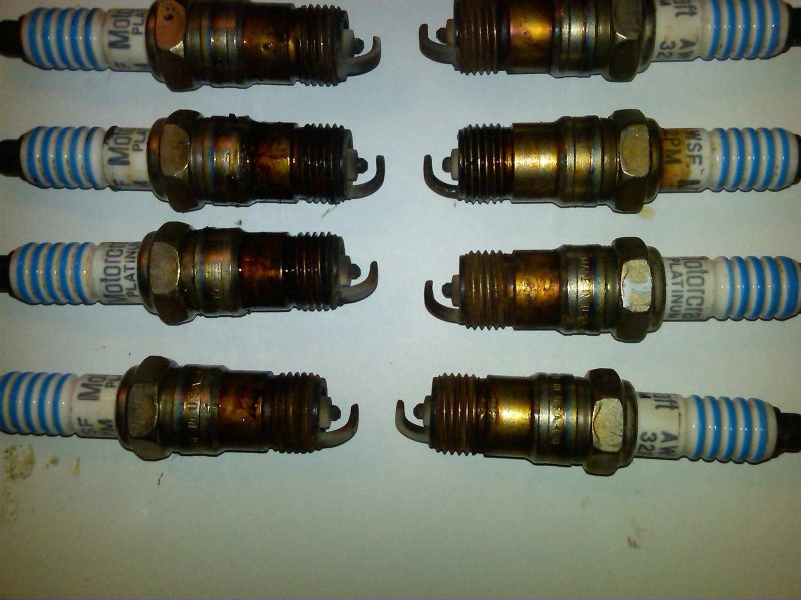

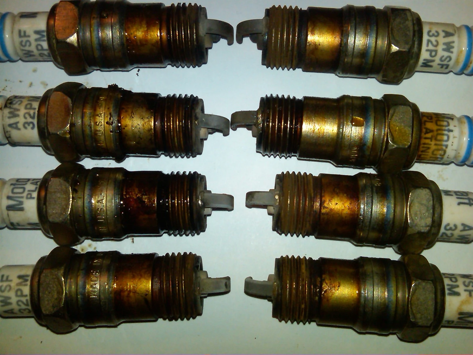

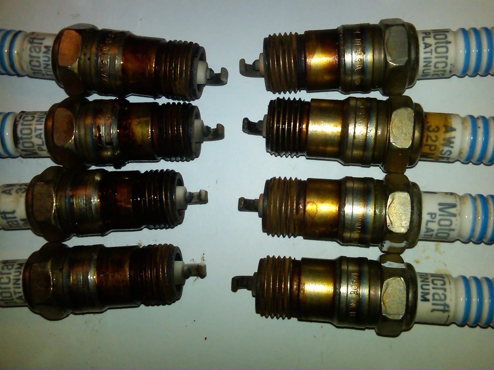

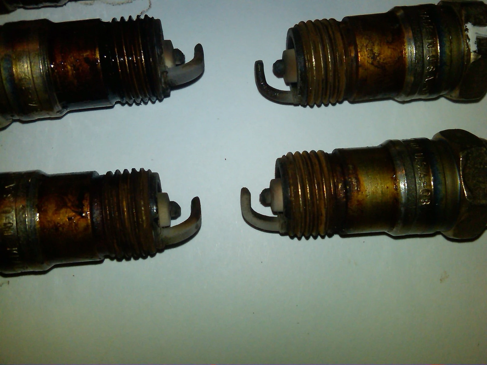

I don't know the cylinders so bear with me :) Left ones are passenger, right are driver. The driver's side, 3rd plug had a lot of something fluid in it. I couldn't tell if it was oil or gas but it had a reddish/brown texture to it but no distinct smell. I was able to make it about 1 to 1.5 turns on the plug by hand though before I needed the ratchet so I'm guessing that one had worked it's way lose and had fuel blow by. There was quite a bit of mist that blew up out of that hole with the plug still in the hole so it had some fluid on the top of the plug.
The passenger side plugs were all really wet and assuming it was fuel and not oil. The "strap" was a little bit whiter than the driver side also
Here's some pics of the plugs. The one with the fluid is pictured by itself. You can see the brown coloring on the porcelin. I haven't fired it up yet because I did an oil change also and the 5 qt jug is in the other car that's not here so I don't know if it fixed the off idle.

Coolant can easily turn brown and does so quite often. When was the last time you had a flush? What color fluid do you see in the reservoir? Coolant can also turn brown if it has been sitting in the plug wells for some time. I doubt the fluid you're seeing is fuel. You might have a coolant leak somewhere and it is collecting in the plug wells.
The fluid was only in that one well and haven't washed the engine in months. No heavy rains either. None of the rest of them had it. I'll keep an eye on it in the next few weeks since it doesn't take but about 5 seconds to pull a boot. For some reason I thought you had to remove the fuel rails to do the plugs. Good thing you don't.
The coolant has turned a brownish color and I do need to flush it. Just haven't made the time to do it but I guess I'll have to. There was no water or antifreeze that showed up in the last oil sample so I don't think there's a head gasket leak to might be putting some in the cylinder. We shall see. I'll report back.
