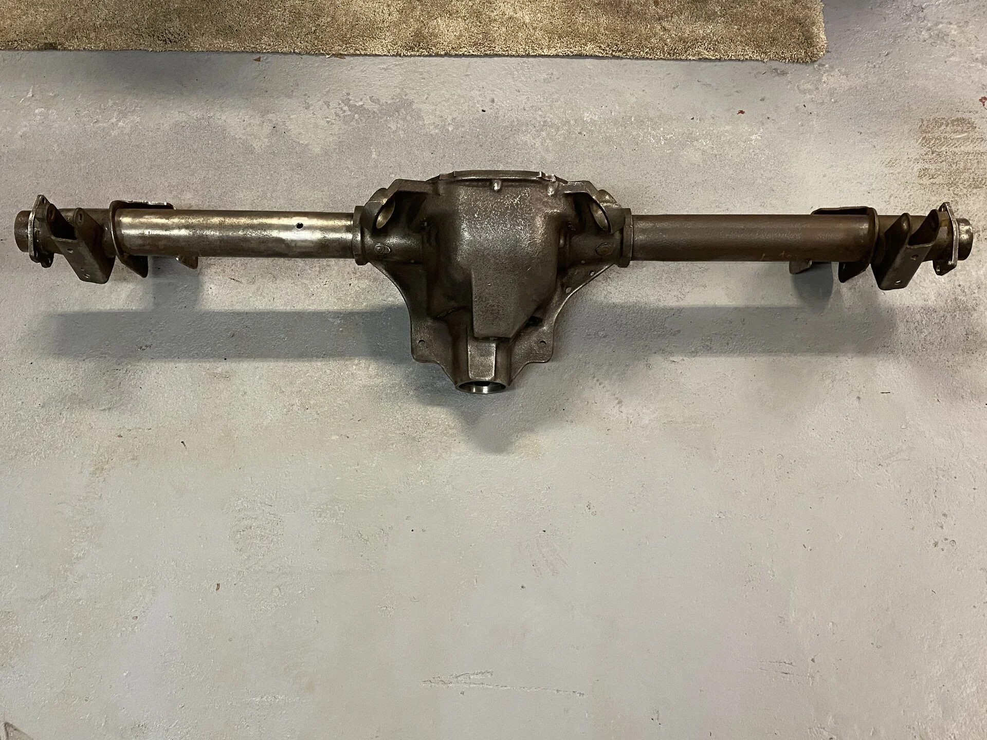

Painting my new rear end black ( no jokes here) and not very happy with how the paint is working using Rust Oleum... I used Eastwood products 15 years ago on my dodge and was happy with the results....
Any recommendations on some better rattle can paint brands?

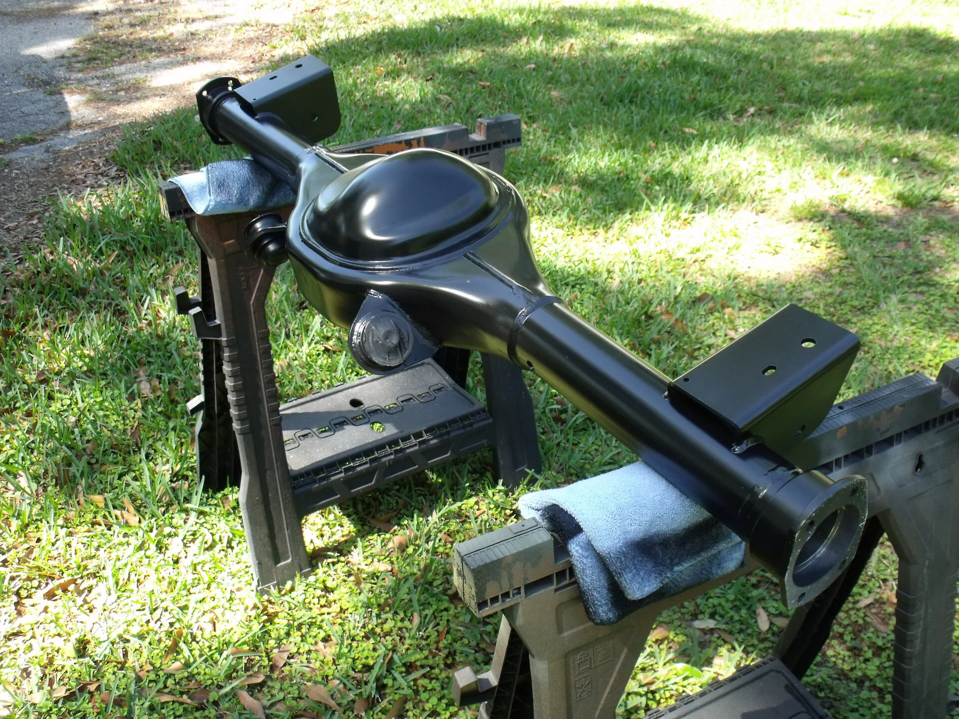

Used POR15 here also,and like stated it's held up great for many years.
Works best on rusty metal after removing any loose scale,can't say I've ever used it on an already painted surface.
Seeing how the rear end is well protected under the car,it should hold up fine either way.
The POR15 is tough stuff and no joke.
An equally nice, although not as durable; finish would be some regular ole Rustoleum rusty metal primer (2 or 3 coats) and a couple of coats of Wrinkle Black:
Amazon product ASIN B000CPIMXKView: https://smile.amazon.com/VHT-SP201-Wrinkle-Black-Coating/dp/B000CPIMXK/ref=sr_1_1?crid=AJ46M0E56WGA&keywords=wrinkle+black+paint&qid=1648173255&sprefix=wrinkle+black+paint%2Caps%2C102&sr=8-1
Spray that stuff on a warm day and in full sun. Otherwise, you'll need a warm paint booth (thingy) and some halogen lamps. For an entire axle: 4 x 300 watts should do. You might get away with 3 but the finish won't be as even.
The stuff is amazing and holds up very well to grease etc. Stupid easy to touch up too.

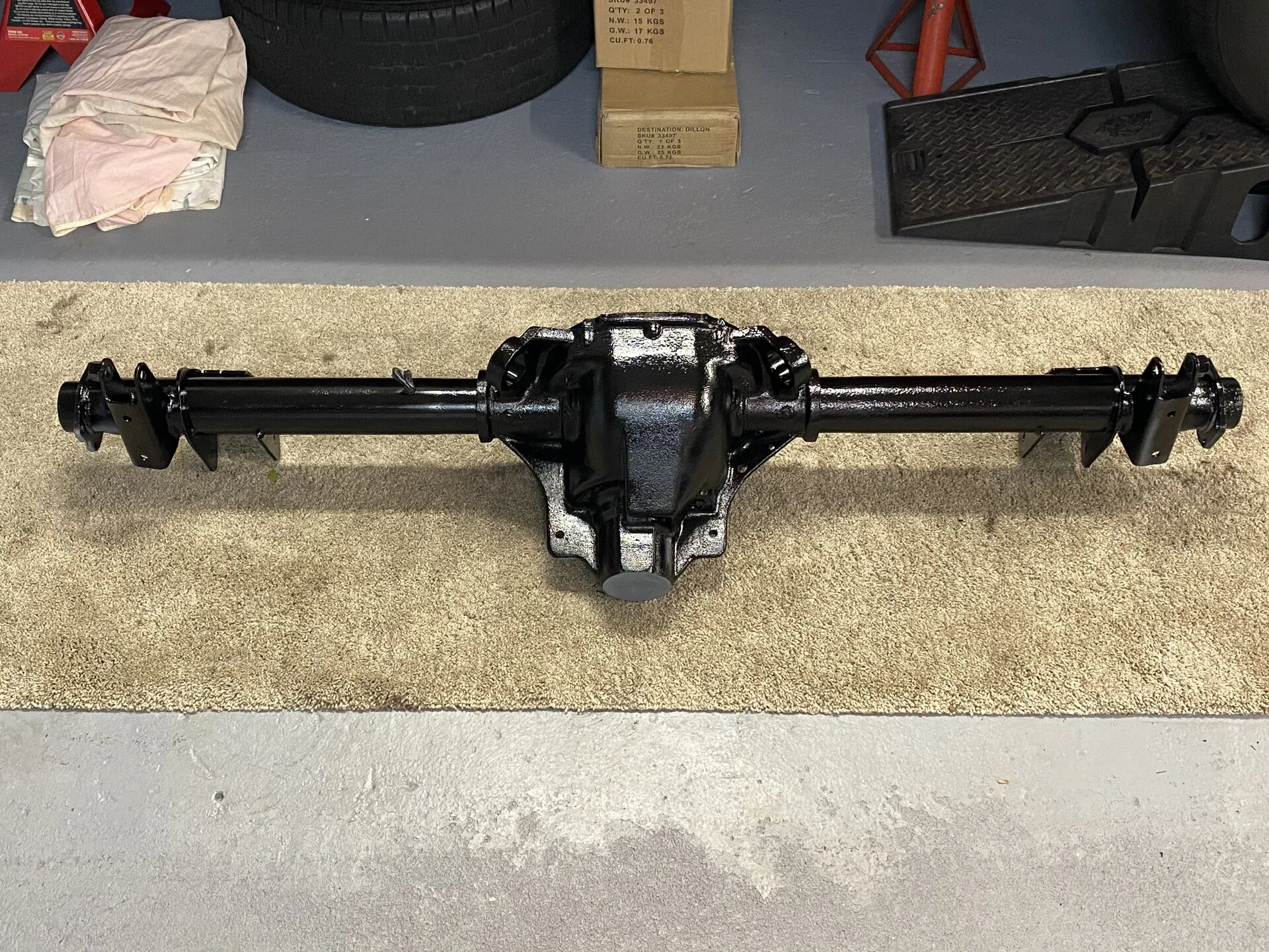

I went the RustOleum gloss black route also. Had it down to bare metal, prime, and paint. Pretty happy so far.
……and cause everybody likes pictures….

As said I have been using Satin Black Rustoleum and it just isn't flowing very well. I am sure I am being too picky here...
