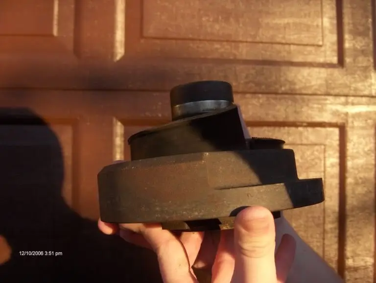

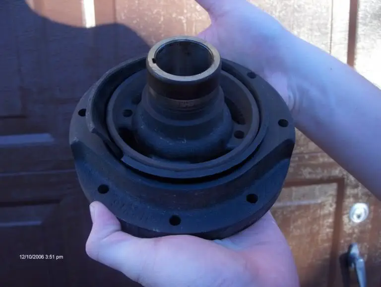

Locate your crank... it will be the big hunk of metal behind your crank pulley... There is a rubber isolator that separates the 2 pieces of metal. IF YOU FEEL BEHIND IT AND THERE IS RUBBER: harmonic balancer is shot and needs to be replaced. Leaving it go can cause crank damage.
If it looks like this:
Its bad you should feel no rubber lip sticking out...
This would cause your vibration problems as well as your pinging if it has spun a bit out of time.
