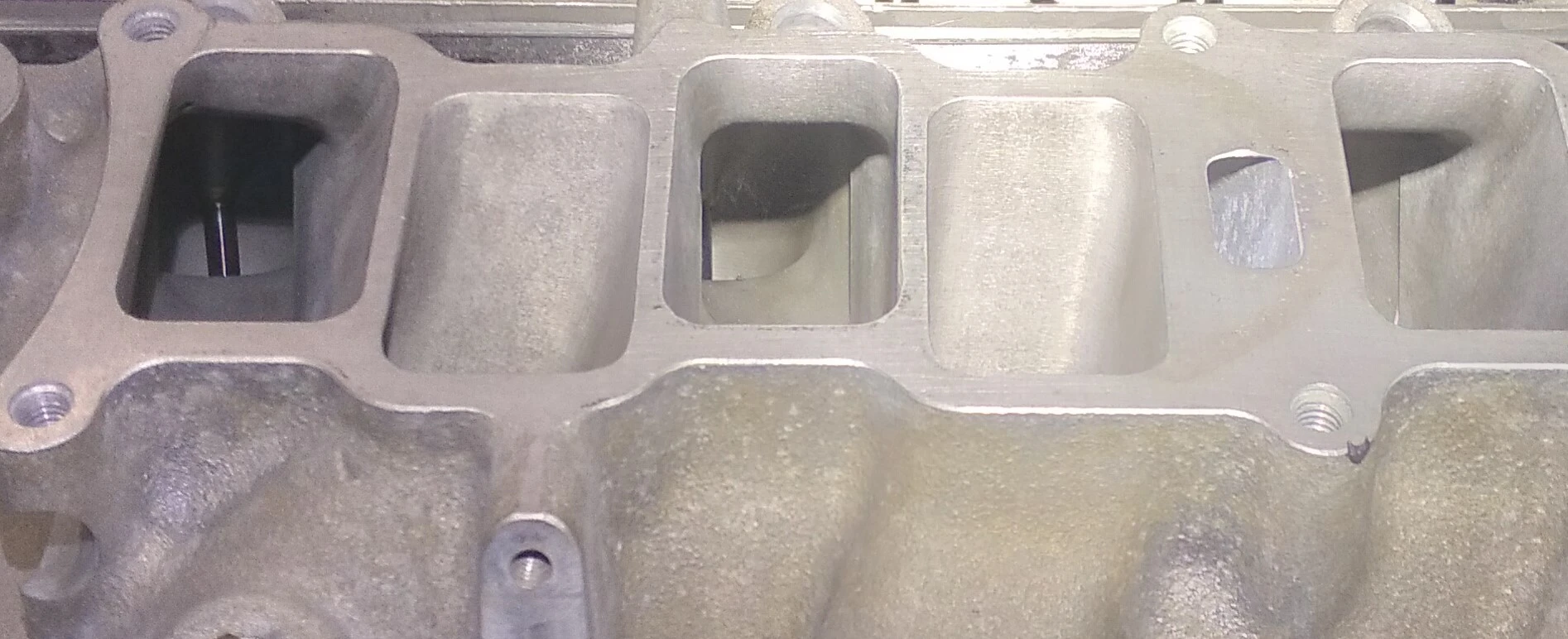

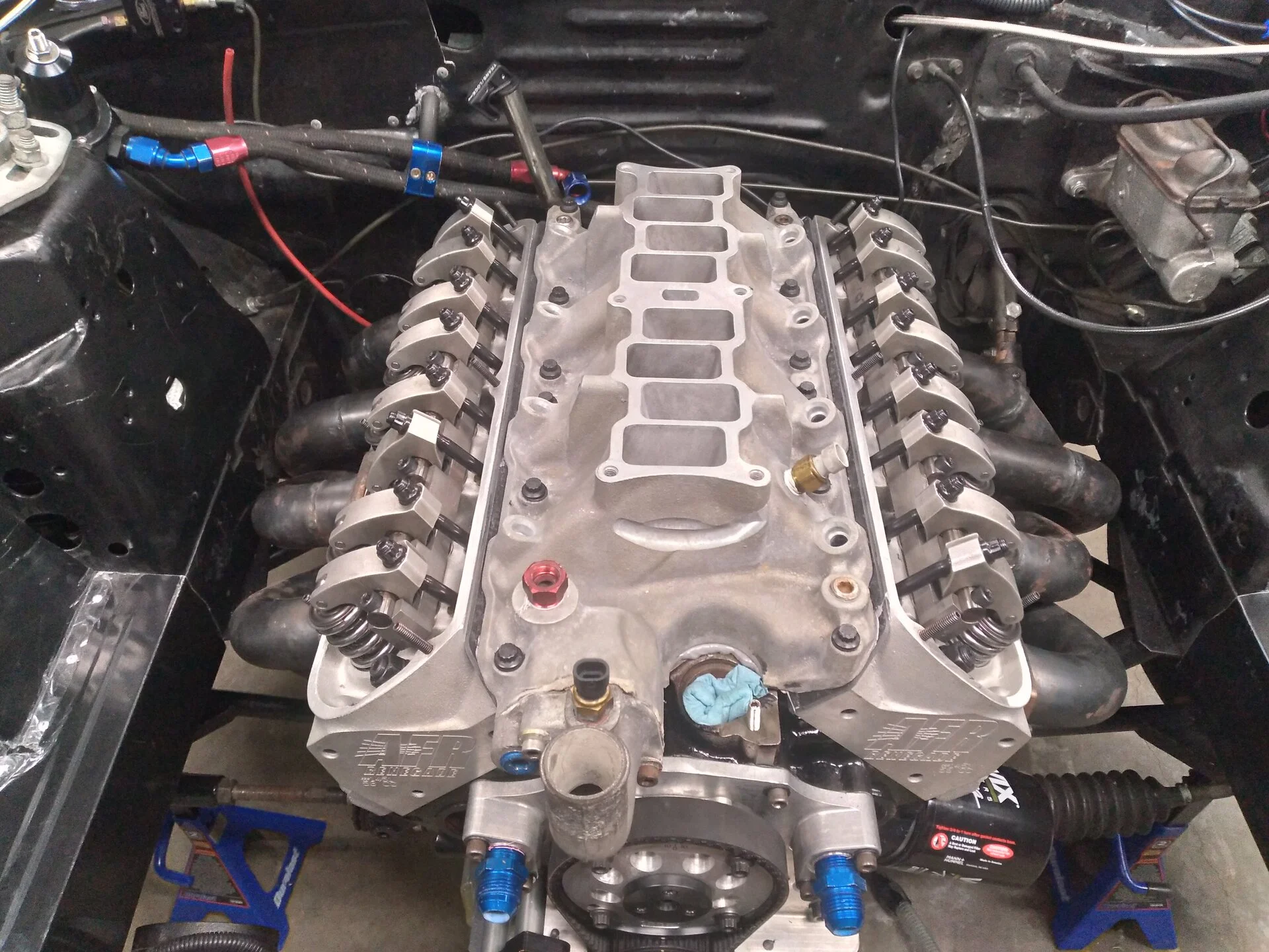

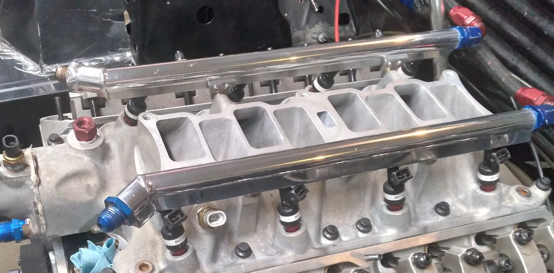

Got the lower intake manifold installed tonight.

The port alignment turned out real good as well.

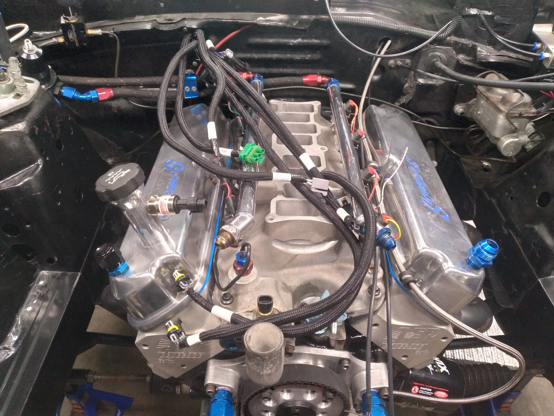

Spent a hour tonight after work and got the fuel rails cleaned up and installed. I have to work tomorrow, so progress this weekend will be less than desired.

I am using Precision Turbo 220 lb/hr fuel injectors.

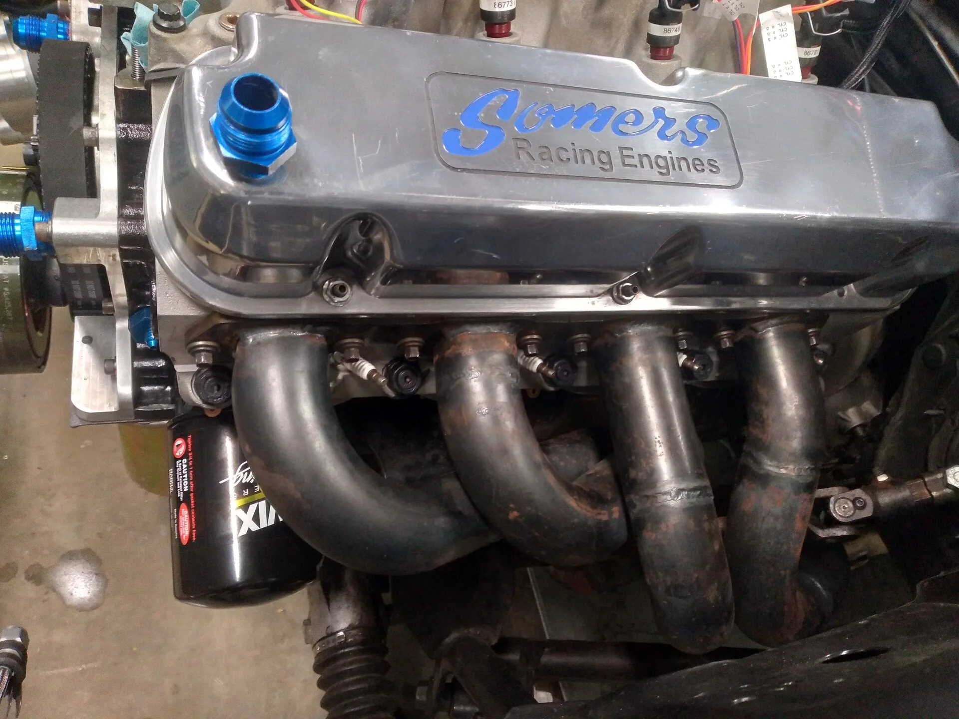

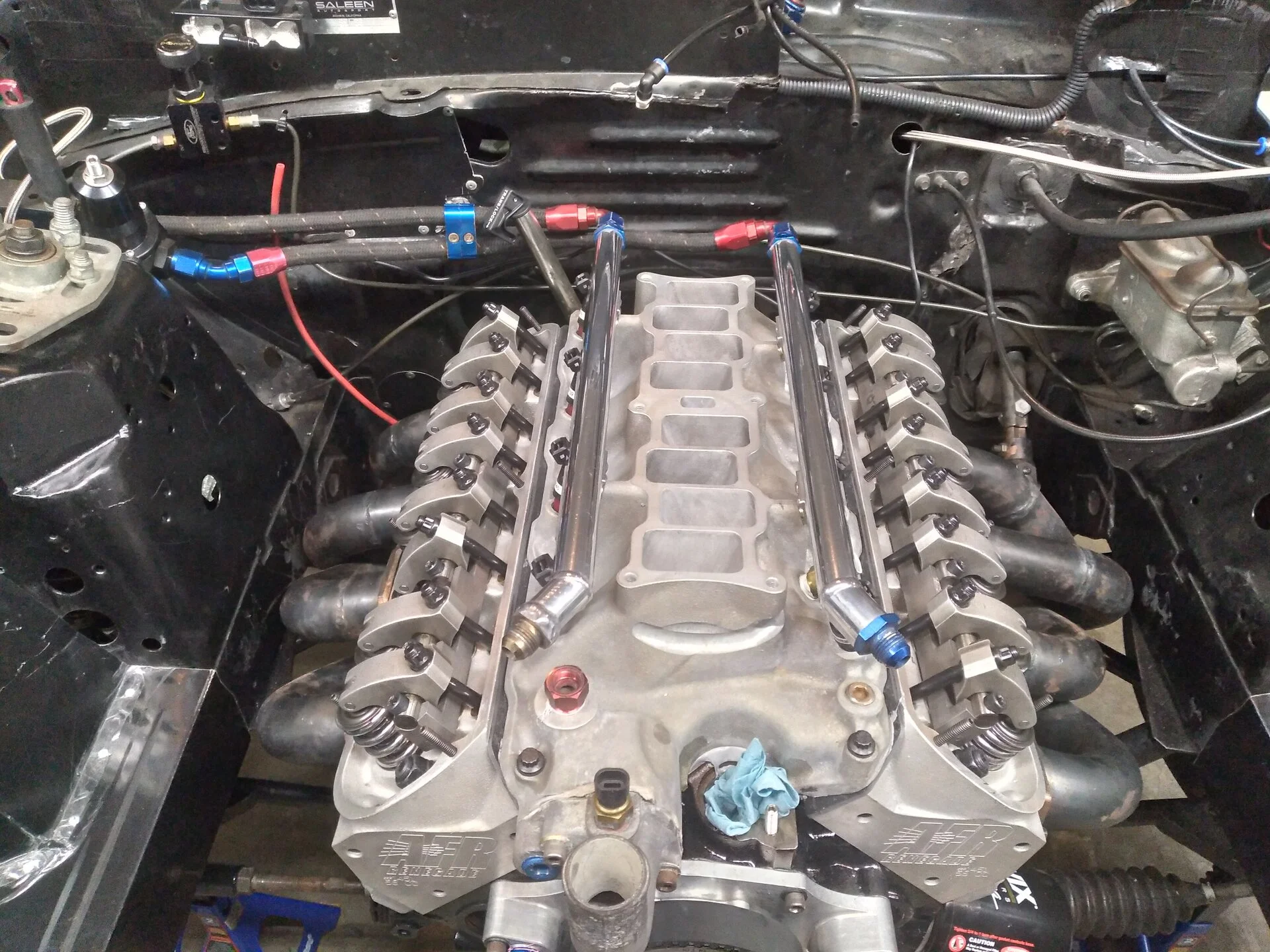

Got the headers final bolted/tighten up. Installed the NGK 8 spark plugs gapped at .025
The access is real good even with a 2" to 2.125 stepped header with a 4" collector.
In fact you can get to the head stud nuts by removing a few of the header bolts.

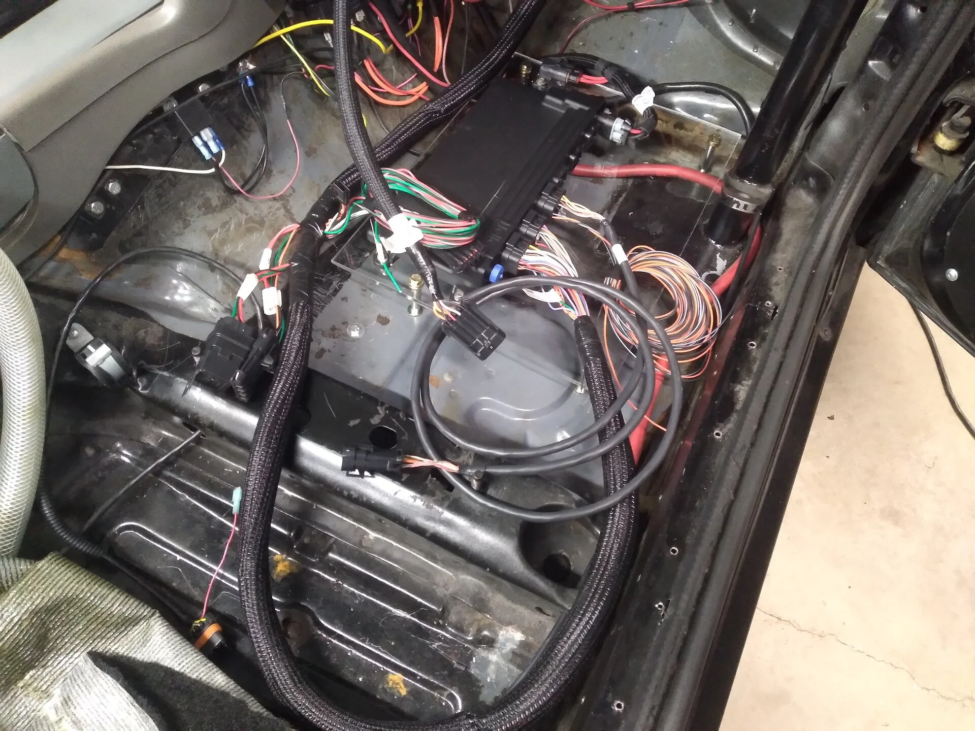

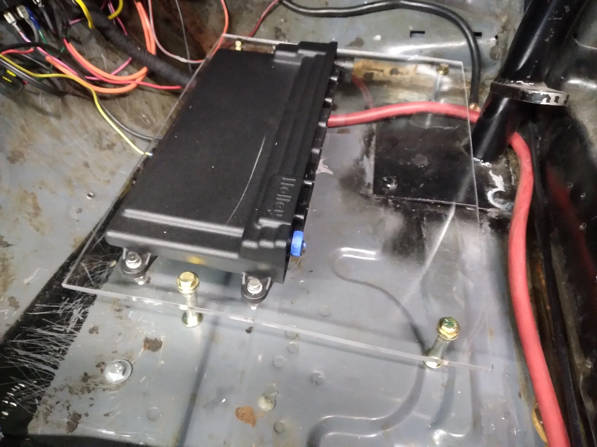

Anyway, I went to Lowes on Friday night after work and picked up a 3/16" thick piece of plexiglass to mount the Dominator ECU to. Holley is pretty adamant about not letting the ECU tough metal/ground. About the only place I could find to mount the ECU was on the passenger floor. Used some 1.5" high spacers to get it up off the floor and to clear the slope in the trans tunnel. Used nutcerts in the floorpan. Those work real well. I I have a lot of harness that needs to be plugged in, wires routed ect.

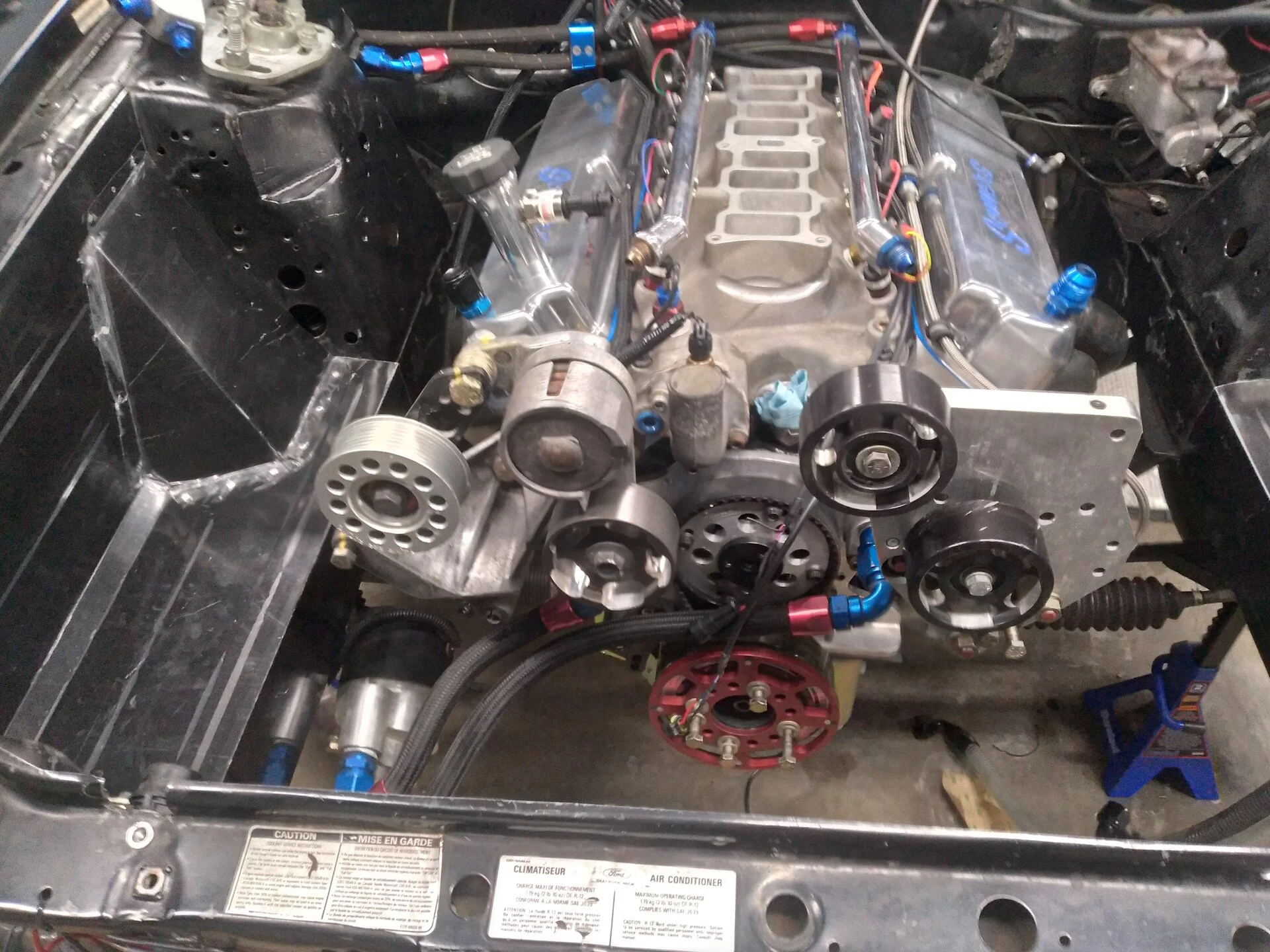

I got the main harness in the car.
The harness for the engine is a bit disappointing. The lead for the coolant temp sensor, and intake air temp sensor are too short and will need to be lengthened. Those sensors are in the stock location, so have short leads does not make any sense, unless they expect me to cram a lot more of the main harness into the engine compartment, which I don't want. The weather pack end for the TPS is male and I need a female end. The weather pack end for the 3 bar MAP sensor is wrong for the sensor and will have to be changed. I will not be using the IAC or Oil pressure harnesses. I am going to be using one of the many inputs available to install a combo oil pressure/oil temp sensor. The engine idle rpm is high enough that an IAC is not necessary. The fuel pressure sensor lead is long enough to work just fine.

Here is the rest of the main harness in the car that plugs into the ECU. I will be able to shorten the overall length of this harness by around 2.5' once I get everything up and running like it should. A lot going on, need to start hooking up the wires for fuel pump, key on power, wide band O2's ect.

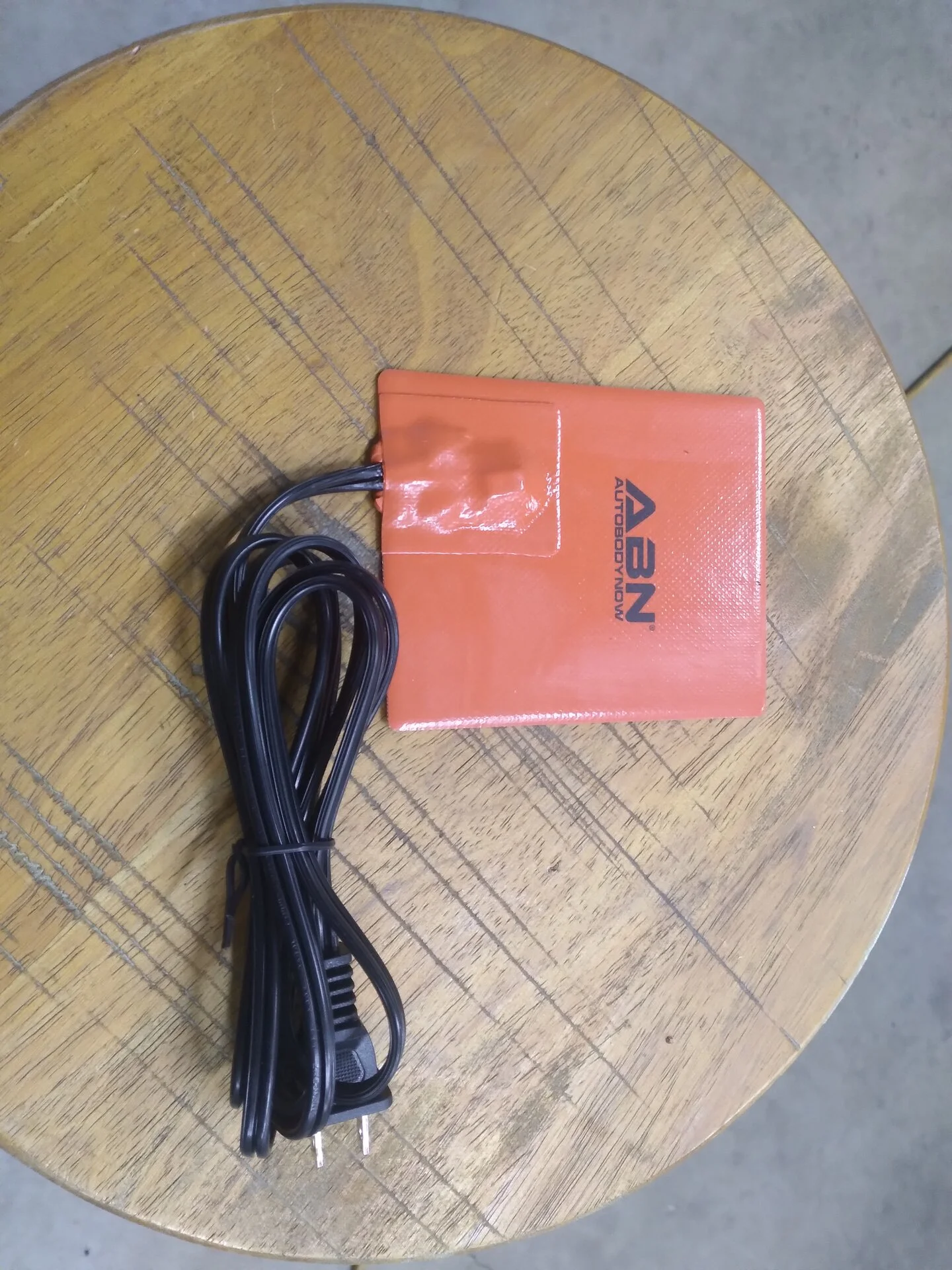

I also managed to get my oil pan heater installed to the bottom of the oil pan. Since I run a semi-synthetic 20-50 race oil, I like to have the oil hot before I crank the engine over. It helps with lubrication the engine faster due to the oil being thinner at temp. Pick of the heater before install.

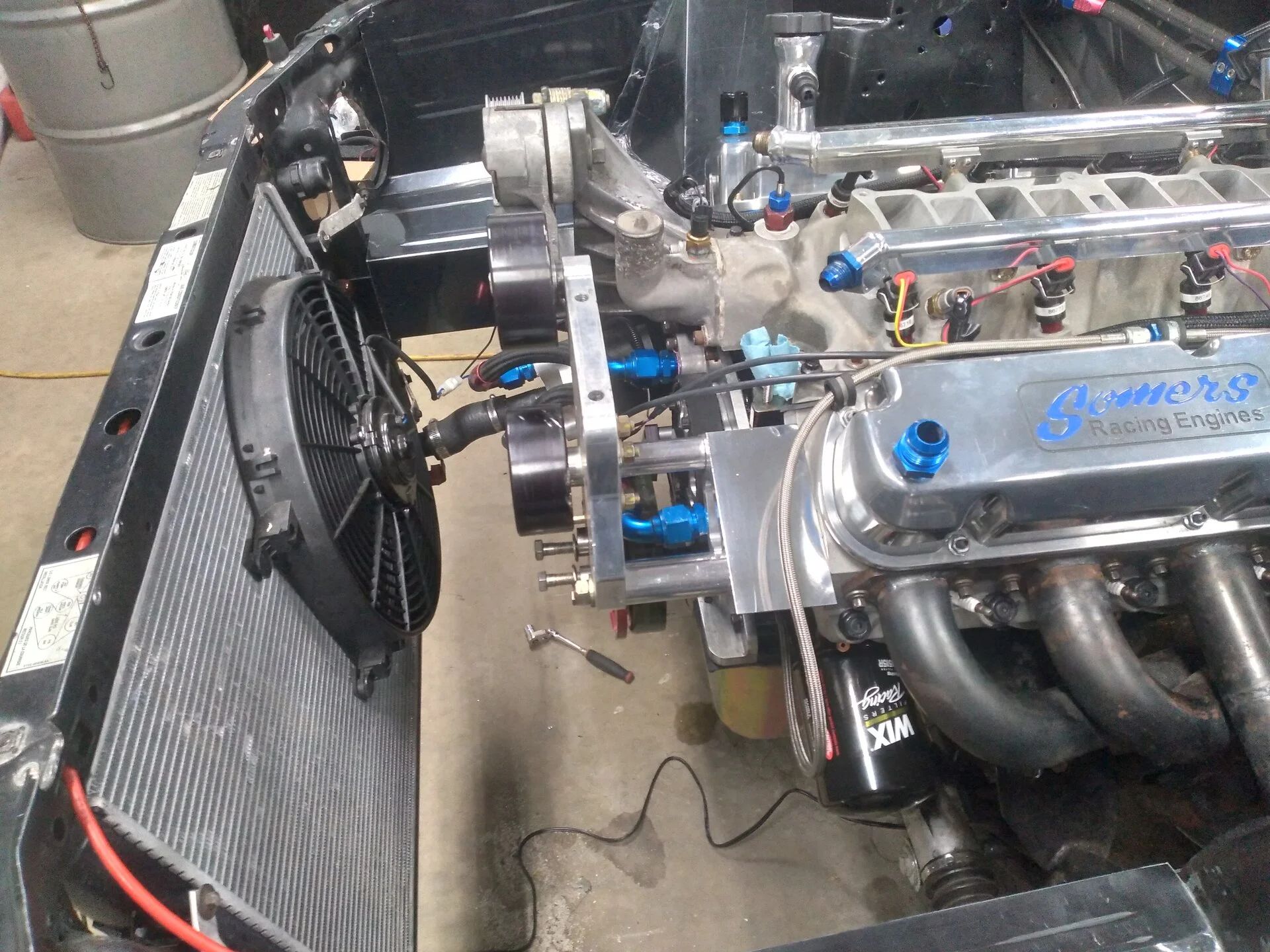

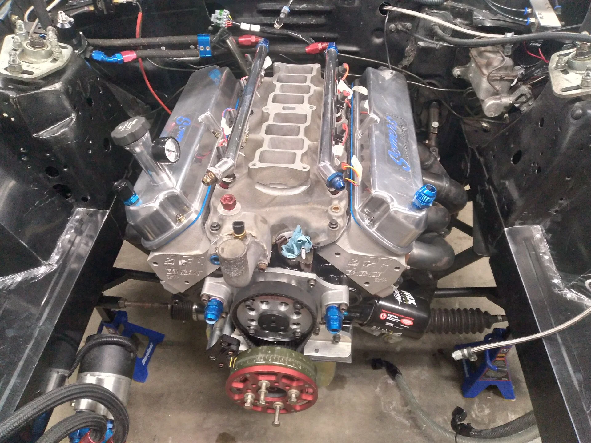

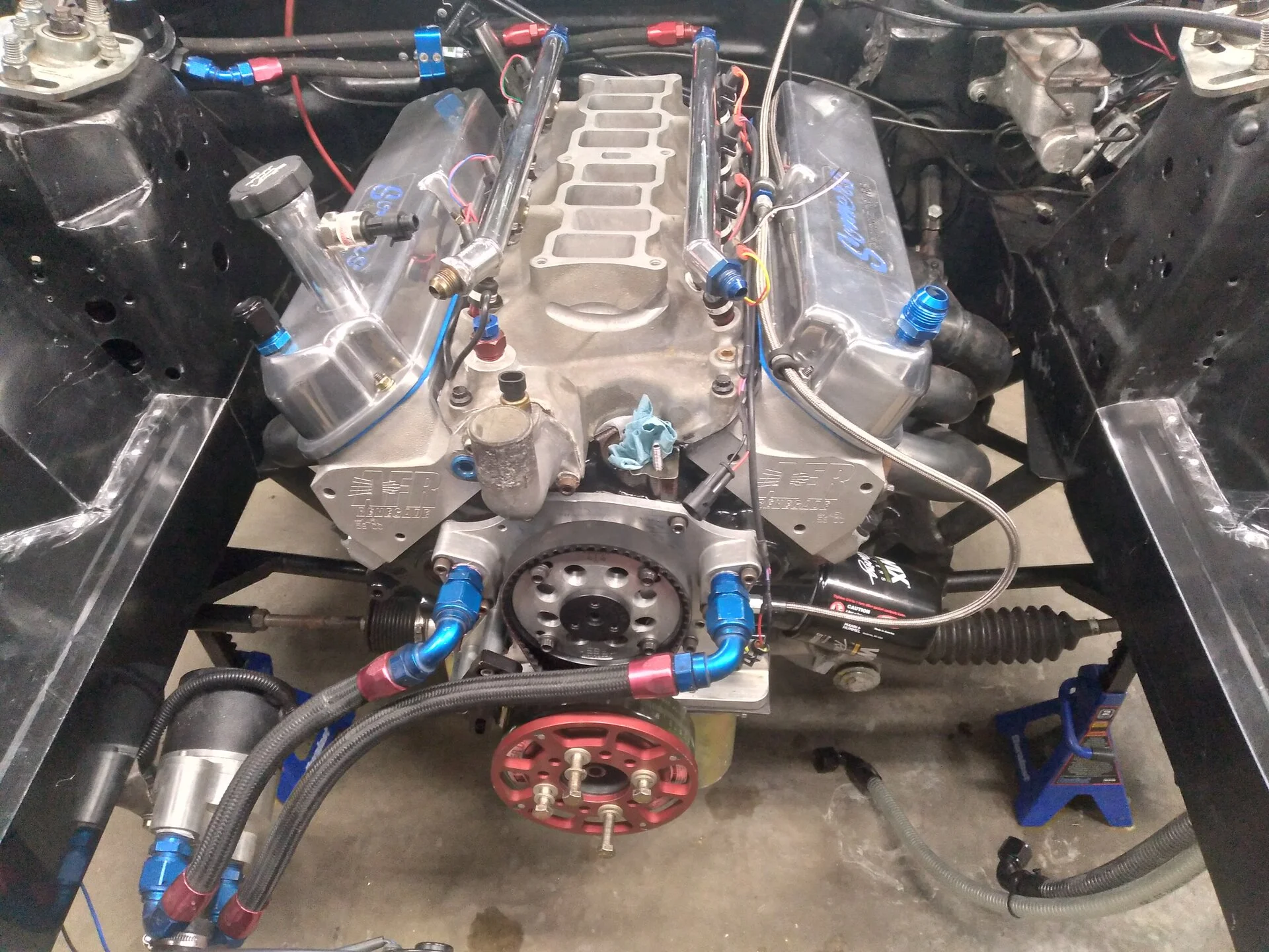

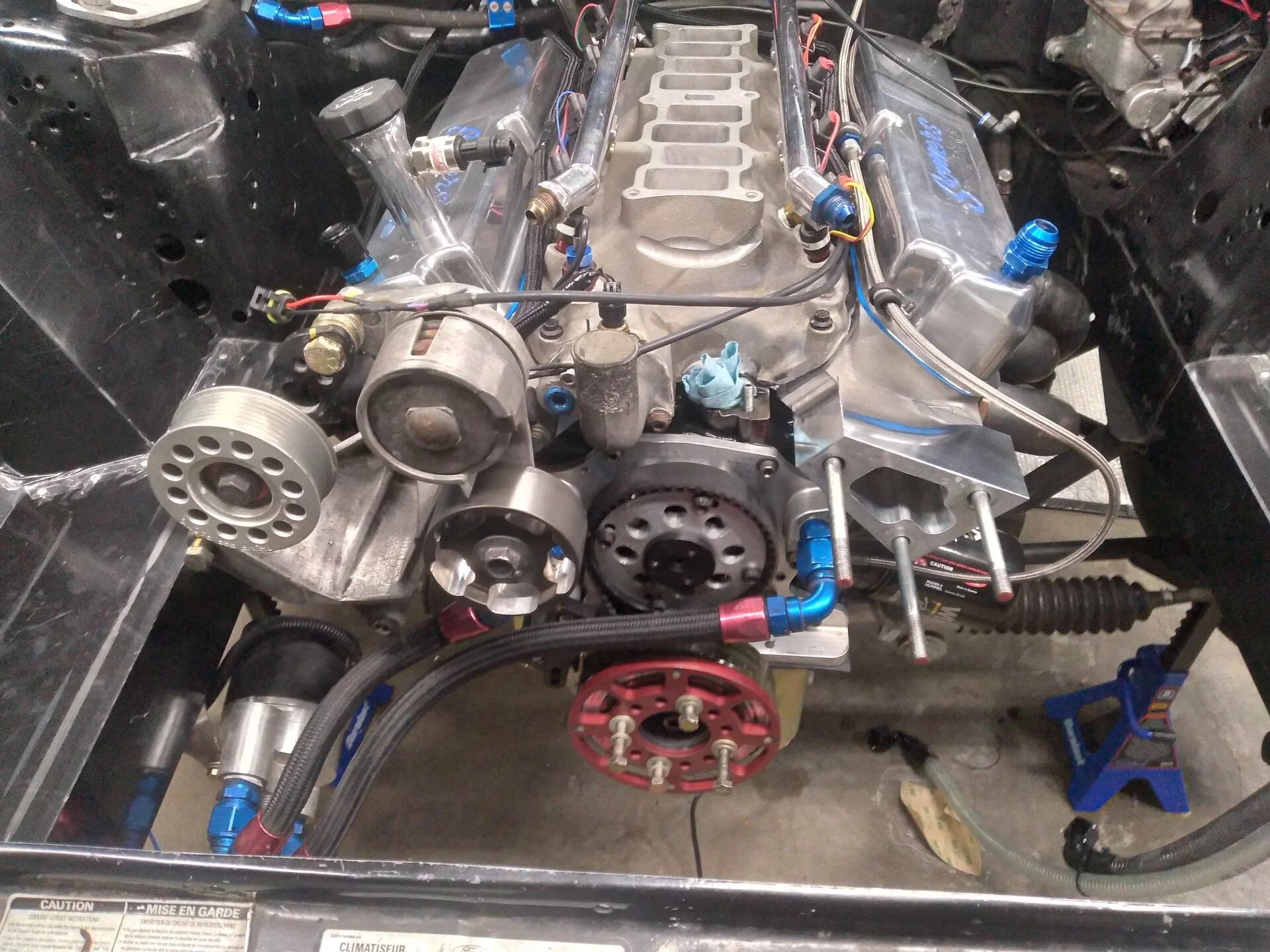

Made more progress. I have the wiring pretty much complete. Powered everything up and there was no smoke leaving the wires! Starter cranks, fan and fuel pumps work. So happy about that. Put some of the front accessories drive bits on. Still waiting for the crank pullies to get back from the machine shop.
