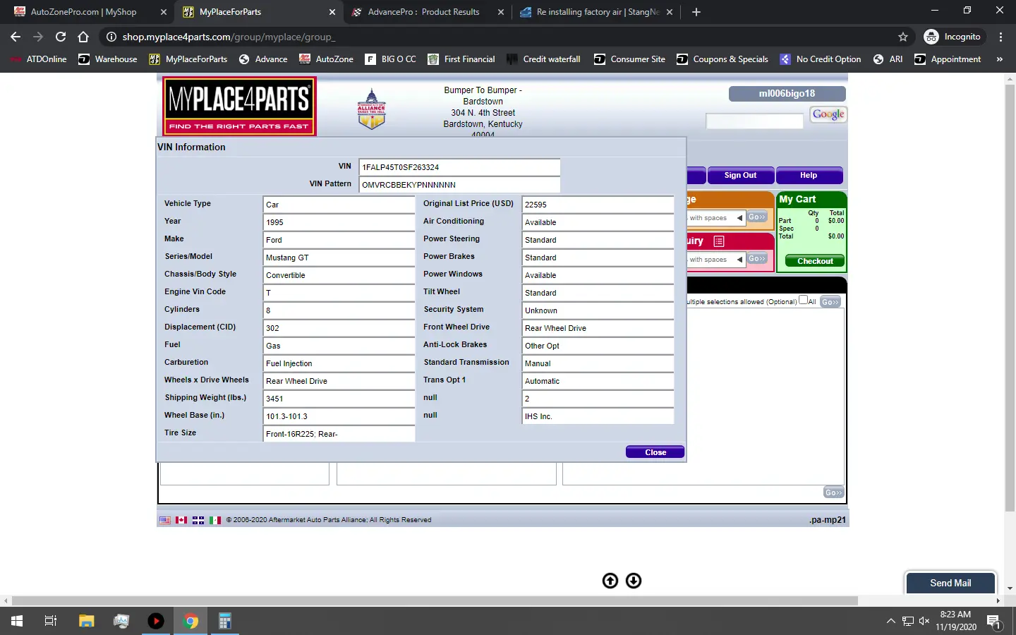

I've located all but the last one. 59007. Not seeing a condenser or evaporater. How would my setup for ac be different considering my carb set up?
Both from Bumper to Bumper
4 seasons condenser 40471
4 seasons evaporator 54557
on the difference between EFI and Carb. I honestly do not know, I believe that these all came EFI in 1995 from the factory.
Yes I know they came efi. But being my car is carbureted. IE, the ECU along with most of the other electronics have been removed wouldn't that completely change how the AC is setup?
I understand your dilemma, with the factory manual you will be able to determine what is computer controlled and what is not, while your ac would not be controlled by the ecu, the ccr (constant control module) would control cooling fan and wide open throttle cut off switch, I would guess the ccr has been removed too.
The ac will require brackets from a 94-5 mustang V8 car and I would think the 94-5 hoses would work too.
