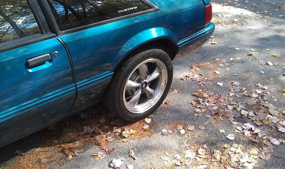

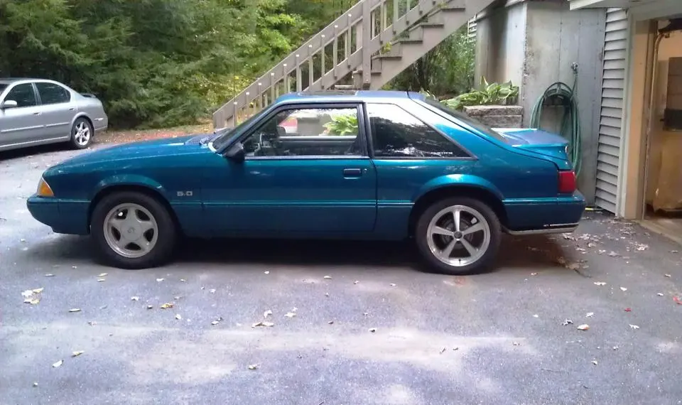

Figured I'd throw up a quick picture as I've not really shown what the car looks like on here. The swap consisted of:
- Used 8.8 that had an Auburn lsd with 3.55 gears installed in it
- LRS 5 lug rear swap kit for drum brakes
- Drake muscle cars aluminum rearend girdle/LubeLocker gasket
- SVE upper/lower control arms
- MM stainless rear brake hose
- New emergency brake cables
- OEM Mach 1 17x8's with 245/45s
I left off the quad shocks as well as the pinion weight/damper after reading a bunch of threads around here but I believe both are going back on. It will wheel hop if I get on it hard enough. I'm still tracking down what I can only describe as a "loose" feeling in the rear when taking off from a stop and real slow speeds in 1st gear, I am hoping that I just need to snug up the control arm bolts.

So I did get a chance to tighten up the rear control arms and reinstalled a new set of quad shocks, wheel hop is gone and the "loose" feeling seems to have disappeared.
I recently changed my mind on what wheels I want to run, I am set on keeping the quads installed and I don't want to deal with clearance issues so I want to stick with an 8" rear wheel. Mach1's are nearly impossible to find, especially since I already have 2, when I do find individual wheels the prices are outrageous. I also wasn't as impressed with how they look as I thought I would be...so I picked up a set of these for a killer price this weekend:
I think it looks 100% better than the Mach's, what do you guys think?
