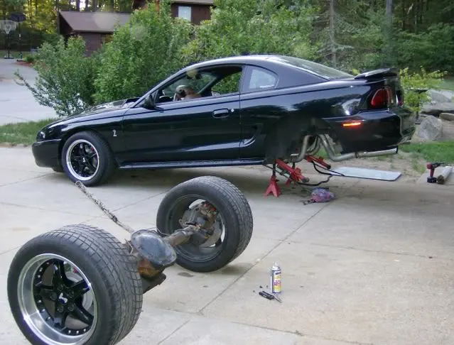

It's not hard at all, the main tool you need is a floor jack and jack stands.
Jack up the rear of the car and support the car under the torque boxes. With the floor jack under the differential, unbolt the rear shocks.
Once the shocks are undone, lower the axle and remove the springs. I have found that if you leave the wheels on, you can slip your foot into the wheel and step down, which will relax the spring on the side you're stepping on, and they almost literally fall out. Do the same thing on the other side.
When replacing the arms, remove ONE ARM AT A TIME! make sure you replace that arm before moving on. this prevents the axle from shifting around uncontrollably.
Once all of the arms are installed, do not tighten all of the bolts completely. You'll want to raise the axle back up under the body so it's near ride height. THEN tighten all the bolts.
lower the axle back down and re-install the springs the same way you took them out.
jack the axle back up and bolt your shocks back in.

I found it to be pretty easy. Only a few bolts.
Thanks fellas
Yep, as said, its not too bad. The worst part is the laying on your back part.
Oh,,, when lowering your axle be careful not to over stretch the little rubber brake line that comes down in the middle near the differential. Its best to disconnect that.
I forgot about that when I did mine and learned a valuable lesson:thinking:
Reactions: A5literMan
As said above its not too bad, sometimes there will be corrosion on the bolts and they will be seized, its a good idea to put some anti-sieze on the bolts when putting everything back together.
Also for safetys sake block the front wheels. Also the bushings on the axle can be a pita to remove. I used a torch on my old car. Haven't done the uca yet on the 86. I'm going to redo the entire rear this spring/late winter. Boxes,uca,lca,springs,shocks,rear axle,and a arb.
Reactions: revhead347
You'll need to drop the cat-back out of the way to get access to the front bolts, and then pray to all that is holy that the bolts haven't rusted to the sleeves in the bushings. If they have, time to bust out the sawzall or an impact wrench and get after it.
as said, the only things that will really bite you in this is the factory bolts. if they've never been removed, they WILL be rusted to hell and back, and WILL be a pita to take out. a couple good punches, a hammer, and an impact wrench will all be handy. even if by some miracle theyre not rusted up, put some new bolts in while you're there, the lowers are M12 thread x 110mm, class 10.9 (metric version of 8.8). local fastenal near me had em in stock when i did mine, 4 bolts/nuts, 8 washers, and 4 lockwashers was like $10-15 iirc.
There is another tool not mentioned. Sometimes no matter how you jack the rear end, the bolt holes won't align. Get a ratchet strap. Sometimes you need to run a ratchet strap between the front of the car and the axle to pull the axle a 1/4" forward to get the bolt through. With a floor jack and a ratchet strap, it's a piece of cake.

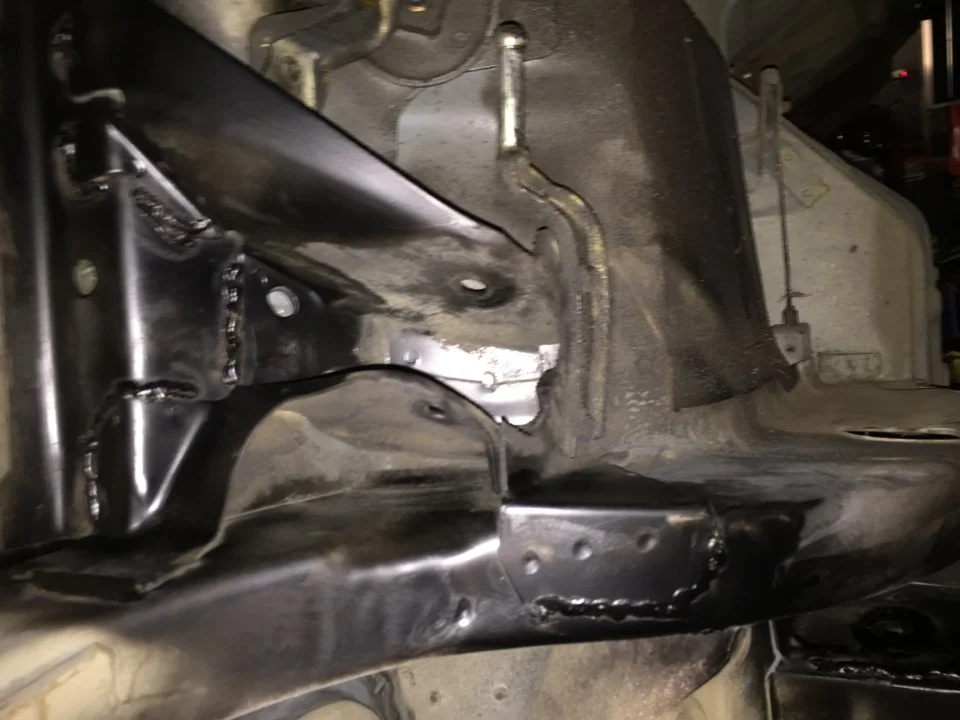

If its swaying that much though its pretty likely the bushings on upper and lowers may be shot, doubt you had enoughpower or poor aftermarket controls arms that would tear your torque boxes..... if you weld, weld the seams on the torque boxes, like so
Yeah man the car lived with pretty much stock power all it's life and the bushings are stock w a million miles on em(Bout 300k). It's time for bushings I know. The tail wag wasn't near as dramatic before the blower. I gotta get sum arms...
