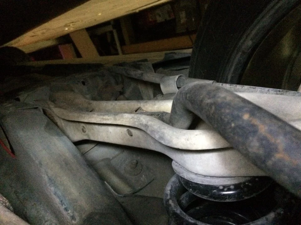

So I was under the car today replacing my rear bandaids and I noticed that the rear swaybar was bolted on the inside of the stock stamped lower control arms. Where does the swaybar bolt to on boxed or tubular aftermarket arms? For some reason my pics keep uploading upside down but yall get the picture.
