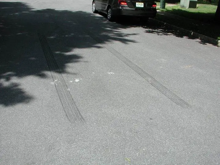

Easy...
1. Hold your foot on the brake.
2. Slam down on the gas until you see a lot of smoke.
3. Get out of the car and look at the street.
If you see two black streaks, your have a locking device.
One other answer is that you could have an Equal-Loc with worn-out clutches. One my car, I can jask up the car and have both wheels spin the same direction. When I do a burnout, however, theres only a mark on the right side. The reason is because I need to replace the clutches inside.
