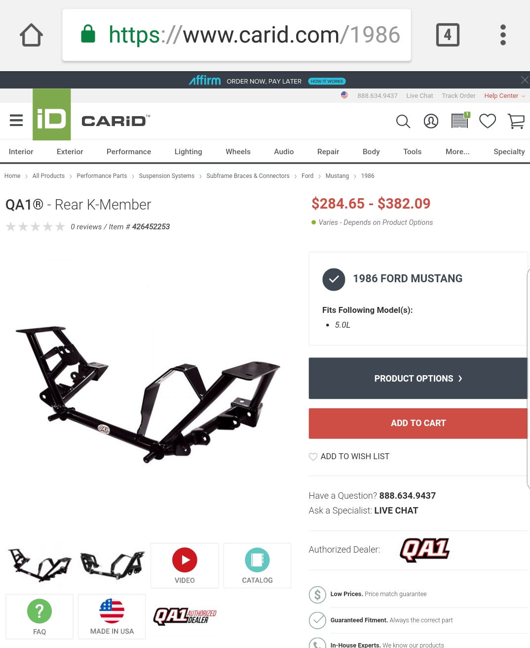

So addiding a Rear k member would help? And of course qa1 coil overs?
The rear does not have a K-member. The front does. A front K-member and coil overs work very well. Ideally a good double adjustable rear shock would be recommended, but a good single adjustable can be made to work as well.

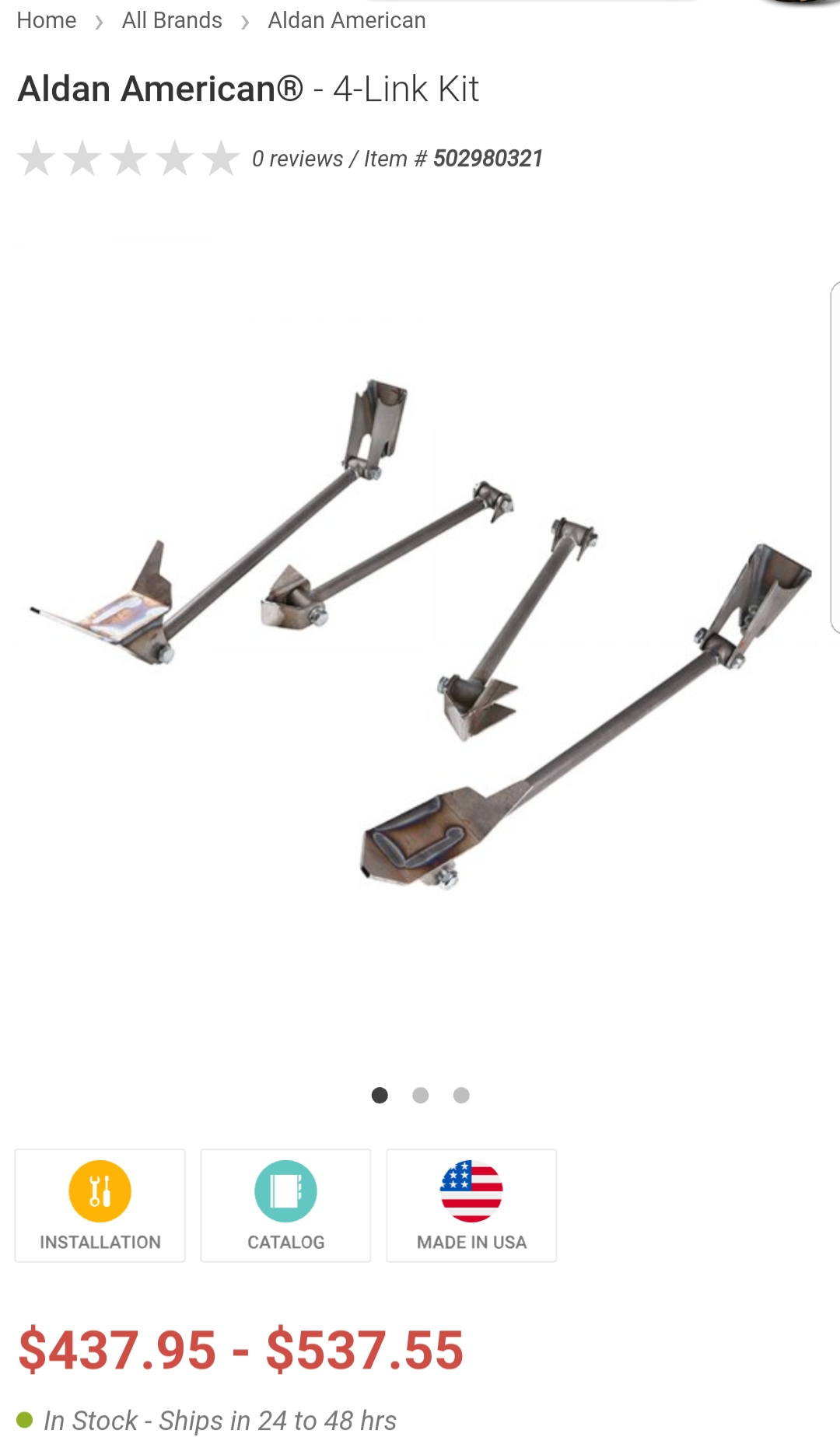

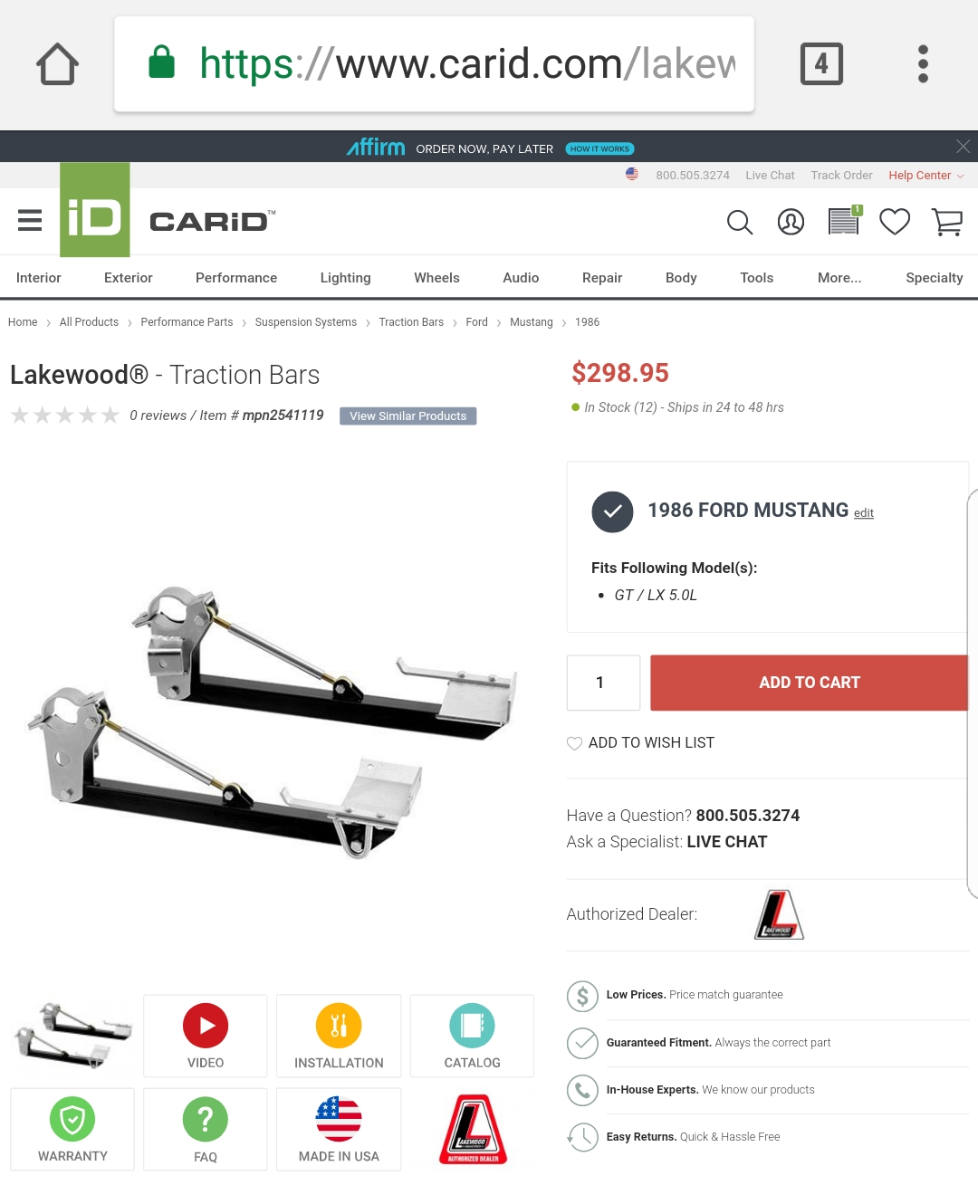

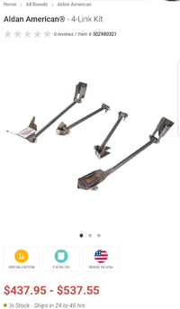

Normal v8 have dual shocks on both sides this only have 1 on each side. I was just going to go with aq1 adjustable coilover. I was also going to go with something like
Traction bars or
Ladder bar crossmember
Ladderbar? I want this rear end to be beefy. Any Thought?

The main one is which is a good choice.
Watts link with 4 link set up is whatt I'm thinking about using. The question is what is ladder bars and traction bars and can they be used as Well? Why or why not
