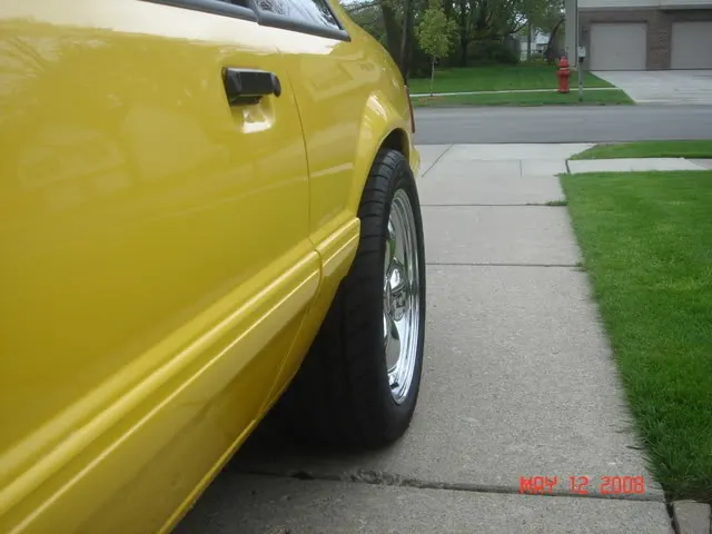

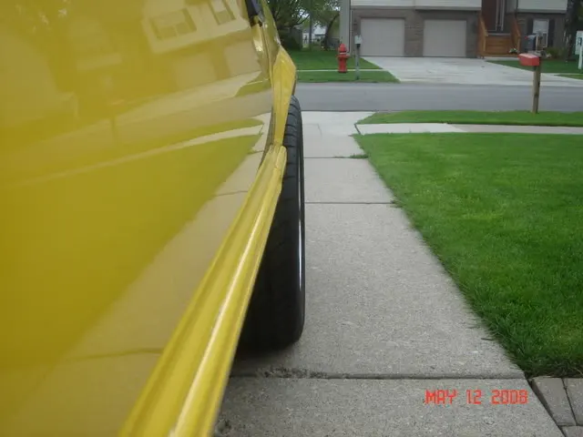

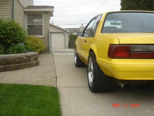

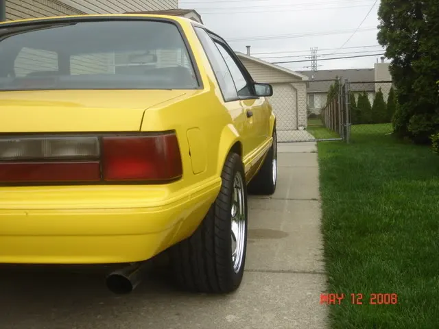

The fix is to run 17X9 +45mm offset wheels from 05+ Mustangs. I ordered those wheels from American Muscle. They sit right at the quarter edge and do not rub on the inner frame rail, nor do they hit the quarters edge.
Here are the pics. These are 17X9, +45mm offset and a 285-40-17 Goodyear F1's. A 275 would sit in a little more so keep that in mind.
