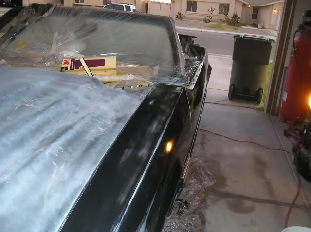

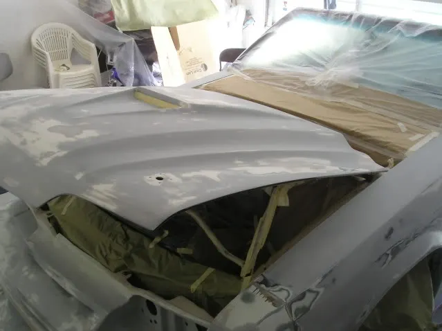

Rear gas tank and front tilt hood pics..
It's refreshing to see some unique idea's taking shape like you've done with your fox
It's tough to stand out at car shows these days, I'm sure you'll have no problems whatsoever in doing just that....EXCELLENT work! :nice:

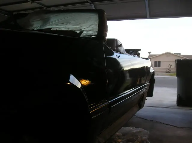

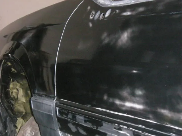

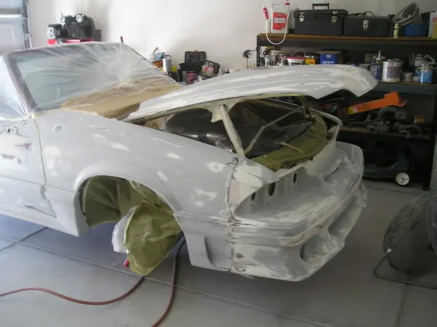

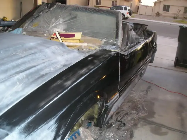

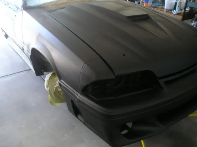

Well guys its been a while since I've done something to my car I been working on it little by little. This week I went to the junk yard to buy my outer trim pieces where the window goes mine where not looking that great..I got them both for 4.05 at the Jy.. Just cleaned them up looks better than the ones I had...Well I keep saying that i'm almost done but then other things come up,,,I reprimered the car this weekend, I want to say this might be the last primer coat I put but I'm thinking one more will be needed,, I just feel like its not right, so I block sand it, then primer then block sand then primer,, I'm getting really close now here some pictures of the stang in black primer.

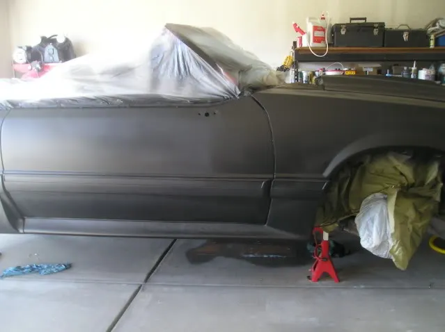

Before the primer....

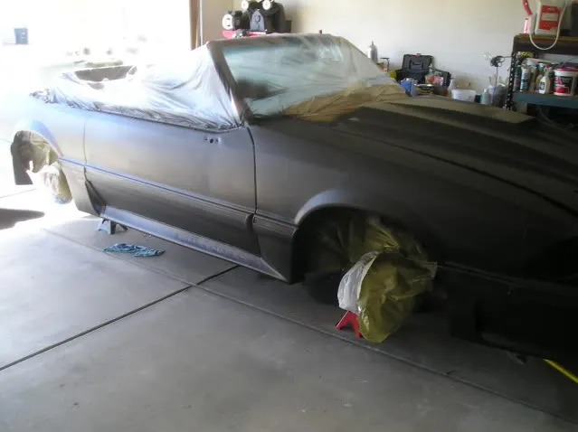

After primer...

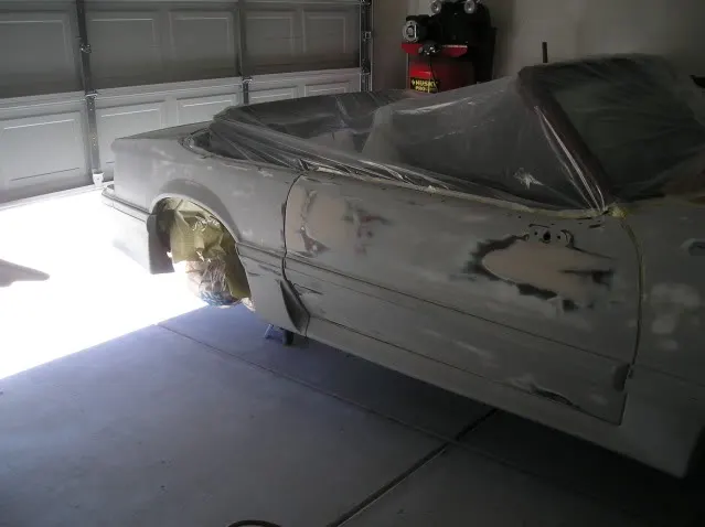

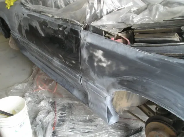

I started sanding the car with a line sander that I bought It kind of helps but its to big for the side of the fenders. It worked great on the doors since it was a bigger area,, well anyways I will post some more pictures tomorrow...

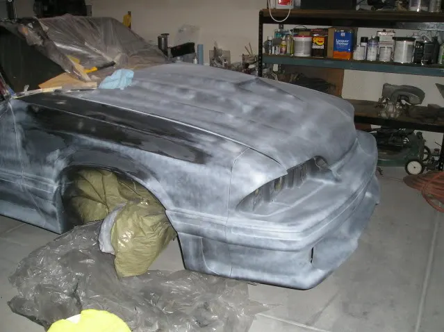

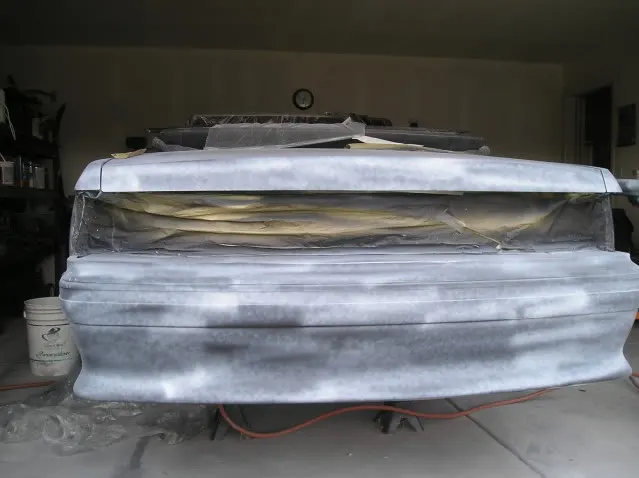

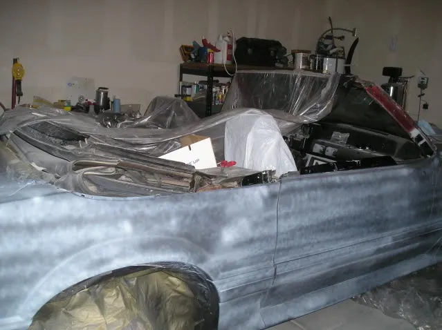

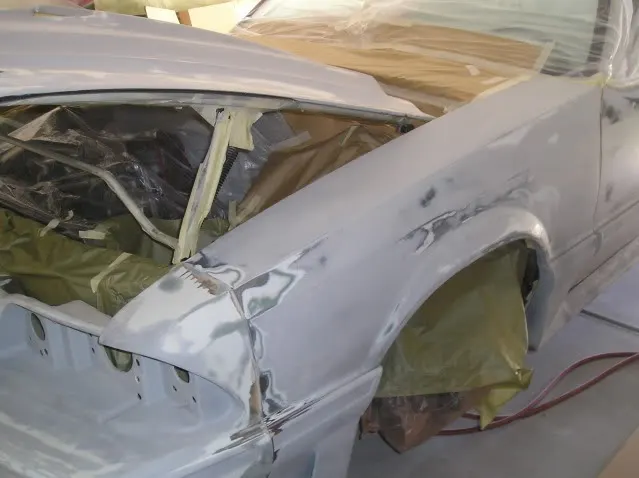

Well heres an update I added a guide coat to the car to do a final block wet sand before i start painting. I tried to align my fenders and door as best as possible. since i took my doors off and fenders.I think they came out straight. so far I've done part of a fender and part off the door...some picts look dark sorry..

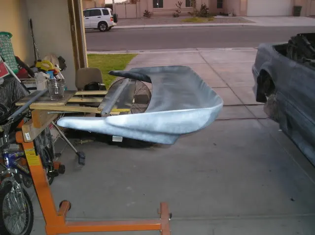

I had an extra engine stand so I riged up this for my wing. I can turn it without touching the wing and get right under it easily
