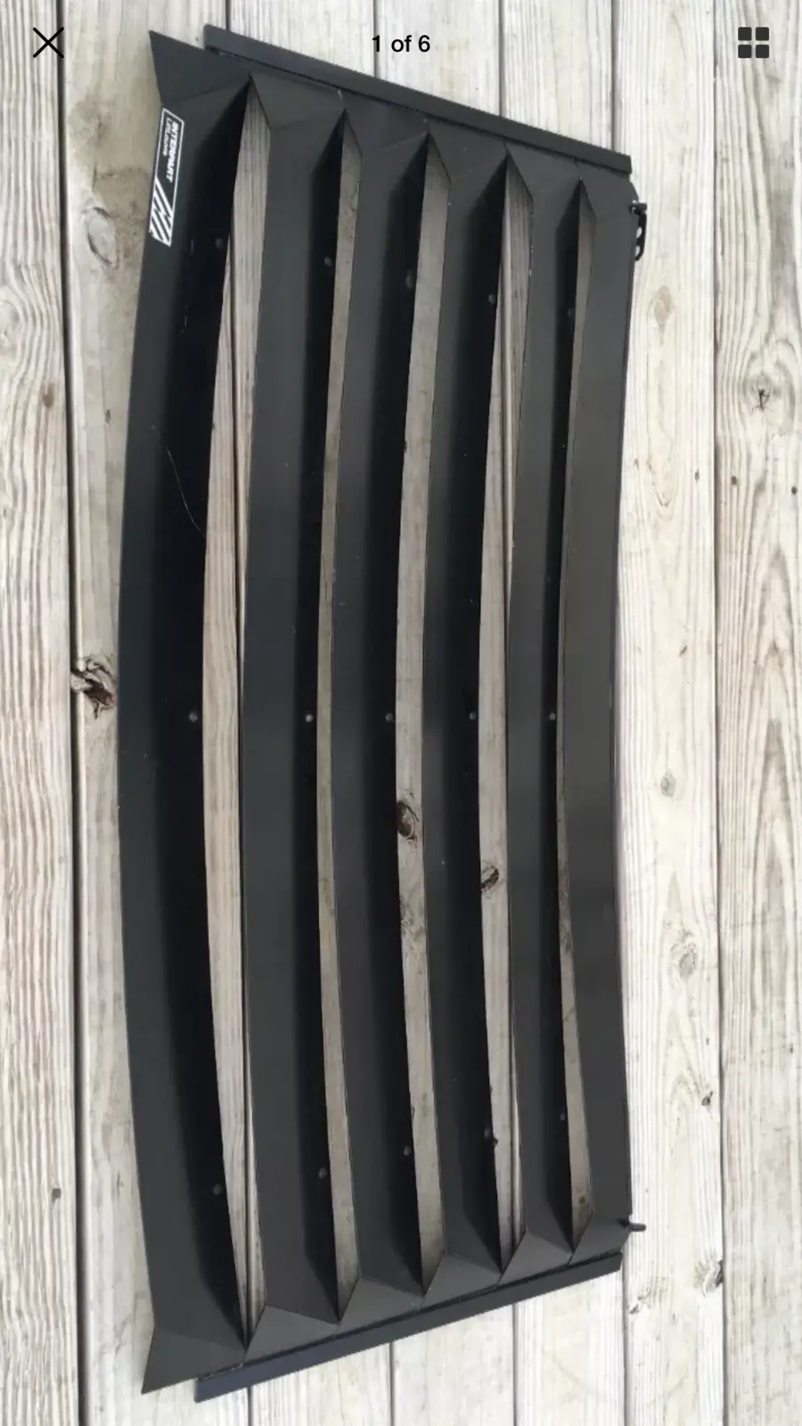

I read somewhere interparts made them in the early 90s, I was wondering if any of the newer companies used the same design, so I could get replacement hardware that’s similar.

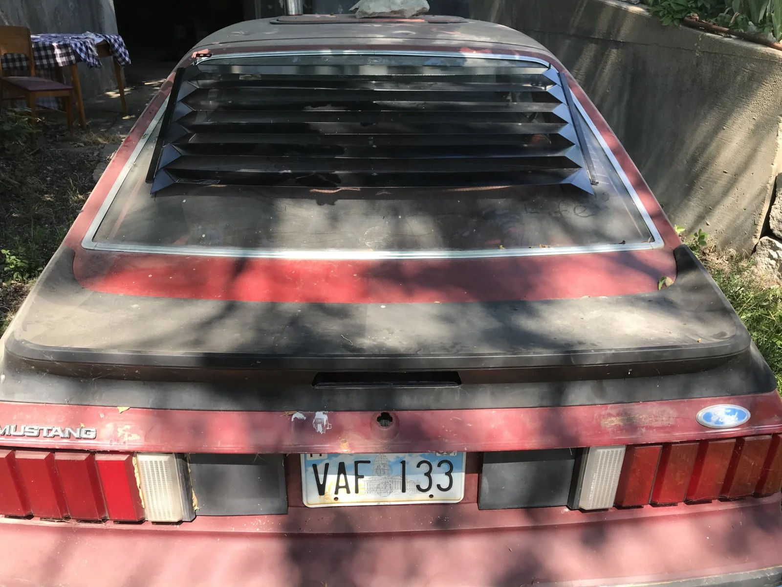

I got the Louvers in today and put them on the back of the mustang. The guy was adamant they came off an 82 Mustang, but they don’t fit. Where there two different body styles for the mustang back then? Like the notch and hatchback in the later years?
That's not for a 79 and up mustang. It's not wide enough to fit a notch rear window. Doesn't look like it'll fit a mustang ii either.
