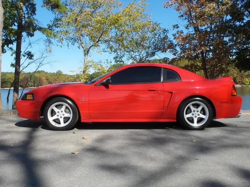

About a year ago I had a Bilstein BTS kit installed, which included all 4 shock/struts and springs... it made a good ride except im still close to 1/4" lower in the rear than the front. It's especially annoying when there's anything additional in the trunk.

It's a little worse now, this was just after install... :nonono:
Nice ride, I have a Rio Red 99 myself:nice: So the kit made your car lower in the rear? I actually had this problem awhile ago but it was because a friend of mine cut the springs too much in the rear. I ended buying springs online for cheap and I'm thinking you may have to do the same. I haven't heard of any larger isolators but if you do find some the rear springs will have to come back out. I find that renting a spring compressor helps out alot. You can search Stangnets site for spring removal or a google search can help
