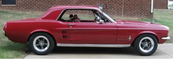

Ok, so you're going with 17"? Here's a couple pics of mine with 15", 1" front drop springs and Shelby/Arning 1" drop (which only lowers it 1/4"?) and 4 1/2 mideye rears. It's actually at 24.5" (not 25.5" as above guessed) F/R within 1/4" of each other if this helps.

your car has the exact stance we are going for. perfect

That red 67 looks great!!
