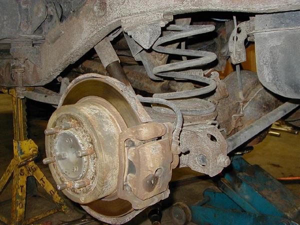

I'm considering various options for my car's rear suspension also.
I transport totalled cars to auction for a living, so I get a chance to look under all different makes and models and see how they're designed.
I'm seriously interested in the ladder bar setup I see on certain types of SUVs.
A large, hollow-tube ladder bar, maybe 3 feet in length, and 1.5" diameter, attaches to the frame with a simple bracket and poly bushings. On the other end, the ladder bar attaches to the axle with a narrow mounting pad and 2 large bolts, fastened to a flat bracket that's welded to the housing. The shocks attach to tabs protruding from the backs of those flat brackets. There's a hollow 1"-1.25" stabilizer bar running from the driver's side frame rail over to the passenger side of the axle housing. (The stabilizer bar is parallel with the housing when the car is at rest.)
There's a crossmember bolted, or welded to the floor pans, connecting the rear frame rails together, and the tops of the coil springs rest in pads welded to that crossmember. The bottom of each spring seats in pads welded to the housing.
It looks to me like I'll be scavenging most of the setup from a junkyard, and then fabricating the crossmember from rectangular tubing. The only thing I'll have to take careful note of, is spring height and shock length.
It seems like a simple setup, that would inhibit rearend wrapup, and it appears to be strong enough for what I need it for.
Anytime I customize something on my car, I try to use stock-type pieces from another production vehicle(preferably Ford), so I'm able to order replacement parts in the future without hassle.
This sounds something like I had in mind and the junk yard option would make it cheaper. The thing I liked about the setup I am checking into is that the front of the ladder bar (sorry I don't know the technical term) hooks into the same mount that the front of the leaf spring attaches to. Please post back if you find a potential vehicle that might be good to rob some parts from.

this setup
Yep, that's the one.
The only thing I may change when I adapt it to my car is using larger diameter tubing for the ladder bars. (I'm thinking during very heavy acceleration with good tires, the stock-sized bars may be forced to bow under compression, and that would be a bad thing)
Is this setup welded to the axle housing or does it bolt on? Would those springs be too heavy?
