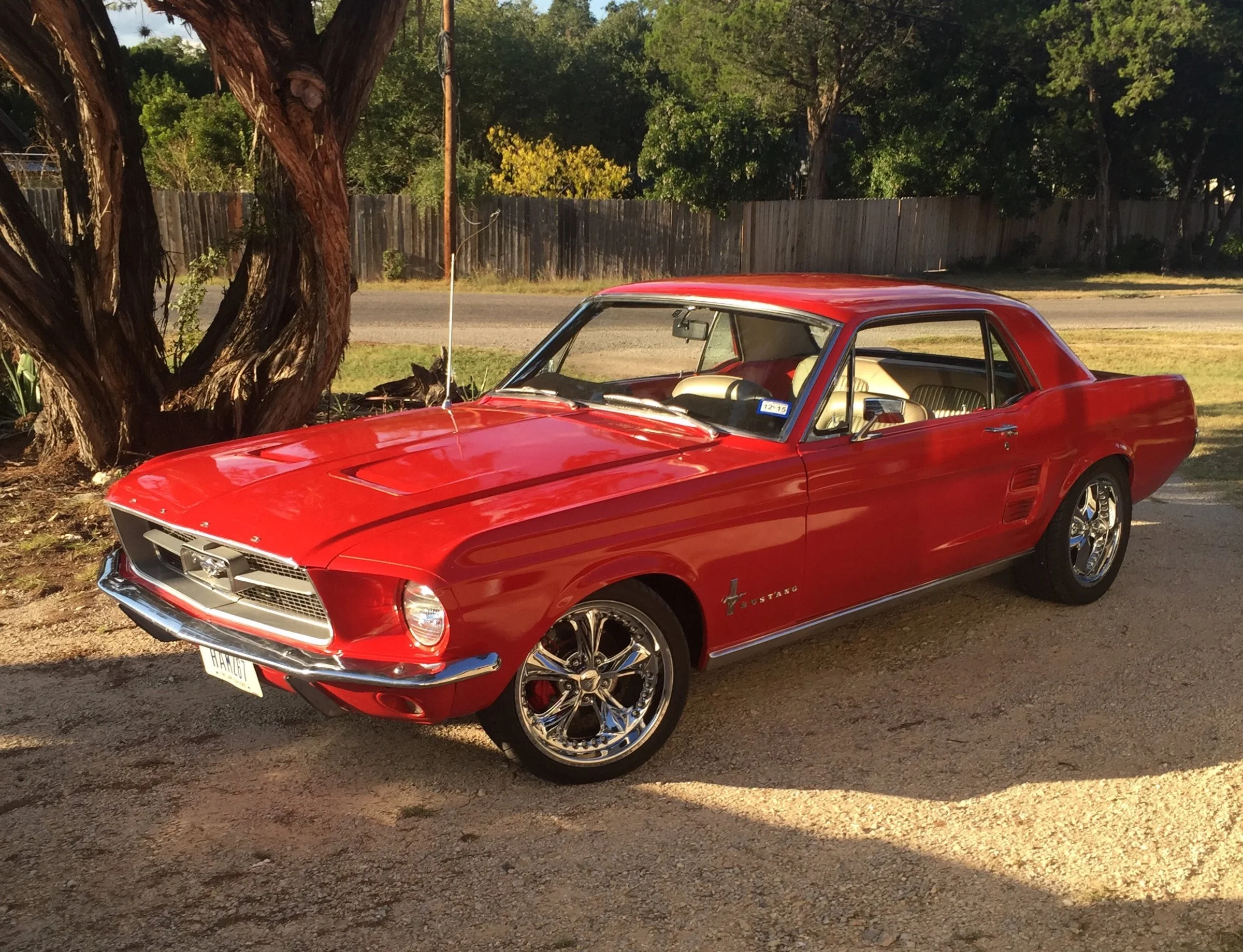

I bought wheels and tires a few years ago and didn't notice major scrapes until I moved from West TX to the Hill country of TX. I researched and went by the chart I found on here for tire figment. I have 17x8, 4.5 backspace, zero offset, and 245/45/17 on back. I replaced the rear soft springs with 4.5 leaf mid-eyes a few years ago too.
My car scrapes at even minor road imperfections and consequently I don't really drive it much anymore because of that. I don't know which steps will fix my problem since I've invested some money in new parts already.
I haven't found anyone yet that can roll the rear fenders and don't really want to change springs again and buy smaller tires. I like the ride height and look but something has to be changed to have a functional car again. Any ideas?

I got the fender roller and it wouldn't fit since my car is lowered even with the suspension drooping as much as it could. The wheel drum is still too close to the fender lip to set the tool up. But I did see that the tires are hitting further up inside the fender well so rolling wouldn't help anyways.
Now I've gotta figure out which option will make me have less issues. Wheels are only available in one other backspace at $250 a wheel. My current BS is 5x4.5. Don't wanna do new springs again since it will give me a big rake. Smaller tires won't have the look I want so I'm gonna take it to the body shop and see what they say.
