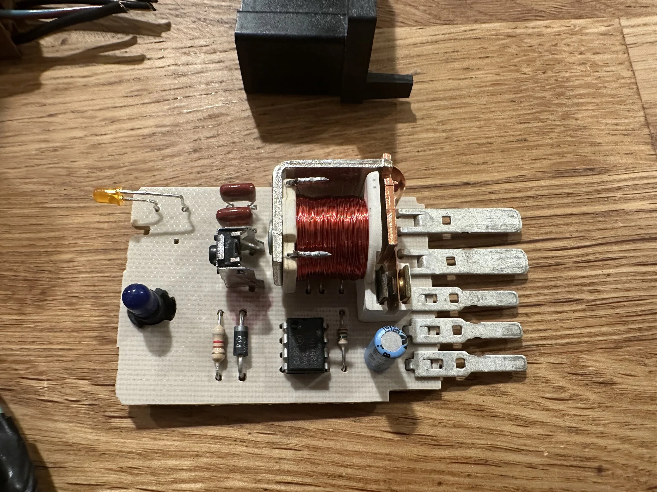

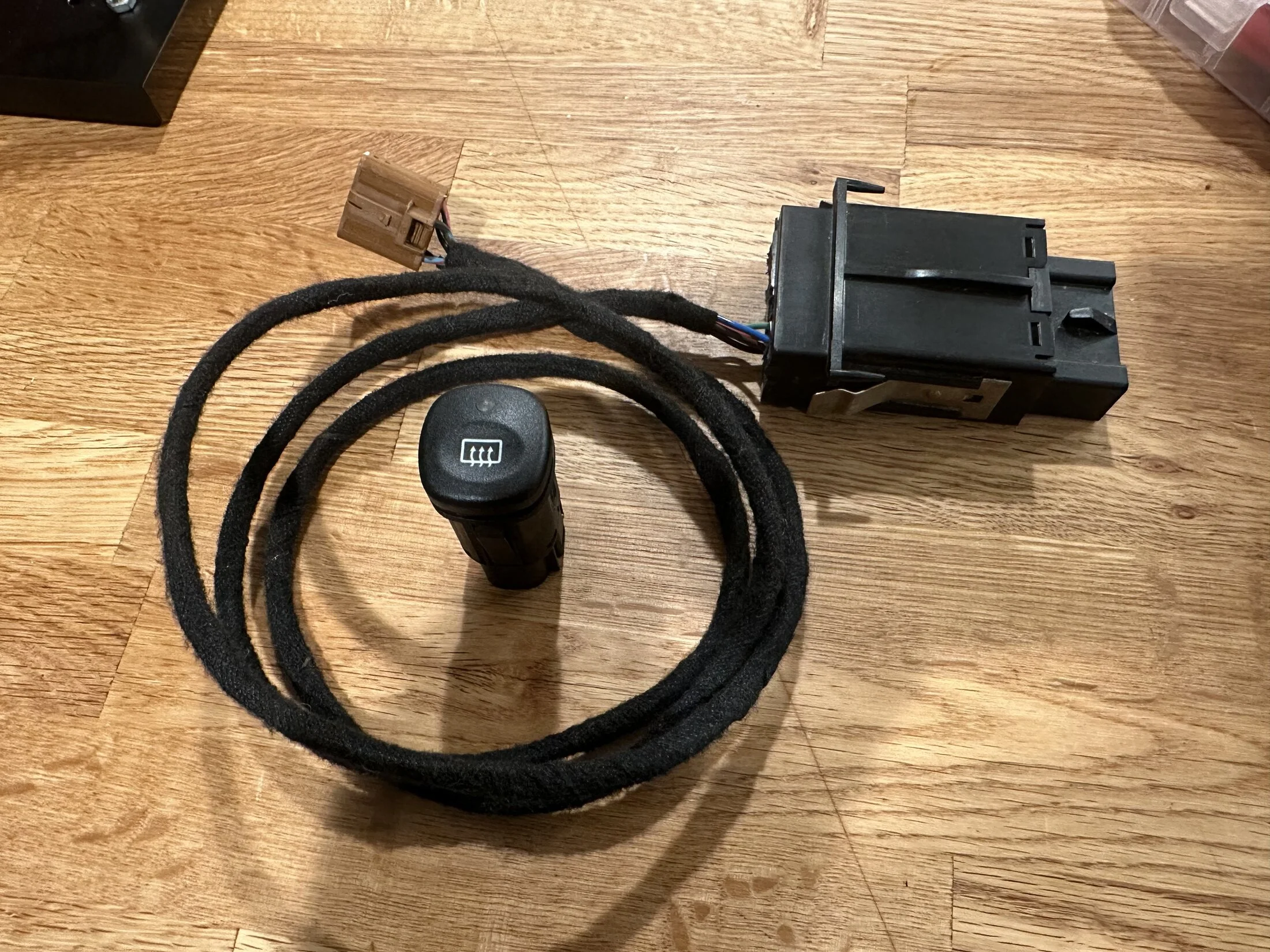

The 94-00 defrost switch has an jnternal relay as part of the switch. The 01-04 switch activates an external relay. What I did was just extend wires from the 01+ switch out to the relay on the 94-00 switch and removed the push button components.

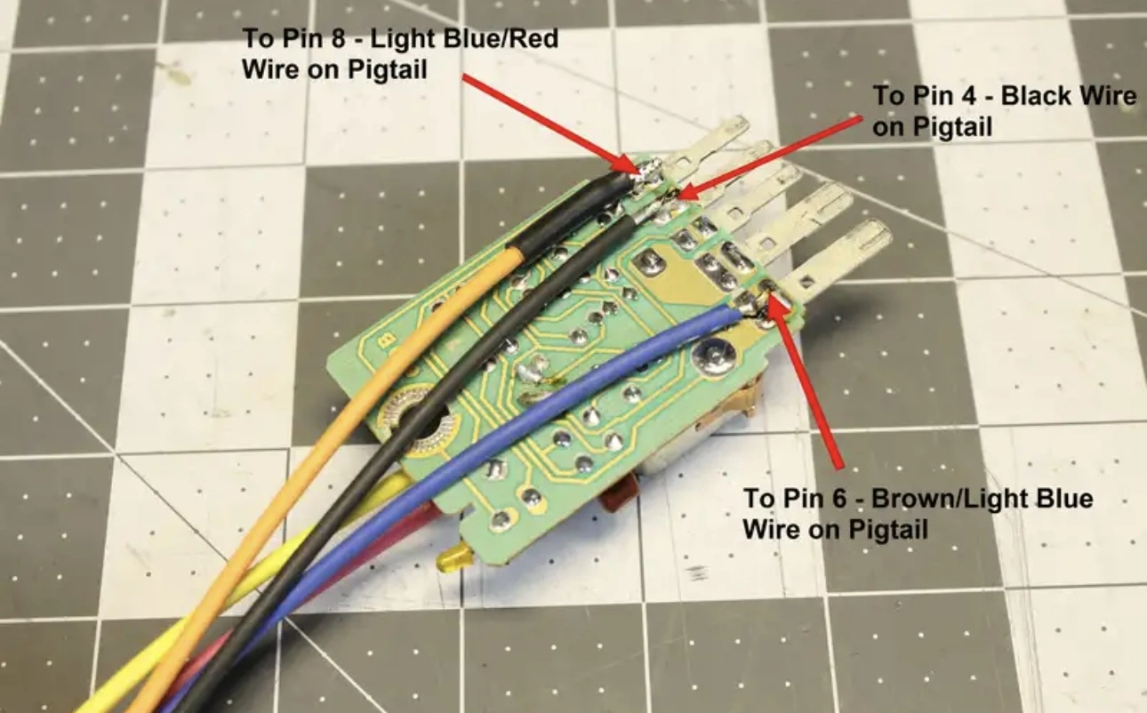

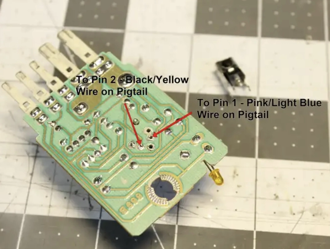

I followed the write-up
I removed the push button and yellow LED from the original switch and soldered wires onto the correct leads to extend down to the newer button.
Here’s what’s inside the 94-00 switch. The yellow LED, push button and blue bulb get removed and the housing trimmed.
And in case the above link doesn’t work, here is where you are extending wires from
