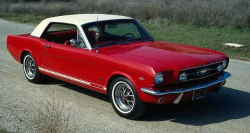

Also, what is the backspace on stock wheels like these?
* Not my car, found it on google images.

I do not know the back space for rally rims, or if there is a difference between the early rally rims or later model Rally rims.
