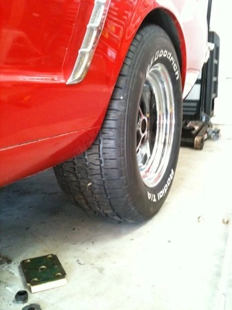

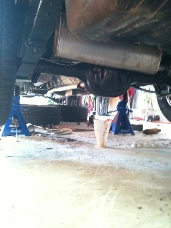

Narrowed 9" installed. Shortened half inch over stock on each side with custom axles from strange engineering. 245/60/15's on 15x8 magnum 500's. Springs and shackles are from summit racing. Bottom plates are from a 67 mustang, to fit the 3" ubolt. Shocks are basic motorcraft from NPD.
