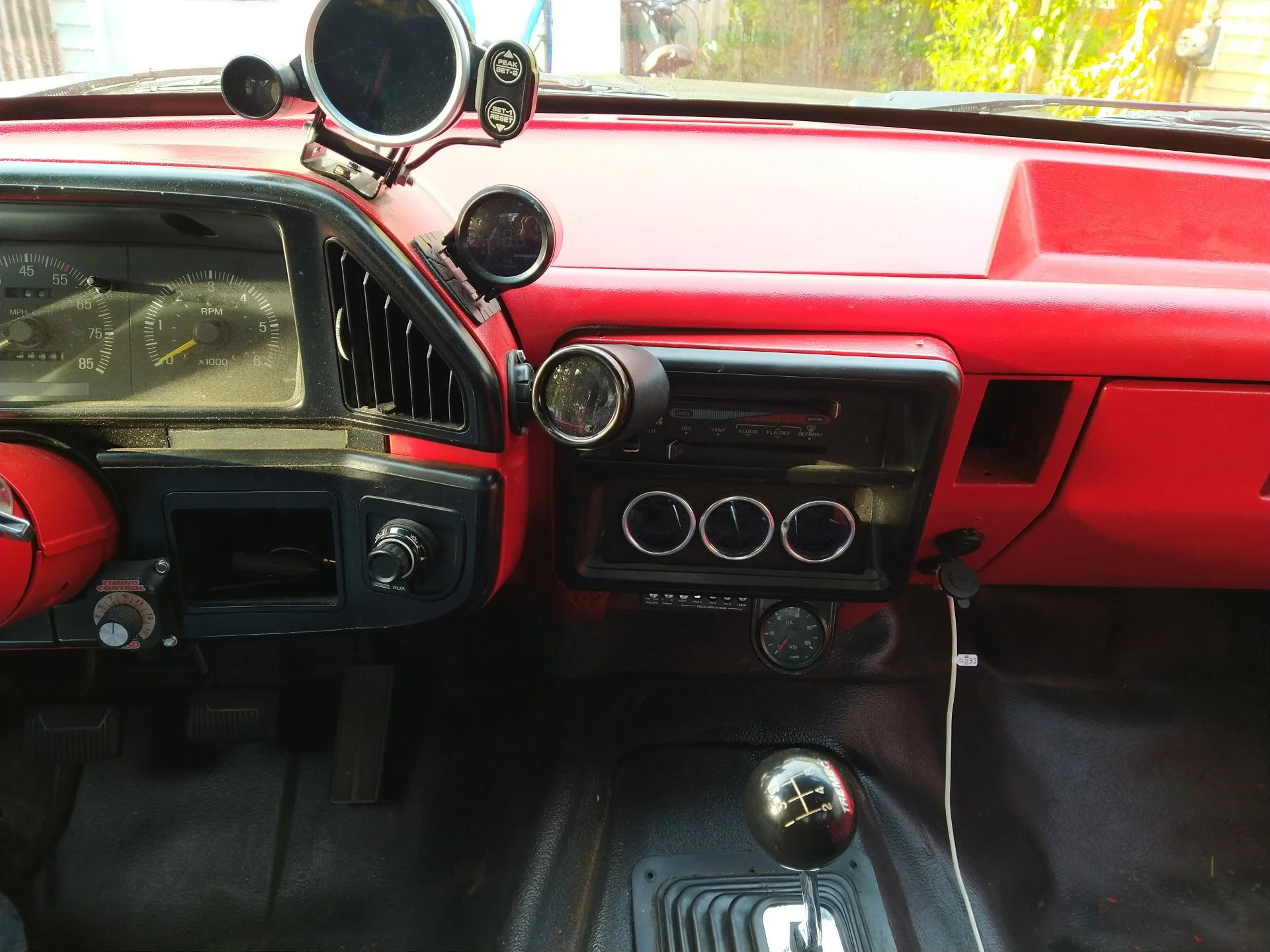

When I totalled out my Razor Side By side I took the HiFonics Radio out of it...Its very small and can fit just about anywhere....
A couple months later when I was looking for a cheap amplifier I ran across the same units being sold on Amazon for $60..
Amazon product ASIN B073YDKDBBView: https://www.amazon.com/Hifonics-TPS-BT1-Bluetooth-Pre-Amp-Controller/dp/B073YDKDBB/ref=sr_1_2?crid=1P8QE33TCKK3Q&keywords=hifonics+bluetooth+controller&qid=1669754867&sprefix=hifonics+bluetooth%2Caps%2C198&sr=8-2&ufe=app_do%3Aamzn1.fos.006c50ae-5d4c-4777-9bc0-4513d670b6bc
I also have a passive EQ to shape the sound too.........Everything is controlled by a single joystick style knob...You can advance and go back on the music tracks by pushing the stick right and left...volume is a twist and theres an AUX jack plus remote turnon wire and 2 rcs jacks
You can turn the radio space into a gauge pod area.......LOL
They also have amplifiers with built-in bluetooth and you can eliminate the headdeck and a spot to mount the radio all together...

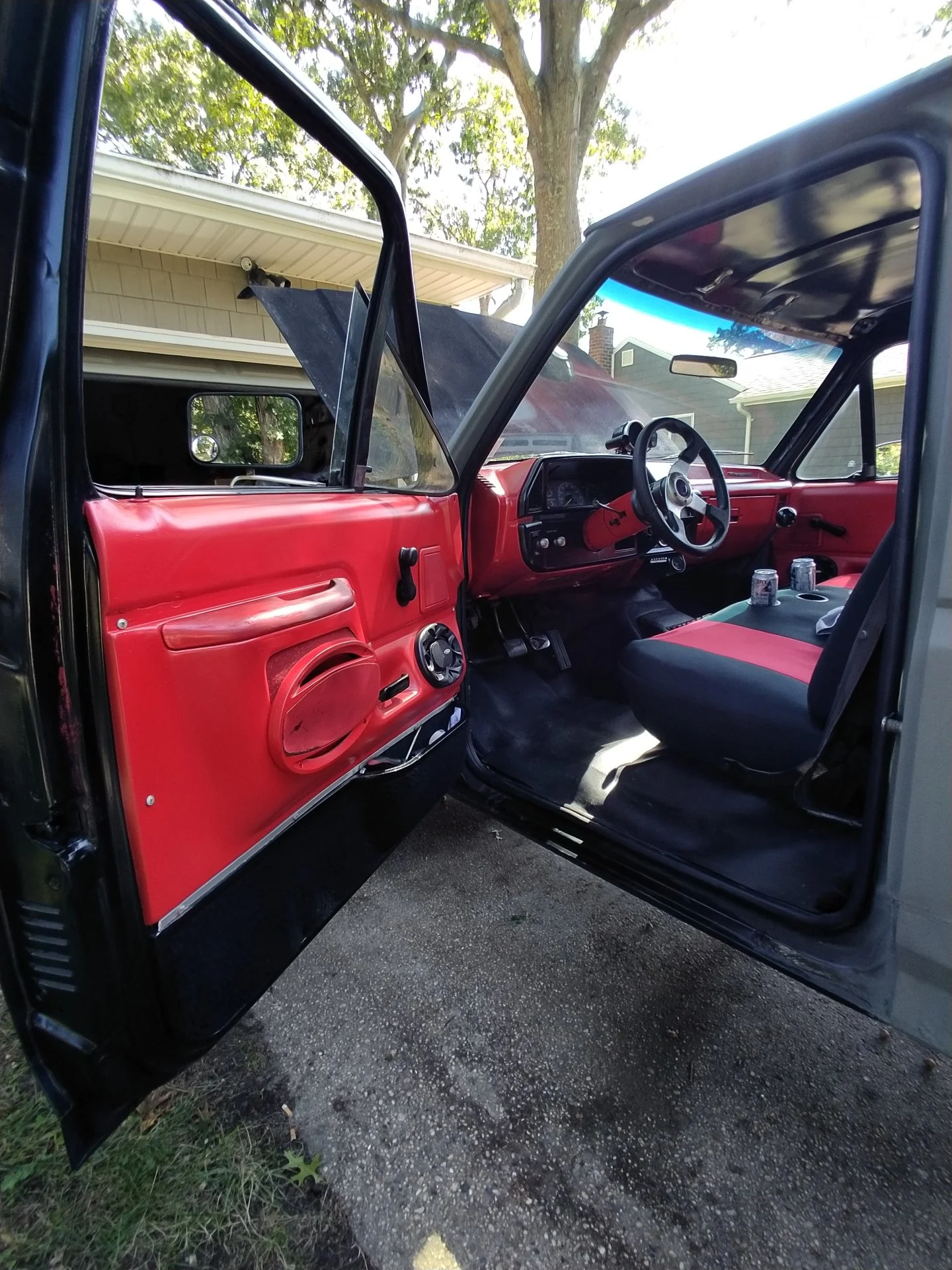

I have the non bluetooth 1500 watt version...Im not looking to blow my ears out so I have the gain cut to 1/3 and the sound is killer with an 8 speaker sound system hooked 4x4 in each door hooked up in both parallel and in series per each side to keep it 2 ohms stable on only 2 channels w/2 self amplified 600 watt subs under the bench seat filling in the bump..LOL
