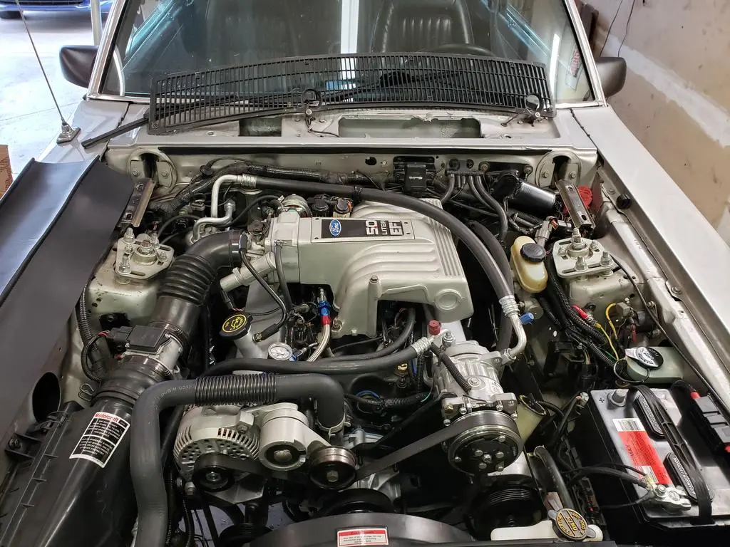

Hey, I'm doing fine. Got the car all put together. I had my friend come and put the valvetrain together for me. Ran the engine, and had it overheat on me because I did something wrong with the fan controller. I had been trying to burp the cooling system at the time and has a "no spill" funnel in the radiator cap. It made for a very nice nozzle to spray hot coolant all over my garage wall and extra parts shelf. Fixed that. Next, I found out I forgot the rear main seal. At a glance, it was hard to tell if there was one there or not. Never having dealt with them, and having so many other things to worry about over the whole process, it just got missed. After cleaning up another pretty massive mess, I pulled the trans back out and got that fixed. Decided to renew the clutch as long as I was *back* in there. Started the car, no oil pressure. Turns out the gauge wire just needed wiggling. That's alright, I needed that heart attack. Anyway, that pretty much brings us to now.
I've run it a few more times since then, trying to get the timing right. Still don't really know where I should be with it, considering undetermined increased compression over stock and running 91 octane. Took it for a couple of rides, and it feels strong. It started making a ticking noise this last time, so I asked my friend to come back and have a look, but he hasn't had the time. I'm thinking a rocker probably just needs readjusting or something. Not concerned yet.

Hey, good to hear from you.
Car is okay. I finished with my spring projects, or I guess what I mean is, the car is assembled at the moment. Spring projects were, converting the 1990 automatic wire harness to manual, trying to get the new clutch properly adjusted, and adding a wideband O2 sensor.
I had to take a few things apart to do those things, and since doing them, the car will not idle. It rolls a good 1000 rpm up and down and likes to stall. This could have something to do with the fact that I connected pin 30 so that the ECU should know that the car is in neutral via the switches at the clutch pedal and transmission. Although, I did run this '93 Cobra computer briefly last year with the harness in the auto configuration, which sends voltage through that circuit, rather than simply grounding it (oops), which is what the manual configuration is meant to do. I'm told if that voltage caused damage, the ECU wouldn't function at all, but I don't really know for sure. Other than that, I'm not sure whether the distributor is lined up correctly or off a tooth. I have the timing set at about 20 degrees BTDC, and am running 91 octane non-oxy fuel.
Also, the clutch doesn't seem to want to operate properly. Every single piece of that system is new except the input shaft and clutch pedal. But it will slowly slide out of gear when I'm cruising in 5th. And the stupid shifter is hard to put into gear. So, in theory it isn't engaging OR disengaging all the way for all the sense that that makes.
It's always something with this damn car. The ticking seems to have gone away on its own though, so that's good.

Hi,
Geez, sorry this is fighting you, but nothing good ever comes easy. I’ll help you reach the end, you’re running the KR Cam- correct?
Ever get a tune for this or still running the stock EEC’s programming?
Wideband 02 Sensor you’re installing for monitoring Air/Fuel ratio, correct?
First, your base timing (Set by rotating Dizzy)is set at 20 degrees? Almost sounds like the SPOUT (which interrupts the EEC from controlling timing) is connected for the EEC to add more timing on top of what your base timing is both at idle and while RPM’s rise when driving it- so seeing timing is at 20 degrees, shows your light is picking up the EEC is adding on top of what base is set at.
When setting timing- SPOUT is always removed, base timing by setting the Dizzy should be set at between 10-14 degrees, SPOUT then reinstalled for the EEC to add- or pull timing.
The PIP in your Dizzy sends a signal to the EEC, EEC takes that Date, which includes injector timing, applies its programming & Sensory data, and sends a signal to the TFI, which advances & retards timing as needed.
Is the #1 Plug wire landed on the cap in the correct spot? If not, the injector timing will not be lined up with spark timing. Some Dizzy Cap’s (like OE) have a spot marked & intended for #1 Cyl, others have the 1/2” black colored cap on the Dizzy.
What ID is your EEC? A9L? You can generally utilize a M/T or Auto Trans and dial that I’m with these EEC’s. The other way around is more challenging & Sometimes it may be a PITA, what EEC Codes have been thrown that you retrieved, don’t forget- there may be codes you’re not seeing, extracting them is necessary, a few issues may show no code at all, until you pull them.
Very easy to do, a paper clip and pen & pad will do the trick. If you haven’t yet done this, no pro
BTW, Lifters May acquire a “”tick’ when in a newer motor, this is a normal result of small pieces that are within the oil & created during break-in. They may clear themselves, or sometimes more aggressive means.
Your Clutch as I recall was re-Re-installed with a 2nd new one when you’d pulled the Transmission to get the rear main seal. Did you buy a firewall cable adjuster, a new clutch quadrant(or running the self adjusting OE plastic setup), and adjustable cable by chance?
New Clutches also require a gentle break-in for a few 100 mi+, if the clutch was hit terribly hard, I.e. Burnout clutch dumping, etc. it may glaze over the disc, but issues most generally are associated with it’s adjustment.
A dimes width on preload so the TOBearing is contacting clutch fingers...
Will look for your response, Best we hit one system at a time so it’s less likely to confuse, like reading a Map, instead of looking at the whole thing, look at the Town you’re seeking, it’s a Marathon, not a quick race.
I’ll help you as long as needed to get these identified and worked out.
Have you checked all your valves to verify none were adjusted too tight? This can usually be evident in a compression test.
The OBD-1 EEC has what’s coined as a Cylinder balance test, it’s a self Diagnostic test that will tell you quickly how the output of each cylinder, ID’ing “weak” cylinders. Is built into the EEC, so it is a self test you initiate, car runs through the paces.

The EEC is an X3Z '93 Cobra unit. I have a 70mm Cobra MAF to go with it.
The car does start and run, just not well. I'll save the clutch feedback for after we fix this, haha.
