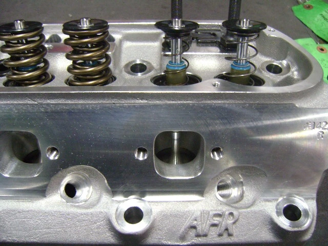

ya man...im watching this thread too,i read about the springs before i got my engine built and told the guy to upgrade them...definetly dont want it to granade like your,that sucks man....went through the build pics,this is only one i got with the heads apart that seems like he did somthing anyway?
