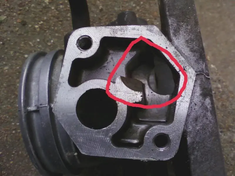

Never had any issues with my BBK, other than the whistle LOL...
BTW, how do I fix the whistle???
I dont have one myself but from what I read, the BBK TB has an edged corner in or around the IAC area and the turbulent air cuts against the edge and makes the famous whistle. I have a pic of a stocker, take your IAC off and see whats different and dremel it. :shrug:
