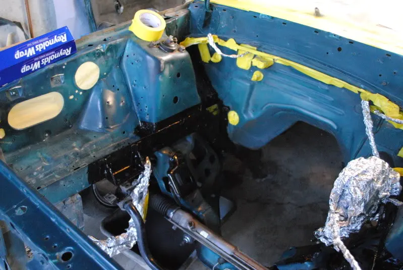

Thanks, guys. The rust isn't as bad as I thought it was. It's real solid still, just seems like heavy surface rust; it doesn't crunch when pushing hard with a screw driver.

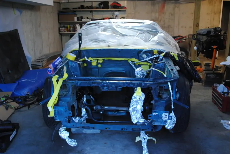

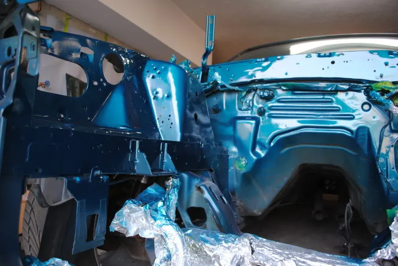

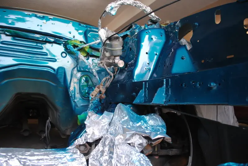

Well this weekend looked like the last of warm weather for awhile. Saturday I did all the POR-15 stuff and finished masking. Today I did a lot of scuffing and wax/degreasing. Then did a coat of sealer followed by base and clear coat. The pictures don't do any justice, it turned out great. I did it out in the driveway like a redneck! Surprising I didn't pick up any dirt.

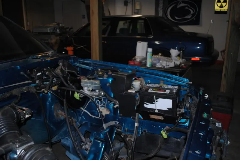

I finally got my '93 Cobra booster to fit it, I ended up elongating the top left firewall hole. I also have been doing a lot of cleaning and installing all the firewall/support stuff.
So I was planning to run a TFS stage 1 cam, but I was looking at Comp cams and was wondering if the Xe270hr-14 would be better. I'm wanting a Vortech in the future and heard that 114 degrees is better for boost.

The bay is filled!
Got these babies from Ford!
