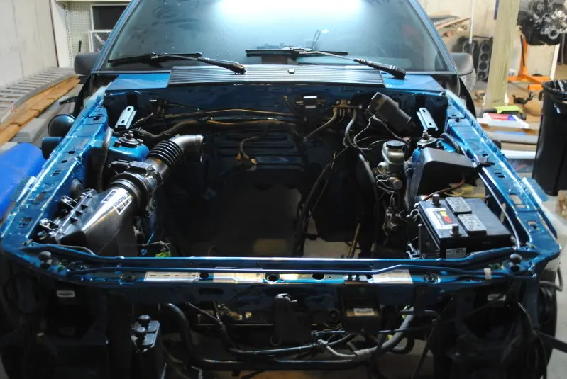

ReefBlueHatch's Progress Thread

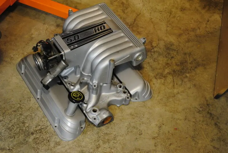

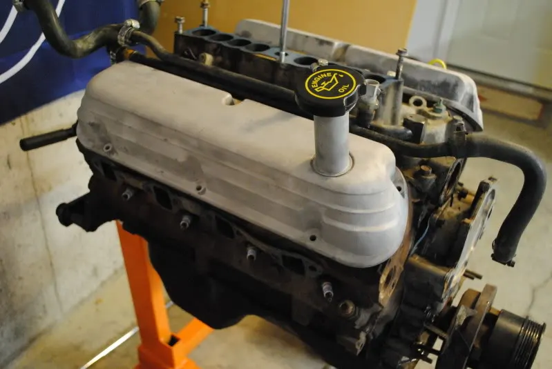

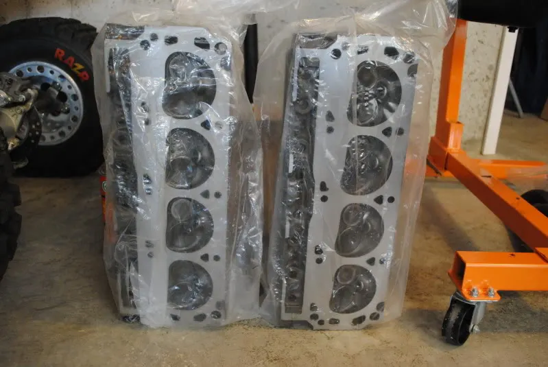

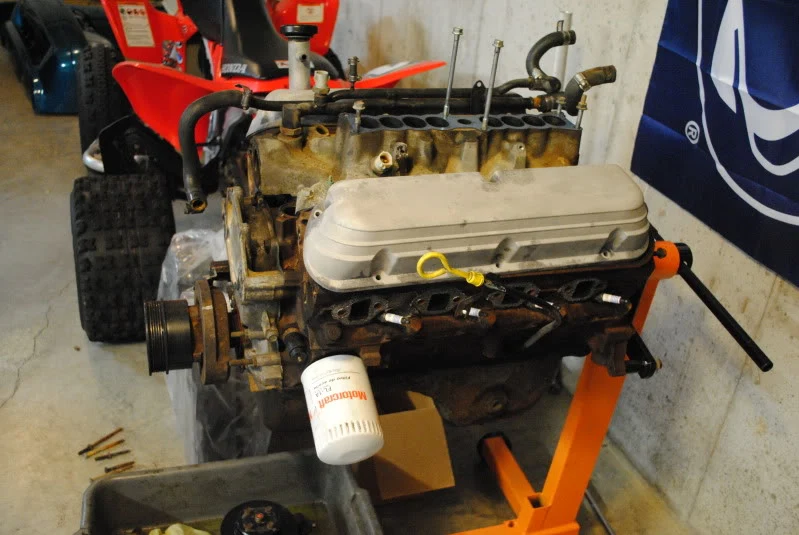

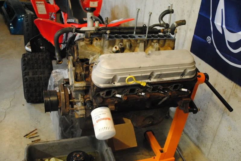

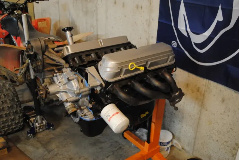

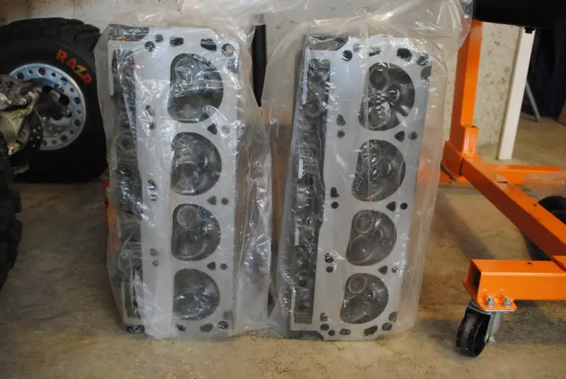

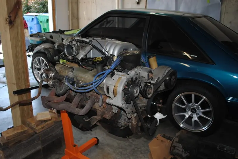

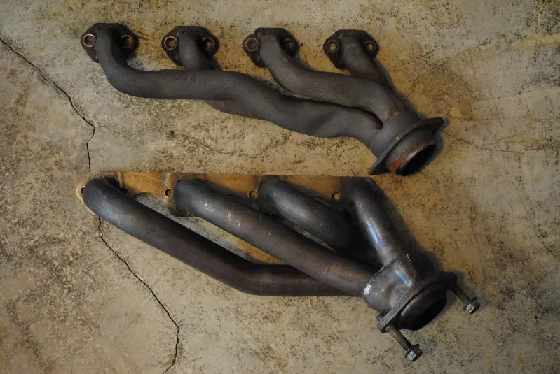

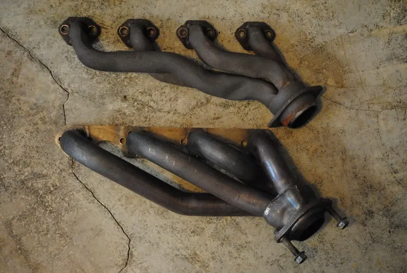

With the bay finished, I started tearing into the motor. I finally got my heads back from the machine shop. Friday I bought a set of FRPP shortys with 500 miles on 'em from CL for $175. Yesterday I did some sandblasting on accessories brackets and valve covers (after a lot of Tail Strip II).

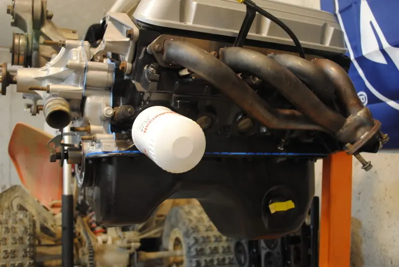

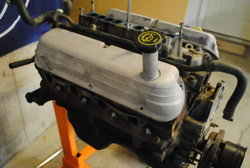

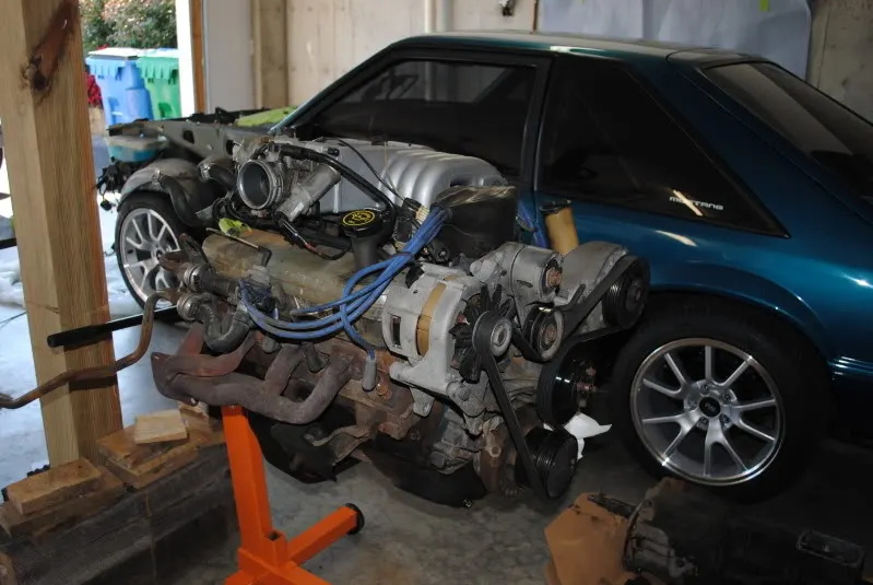

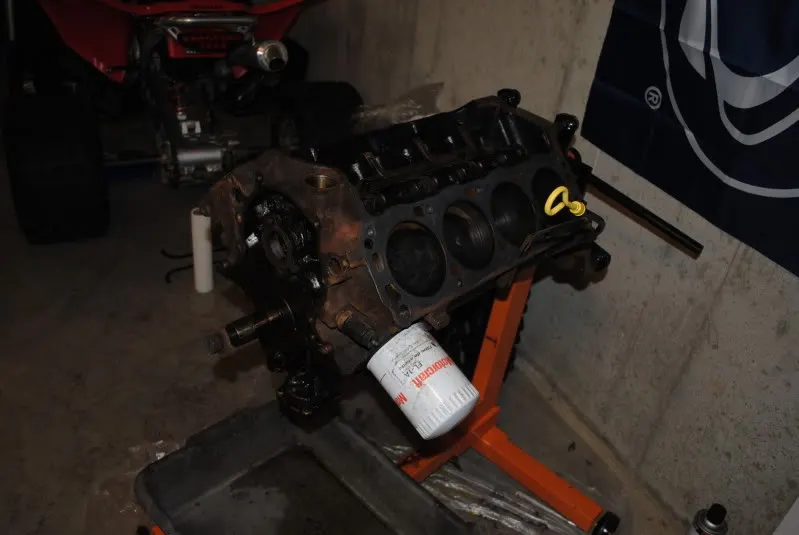

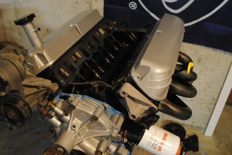

Well it's been awhile since an update. I've been busy getting the engine back together, painting, blah blah blah... I'm sick of working on this thing!

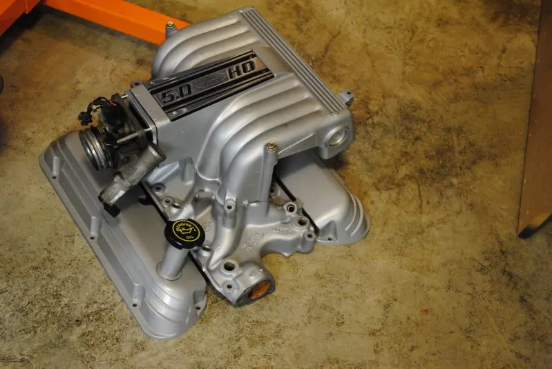

The doors have new pins, bushings, rollers, spring tensioners, and strikers. It amazing to have doors that stay open and shut solid. I also put in new courtesy light switches. In the hatch I finally bought a spare tire cover and the mushroom and wing nuts that hold up the cargo net. A friend who does porting is working on the lower intake, so I'm hoping to get the engine down in the car in two weeks.
The sludge was the worst in the valley. I did a lot of scraping and then brushed a lot of parts cleaner. The PCV screen was clogged horribly. Then down in the bottom end the pickup time had a bad kink that almost pinched it shut. I installed a new OEM oil pump and pickup tube for good measure.
