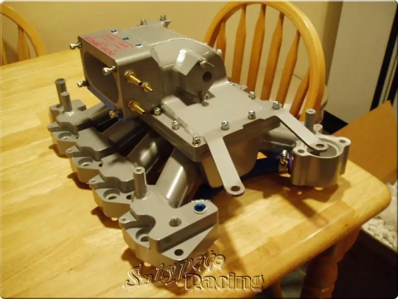

Well my intake showed up while I was away, first thing I did was open it up and take some pictures.....
For the full write up (some might find it very interesting...) and the pictures :
Reichard Intake Write Up

Great purchase if the minor bugs are worked out or don't turn into major ones. I guess Reichard can listen to it's customers and maybe resoleve some of these issues.
That's my hope....why I always try to be fair and honest in my write ups.
For me it was more of a necessity, I don't think the stock plastic intake would live a happy life when real boost is put through it this summer....
sure looks nice.
Hopefully none of the small issues are big problems.
What kinds of gains does it advertise, and for what applications ? N/A, s/c, turbo etc...
see pm

From what I've seen in the mags, it doesn't help alot. Most of the reviews I have seen have been N/A. It looks like it would be a good manifold for blowers tho'. Forced induction would make up for the intake velocity lost by the short runners. I also think forged internals would make the high rpms necessary more "survivable".
I look forward to a true OBJECTIVE review.
Just my two.
There haven't been any reviews of the v2.0 intake - everything that has been posted was based upon the v1.0 intake.
There was one review in a mag that used a NA car - why??? A short runner intake is not setup for a NA car, it is setup for a FI car.
The v1.0 was tested on a SC car - there was low end hp/tq loss, but major gains on the top end (~53rwhp) over a Bullitt intake...imagine it over a stock intake. The v2.0 is supposed to cut the losses in half according to Jim.
There are a few SC cars that have the v2.0 on now that are getting ready to do some testing so we should see some real world numbers. Myself and Sizz will also have numbers on turbocharged applications - however neither of us will have 'before' numbers with the same setup since we're both doing full motors (him cobra crank, stage 3 heads - me 302ci stroker, stage 2 heads).
For a NA car, get a Fox Lake intake, or if you don't like the looks - wait to see what BBK brings to market....

Update :
Had a nice conversation with Jim Reichard today, here is a summary :
Pin Holes : He is fully aware of them. Like I suspected/hoped, they are BELOW the injector O-ring so it is a non-issue (which I confirmed with the angry germans the other night, but it was good to hear Jim say the same thing). The reason for them (as stated by Jim) is to allow the injector to sit as low as possible to increase hp/tq.
As for the transfer between the runners, it was exactly what I stated...some hand cleaning would clean it up - Jim said he could gladly do it for an additional fee if it truly bothered some people and they didn't have the capability of doing it.... But like I stated, you'll need to do some hand cleaning on any manifold.
For those that have stated they feel the intake costs too much, you'll be happy to know Reichard still hasn't recouped the investment cost - and actually just invested more money into the fabrication stage - and it will take at least two more batches for him to break even/turn a profit.
