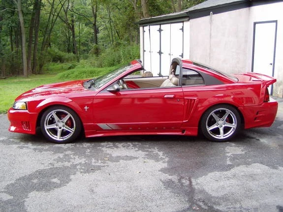

Like this?
There are a bunch of them on Google
It really messes up the structural integrity of having a coupe. If I wanted that, I would probably start with a convertible. Just an idea.
Good tip. I'm pretty sure that there was a limited run of 95 cobras that came with a completely removable hardtop roof, so it's entirely possible to start with a vert and make a targa car with it. I'd source the new top from an old v6, considering the 94-04 all had the same upper roof structure. I'm pretty sure the A pillar is little different though in the vert models, but either way you're going to have to (or find something that's willing to) do some seriously good fab work.
