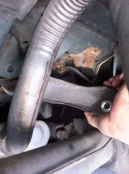

Like Green mentioned we got the busing completely out, just the sleeve left. Since the MM tool won't work without the bushing present we will need to chisel or cut the sleeve out. The other side we will just use the tool when it arrives. Those axle ears are pretty thin to be heating up and bang out.

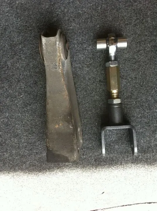

Here are some pics.

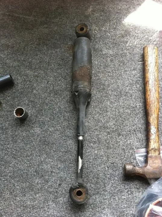

How wasted are these quad shocks? They haven't been doing anything in years except adding weight.

I have always been reluctant to remove parts put there by the factory just on someone's word that they are unnecessary. That being said, Dave Zimmerman told me that with the sperical/solid bushings all around out back that the quad shocks are not needed. With his experience backing that statement I am will ing to give it a shot, especially being that it will save me some cash. I have read very mixed results with quad shock removal from people with every type of stock style suspension imaginable, so we will see. Maybe I will get lucky, and maybe a new set of quad shocks will be on the way in a couple weeks.
Those quad shocks haven't helped axle hop in 10+ years. They are completely trashed, the bushings are dry rotted.
