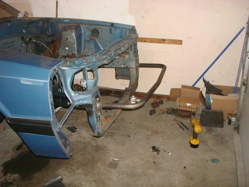

found this on PennMustangs.com. There's a guy making these in cromoly. supposed to save a good bit of weight
i have none of the bumper support stuff and no sag
