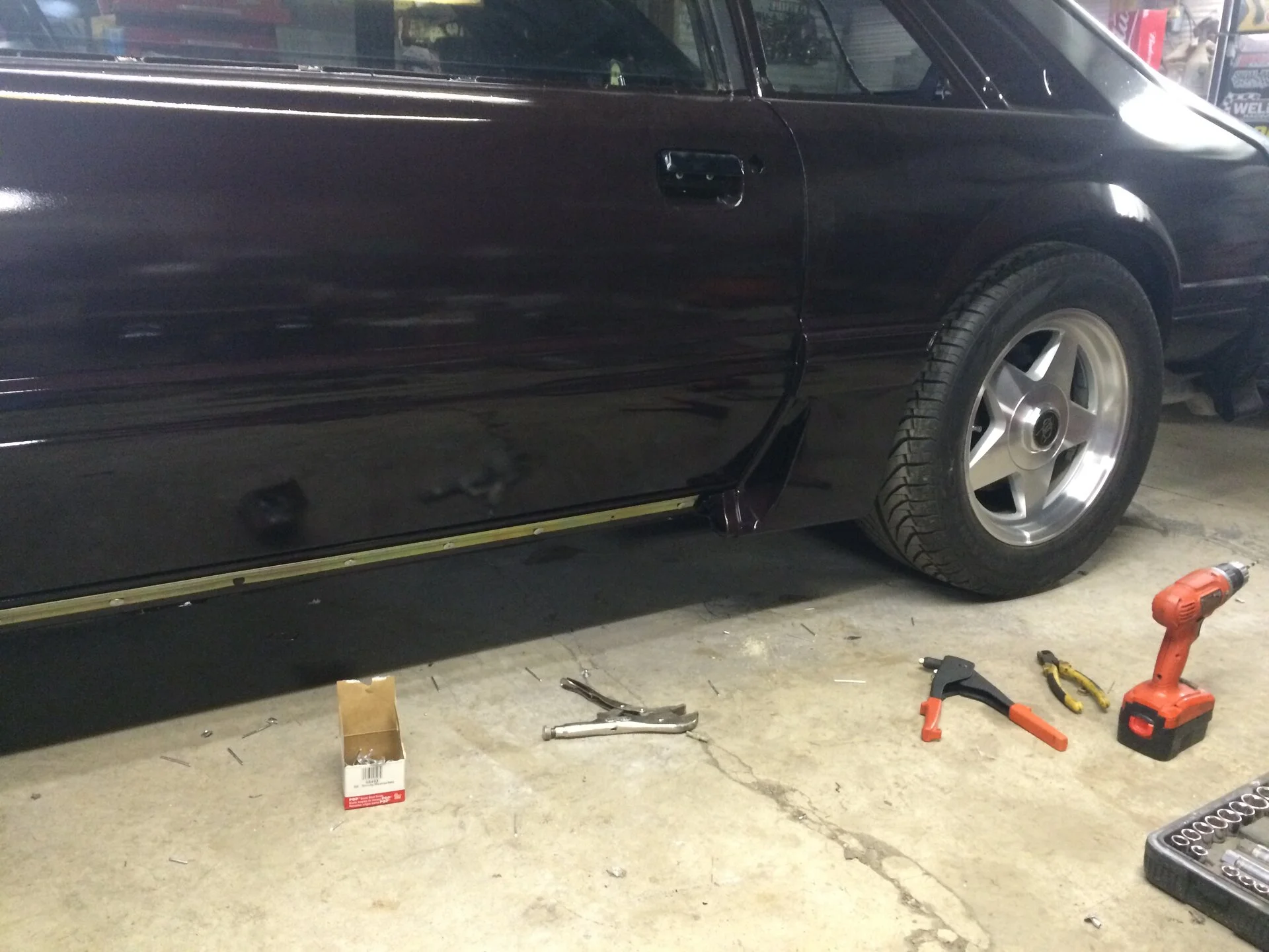

This was a pic while I was installing mine. Removal is reverse.
For the sides, start at the front fender. Undo any screws (could be up to 3 I believe - if they are still all installed). Then undo the screws or rivets along the bottom edge by the pinch weld underneath. Once that is done the upper part on the fender gets lifted up and forward at same time and rear section will pull forward off rear panel shown. Long narrow section clip is shown in pic.
For rear panel shown, should be similar to mentioned above, screws in wheel opening and underneath. Then lift up off the clip. May work better rocking it at front and rear.

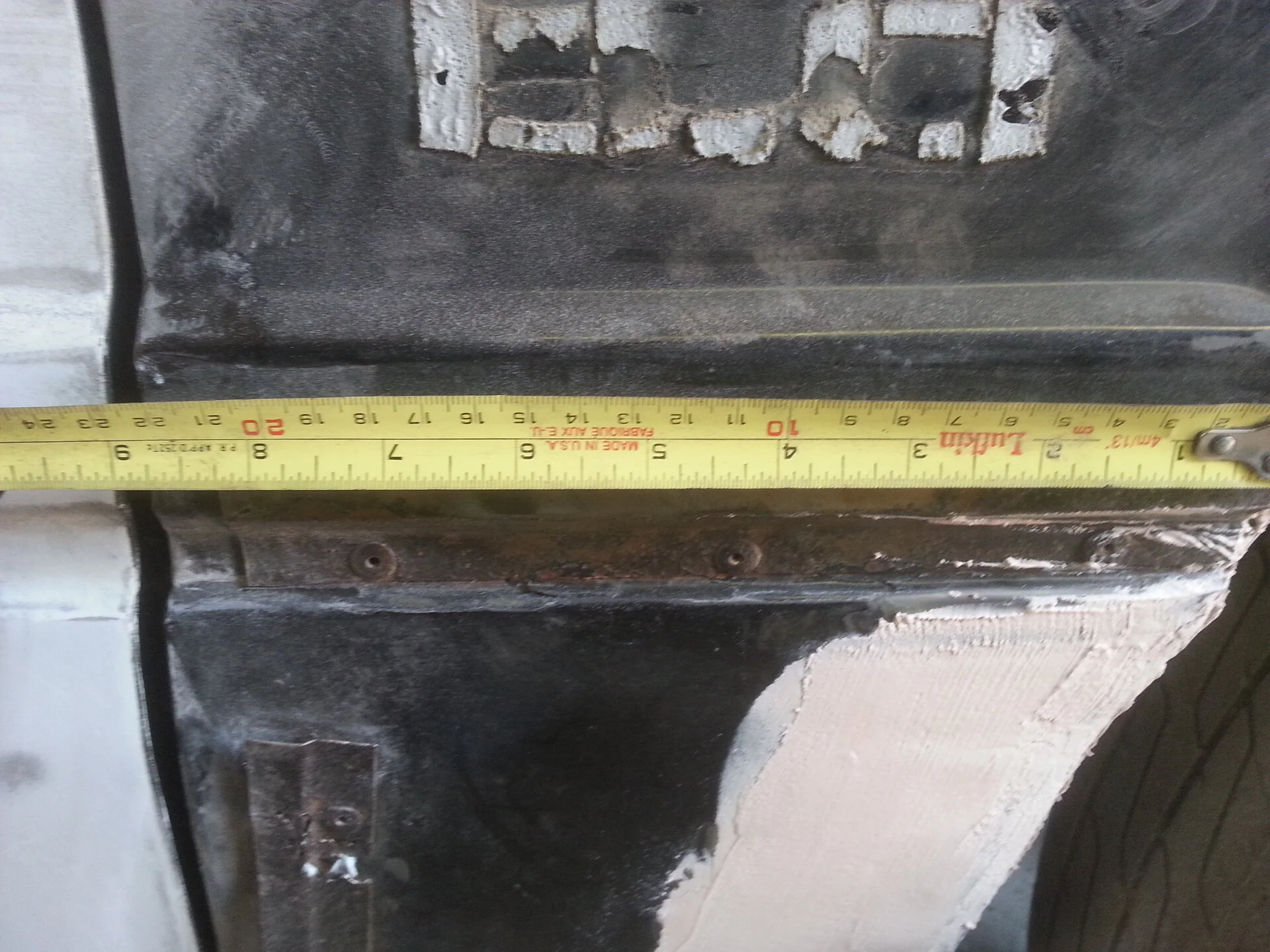

I found a couple other pics that may help.
This is passenger front fender, you will see the upper clip just below the tape measure and a vertical clip on the lower left of pic. These two along with screws in fender opening hold the front of the long panel in place.
This is a pic of the replacement clips. If needed they can be purchased individually or as a complete kit.
They are all the same profile - two on rear of front fender, long length under door (on rocker) and two for the rear section on quarter panel between door and wheel opening (my pic above). You can see the rivet holes and the formed section to the left is what plastic tabs on the panels "clip" into and holds them in place.

Oh thanks again. It's getting clearer now. Just to make sure: Do the trim pieces SLIDE onto these brackets or do they get 'stretched'/bent and popped onto the brackets?
Many thanks,
Ken
The trim panels have tabs that get pushed down into the clip. The clip flexes and then squeezes onto the tabs. From my experience the clips do not damage the tabs on the trim. Basically held in place by spring pressure created by the clips.
