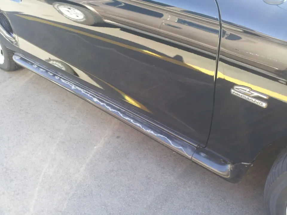

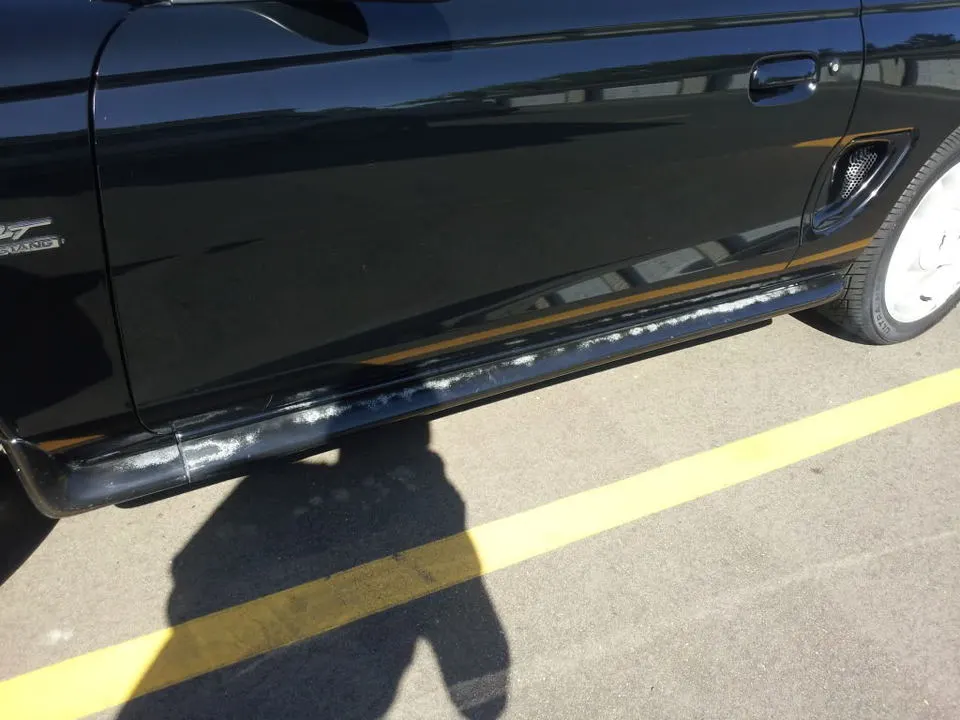

Just like the title says, I would like to get these sideskirts repainted. How hard are they to take off without breaking? I have talked to a few body places and have been quoted $300-$500 for the job and that is just me bringing the car to them in the state that it is in. Now I was thinking if I took them off that I would be able to save some money. And is there some prep work like sanding or something that I could do also?

Before removing them I would ensure that any special clips are available. You might ask the body shop if they plan on painting them in place or removing them to paint. That might explain the price difference in the quotes.

Take them off to have them painted. You are gonna break a few clips so get some ready so you can install them later.
Please, don't do any prep work on the skirts if you have never done body work first. I can't tell how many times someone with no experience has tried to make a paint job cheaper by doing their own work yet wound up making the car a ton worse. You might make the body shop have to redo half of what you did in order to make the parts paint ready.

I JUST had this done to my car. Looked identical to yours, black and all. That is WAAAAYYY too much money. First off they come off hard. You have to really be persuasive with them. I got mine painted 1 skirt painted for 100 bucks and it was done very well by a great company in town. I cannot see paying over 150 max for it. I just got my cobra bumper painted for 200 bucks.

Yea I'm definately going to leave the prep to the professionals because I want this to be done the right way.
