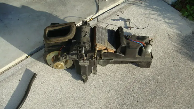

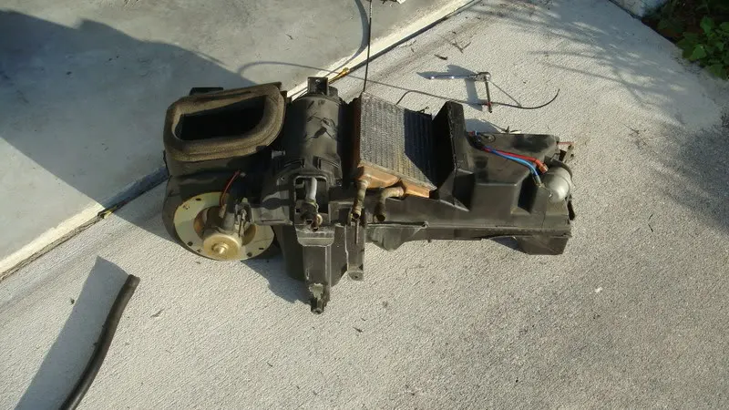

Thanks man, saw this thread and decided what the hell. I've been wanting to take the heater out for a while now but didn't feel like guessing my way through it. Took about 2 hours to get it out
Thanks a lot man, I'm sure you saved me an hour or two

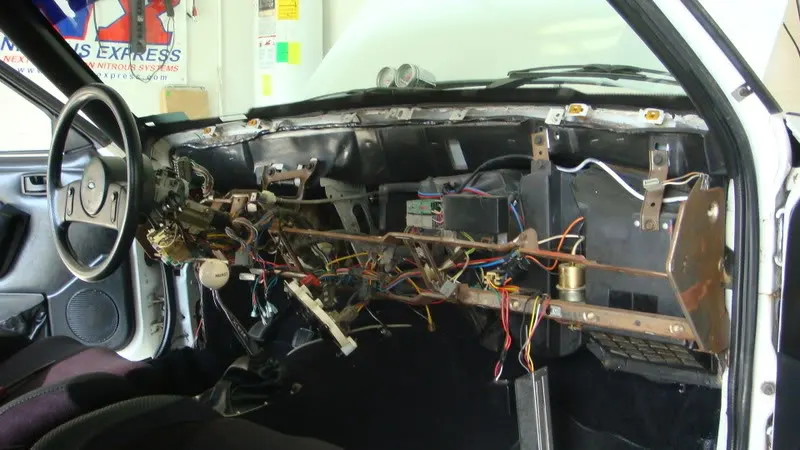

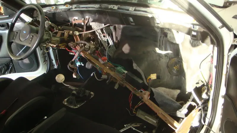

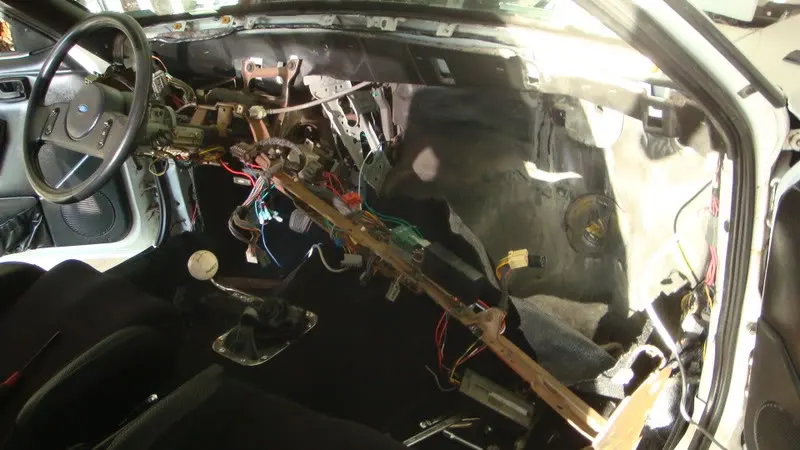

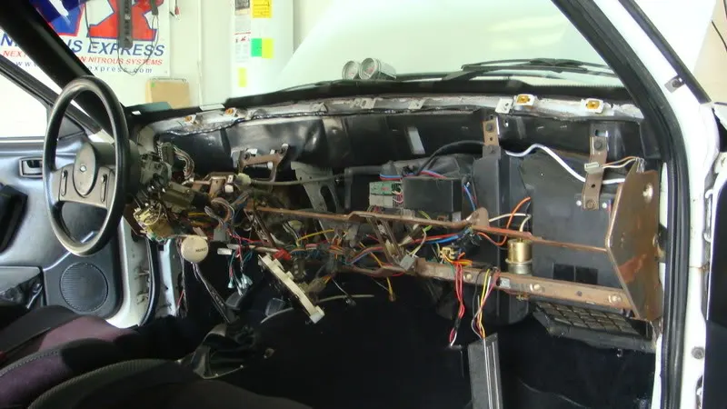

lmao, I was wanting to remove the unit altogether among other things which is why I pulled the entire dash, just so I could get a good look at everything back there. :)

There is no reason you need to remove the dash completely. I remove the center console, all necessary dash bolts and drop steering column. Pull the dash away from the firewall. Like a couple others have said, remove the two bolts that hold the whole heater core assembly on to the firewall and open it up. The bolts look like the one in the picture with the blue caps. The big long one under the caps. Then all you have to do is open it up.
With that said, it's still a PITA and takes a couple hours(beer breaks). This thread should definitely help.
